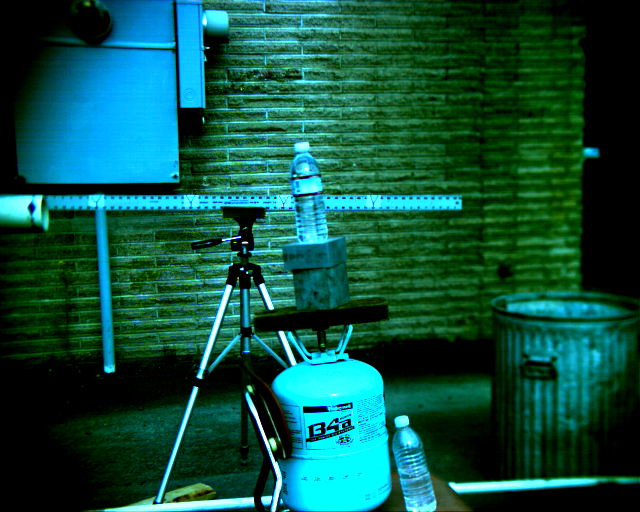

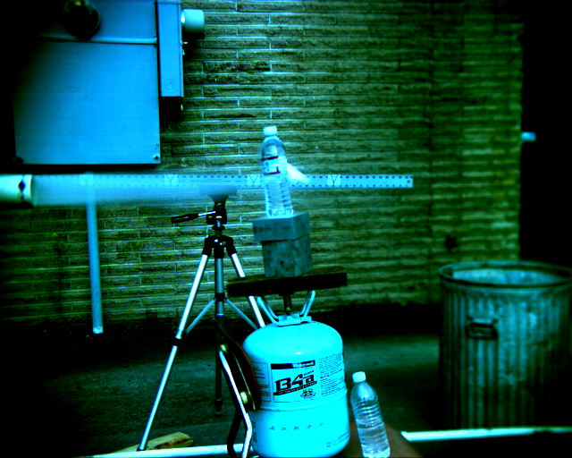

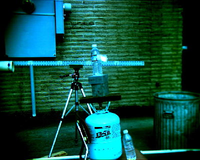

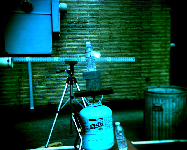

Good explanation. I think I have some photos to support that taken with a high speed video camera at 1,000 frames/second. Sorry the color is off. The borrowed camera was set for indoor and we shot outside. I brightened it up some with The Gimp.
Remember, each frame is only 0.001 seconds apart. How fast is the flow? This is an air cannon. Yes, it was loud.
Specs,
700 cubic inch chamber
~80 PSI
2 inch quick dump valve
2.5 inch barrel, 7 feet long.
Broken apple in barrel provides the applesauce mist.
Video speed 1,000 frames/sec.
metal measure in photo is 5 feet long with each foot marked in masking tape and magic marker.
Just how fast is that applesause traveling? :?:
The apple shows up Time +3 and initial impact is in frame +4.
This video was shot to confirm the valve speed. Full flow in under 2 ms.

Time + 2 ms.  Apple sauce has traveled almost 1.5 feet in 1 ms in the center of the flow.<br /><br />If I get a chance to re shoot this, I would like to dump a handful of packing peanuts in the barrel.
Time + 1 ms.  Label is loose.
Last frame of stillness.
