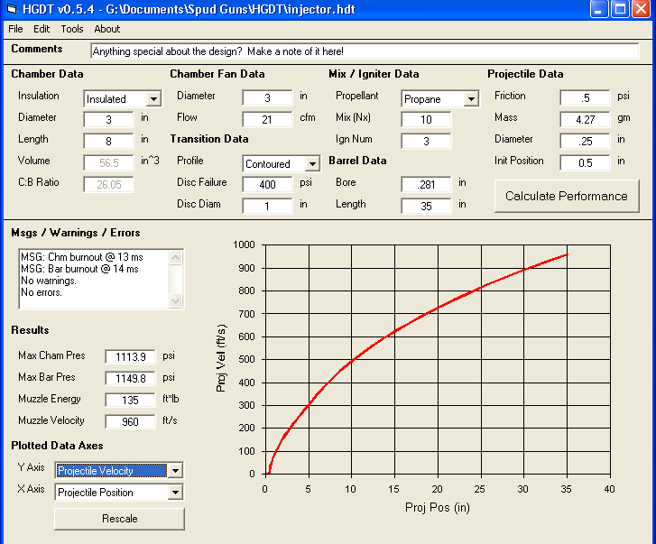

I will also try and add a picture of the HGDT simulation I created.

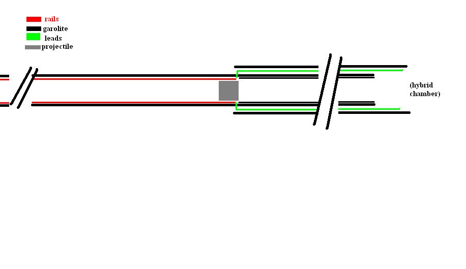

- Design.GIF (5.18 KiB) Viewed 6840 times
- HGDT_Injector.PNG (34.99 KiB) Viewed 6763 times

sch 80 3" has a working pressure of 768 psi.
my calculated burst pressure is 10,000psi
10x hybrid usually provides max 1,000psi.
Do you want to bump it to 20-35x with that fridge compressor? 35x means 3500psi max. A longer barrel would dramatically improve injector performance.

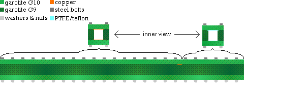

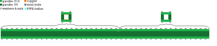

I think what I'll do is have the entire railgun be 7' long, 4' for the railgun and 3' for the injector. As per the HGDT sim, this should be able to accelerate it enough so that the railgun can bring it past the speed of sound. As for the cooling what I want to do is have the fridge compressor just pump air through a metal(probably copper) line that would have one coil in the liquid nitrogen(maybe even just dry ice) or above it, and one coil wrapped around the railgun and the hybrid chamber to avoid overheating the rails and burning myself. Here's an updated diagram.
- Design.PNG (5.52 KiB) Viewed 6781 times
don't bite off more than you can chew.... that is MASSIVE. What energy do you plan on using? If you go through with this, it will cost ALOT. I made a railgun enclosure out of G-11, 2' long and a 2"x1.5" cross section, and it cost 370$ (custom machined).
I do not think you are able to build this size.
The fact you wan't to use a injector. Big railgun's like this will be killed by a injector, a large SCR bank is byfar a better choice.
superconducting is a bad choice. You cannot just dump some copper in LN2 and expect it to be superconductive. You need special alloy's (costs ALOT). Also, just the friction and sparking alone will almost instantly bring the projectile to non-superconducting.
400v caps says nothing. I used 18 400v 3900uf capacitors for 5.6kJ. Even if you went with 20kj, the rail length only needs to be 1 foot long. The pulse time is SHORT, you need to run some proper LCR sims.
Past the speed of sound is easy. Mine comes very close with that power level, that size is like MACH 5, if you design it correctly.
EDIT: There is also the problem of material strength at that low temperatures. Powerlabs is misleading in lots of aspects, mainly the Inductor. He states that you must have a injector, but that is FALSE. Think about it. A railgun is practically a short. As soon as the projectile touches the rails, current flows. Most of the power will be gone before the projectile gets in the rails.

I think you guys are right I just went back through all the math and figured that I might go with a 3' or 2' gun for the cost.
But to further reduce the cost I might use electrical grade fiberglass, but anything that needs to be cut I can do at my school's shop, so no machining costs. A 6'x1/2"x3" piece of electrical grade fiberglass for Mcmaster-Carr is only $26. And it's red, that's a plus.
