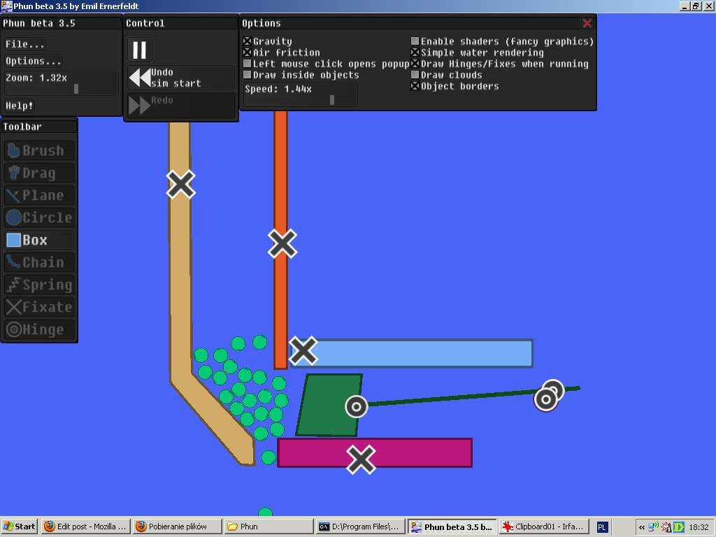

the hopper is sealed right ?? if so then possibly the tube doesn't offer enough fit and too much air enters the hopper... then it exits the same way it got in carrying bbs with it
EDIT
I tested the idea in Phun... while I couldn't reliably replicate what I wanted to test in the first place (as I couldn't simulate the effect that air has on bbs) I came up with this
a piston with a spring behind it would oscillate with each shot (as some air passes into the hopper.. here it's simulated with a basic motor)
I don't know how accurate phun is but I simulated several different configs of a simple hopper and BBs did jam
