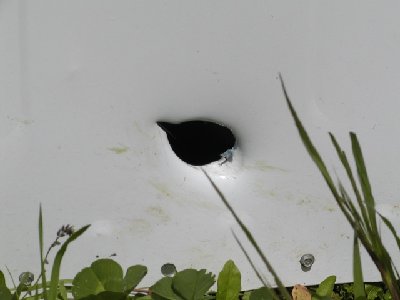

Edit, I had the time to do this year's pressure test. Results are below. Click on the photos to enlarge. The cannon pipe label is clearly shown. It is ABS Cellular Core DWV.
Damage caused by the ABS Cellular Core Test cannon, now 8 years old.

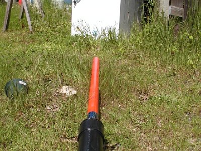

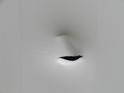

We have an old appliance to recycle.  A paper shop towel on a 2 inch piece of 1 inch EMT is launched into the base.  The blue fluff is a shop towel in the hole.

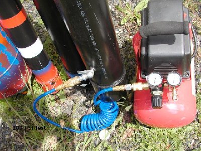

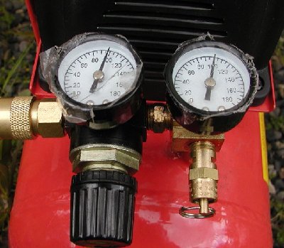

Compressor cycled between 85 and 100 PSI during the test as the cannon piston still leaks a tiny bit.<br /><br />This is very clearly marked ABS Cellular Core DWV

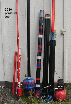

My 3 QDV cannons.  Newest is on the left, oldest is on the right.  One on the right is getting a 30 minute pressure test. <br />The metal 2 inch QDV launcher is shown with 3 ABS barrels, a 2 inch, 3 inch and 4 inch.  ABS makes great barrels. They are lightweight.

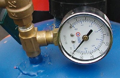

Gauge Detail
Gauge Detail

Just for grins I dropped in a D cell battery, bled the pressure to 80 PSI and shot it with no wadding.  Even with lots of blow-by, it almost went through the back of the appliance.
T shirt cannon test at 100 PSI.  2 inch ABS Cellular Core barrel is attached.
