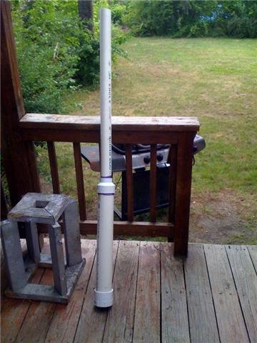

Hey guys I'm new here. I made my first spud gun yesturday. It has a 3"x24" chamber and a 2"x36" barrel. Both have 226 cubic inches of volume if my math is correct. I shot it using a russet potatoe and 6 seconds of aquanet, but it only went about 20 yards. It fired first time I hit the grill igniter so I don't believe it's rich. Should I go for more spray or cut the barrel shorter?

Seriously, just try different fuel ratios. Six seconds sounds like too much, if it fired the first time that means it is rich.

Six seconds is way too much. Start off with about a half a second and go up from there until you get good, consistent performance.

I was shooting it tonight. anymore than 7 seconds of spray makes it too rich, but it still won't go further than 90'. I'll try a ecu fan but this is discouraging it makes plenty of noise but no go.

The spud has to fit as nice as possible, the more gaps the worse performance you will have. Try some wadding to fill in any gaps. Also try different ammo, Nerf footballs, squishy balls, anything that fits snugly.
Also experiment with different fuels, "aqua-net" may have went by way of "Right Guard" thus not much good for spudding. I've heard that "Static Guard" still works well. "Propane", 2 seconds worth dumped (propane sinks it's heavier then air) into the chamber should give you great power.
Less is sometimes more, like the others said above. At one point in time your fuel mixture will be at it's strongest. Start at one second then two etc...

1. You have too much fuel. A rich mixture burns very slowly and trashes the gun's performance. (It also lowers the combustion energy but that is less of a problem than is the slowly burn speed.)
2. The fuel is poorly mixed. This also trashes performance. A chamber fan will fix this problem. To test if a fan will help without actually installing a fan, try fueling then waiting a minute or two before firing, slowly invert the gun a few times to help mix the fuel. If the performance goes up then mixing is a problem. (Gases mix surprisingly slowly.)
3. The spud should make a tight, basically an air tight fit, with the barrel. This is easily done if you sharpen the muzzle of the gun. You then shove an over sized spud into the barrel and the sharpened muzzle will slice the spud to the exact size of the barrel and give an airtight fit. A small amount of bevel on the inside of the muzzle will give a slightly over sized spud with a lot of friction. Surprisingly, the extra friction actually helps performance. (I usually suggest a first time spudder make a gun with a 1.5" barrel since spuds big enough for a 2" barrel are hard to find and kind of expensive. With the smaller diameter barrel all kinds of veggies can be used, apple, cucumbers...)
Your gun should be able to launch a half-spud at least 300 feet.
I use half spuds cause you get twice as many shots per spud. Slice the spud in half perpendicular to its long axis to give a "bullet" like shape with a roundish end and a flat end. To load, shove the nice flat end into the barrel first and your muzzle spud cutter will slice it perfectly to size. With a perfectly sharpened muzzle knife it'll take a lot of force to ram the spud home, perhaps as much as 50 pounds of force. Make sure the breech is open when ramming to (1) prevent accidental firing (never ram a fueled gun) and (2) to allow the air you are displacing from the barrel to escape through the breech. Once rammed home you can add fuel.

Im thinking about trying some propane. Should it be about the same amount 3 seconds or so? Heres a pic of it if it loaded right.
