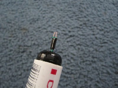

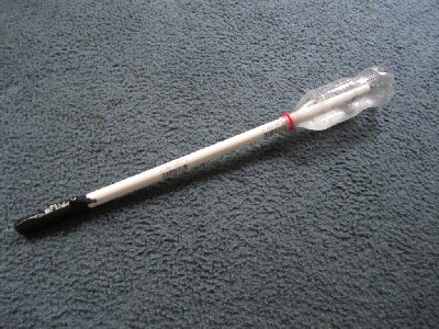

Took me all of a few minutes to build and $0. Best part is, it's portable, and no air pump/compressor required at all. All you need is water and plastic bottles.
Ignition is accomplished with an Aim n' Flame piezo, with the wires run through a scrader valve with core removed press fit into the top of the 1/2" pipe with a little electrical tape to seal the wires and improve fit.
To be honest, I didn't even know if this was going to work, as static friction held my little pneumatic's bottle chamber on without set screws at up to 50 PSI, although that was with an o-ring.
Another thing is that this design doesn't require o-rings or any other way to seal the bottle onto the pipe, other than the close fit, since the internals are at atmospheric pressure before launching.
Anyway, enough talking, on to the pictures and video.

I know I should add some fins. Guess it's not really a "rocket" so much as a "runaway engine". Done a few tests just using the combustion gases as the reaction mass, with varying "nozzle" sizes (see my avatar), with predictably dismal results of no more than several feet. You really need something with more mass coming out of the "nozzle" for significant thrust.Lockednloaded wrote:Very cool! Have you done test w/ and w/out water? You should also add some stabilizing fins
It's a piece of 1/2" PVC pipe with an end plugged off with two electrodes. Really not much to explain...warhead052 wrote:Can we get a how to?

Without water it would be quite silly, because the extra mass being propelled out the nozzle increases thrust tremendously (conservation of momentum, I think).

- First Sergeant 4
- Posts: 2606
He doesn't. The electrodes clear the water and ignite the flammable gas mixture above the water.warhead052 wrote:Mark, I admit that kinda was a stupid question, but how do you get it to spark underwater?

I've heard of that done before, but never tried it. Would probably work, but I'd like to keep the "launch tube" flexible, so it can launch more than one size of bottle, and I can experiment with different spark placements. When the pipe is inserted, water doesn't leak through the neck at all. For some of the video I took tonight, I fueled up the bottle, inserted the tube, and left it sitting for some time while I set up the camera.warhead052 wrote:Want to know of a way to make that air tight? Stick your pvc about 1 inch off the bottom of the bottle, mark it, then heat it up and push it together to make a little bulb. It works perfectly and holds up to 140, (thats what I have been able to test it at...)

What I mean is that, if I were to place the "bulb" at the neck of the 20 oz. bottle to where the spark gap was at the very top of the rocket, if I switched to a 2L bottle, the spark would be lower. I'd also like to see if there's any difference between a centrally located spark and a spark at either extreme end of the "combustion chamber".

Interesting concept, I would have thought the water would have absorbed enough heat from the combustion to make it weak compared to a pneumatic water rocket. On the other hand, you could be generating steam which helps with propulsion

There probably isn't enough time for sufficient heat loss to happen, given the relatively small powered flight time of a water rocket.jackssmirkingrevenge wrote:Just after firing, are you shaking your hand dry or did it hurt you?
