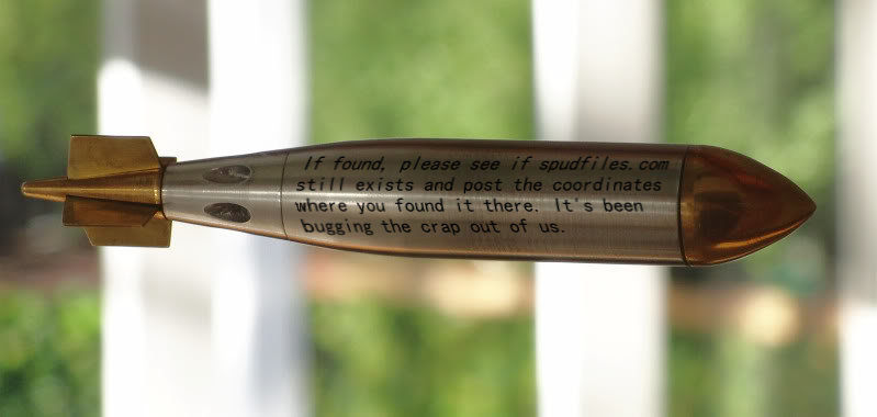

I think there is a more elegant solution to projectile recovery.
Gun Freak
Lieutenant 5
Lieutenant 5
Posts: 4971
Sun Oct 02, 2011 6:20 pm
That's actually a good idea :lol:

Fnord wrote:I think there is a more elegant solution to projectile recovery.
Haha I like it :D
Similar ideas had been discussed but we never got as far as writing on a .jpg image :P
On another note, what about making a solenoid inside the projectile and trying to pick up the location via interference? Considering the solenoid would be quite small, inside a metal casing and buried several feet under sand I highly doubt this idea is even remotely feasible .

Image That should do the trick! Pick up the frequency on a handheld radio and there it is. 8)
