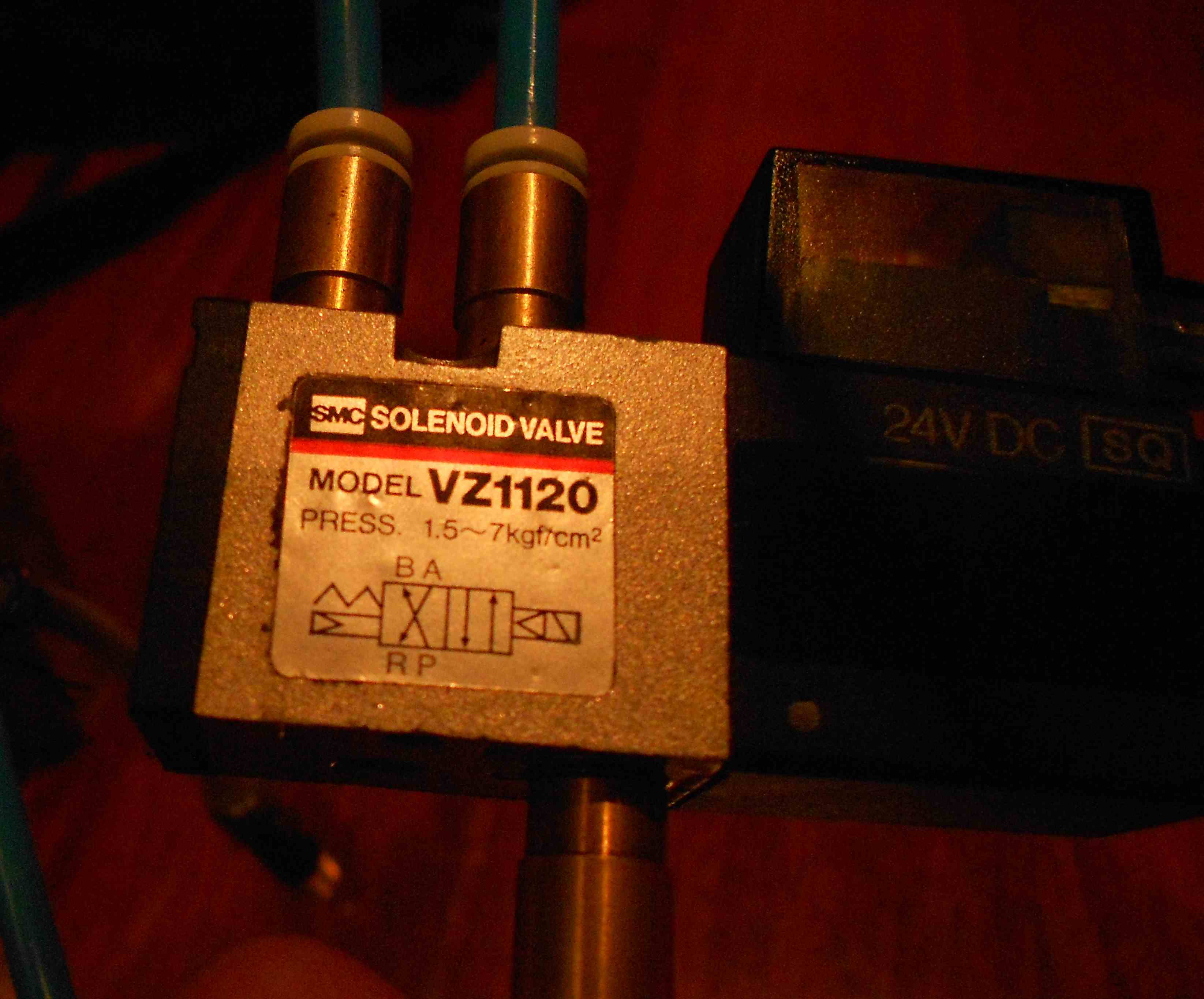

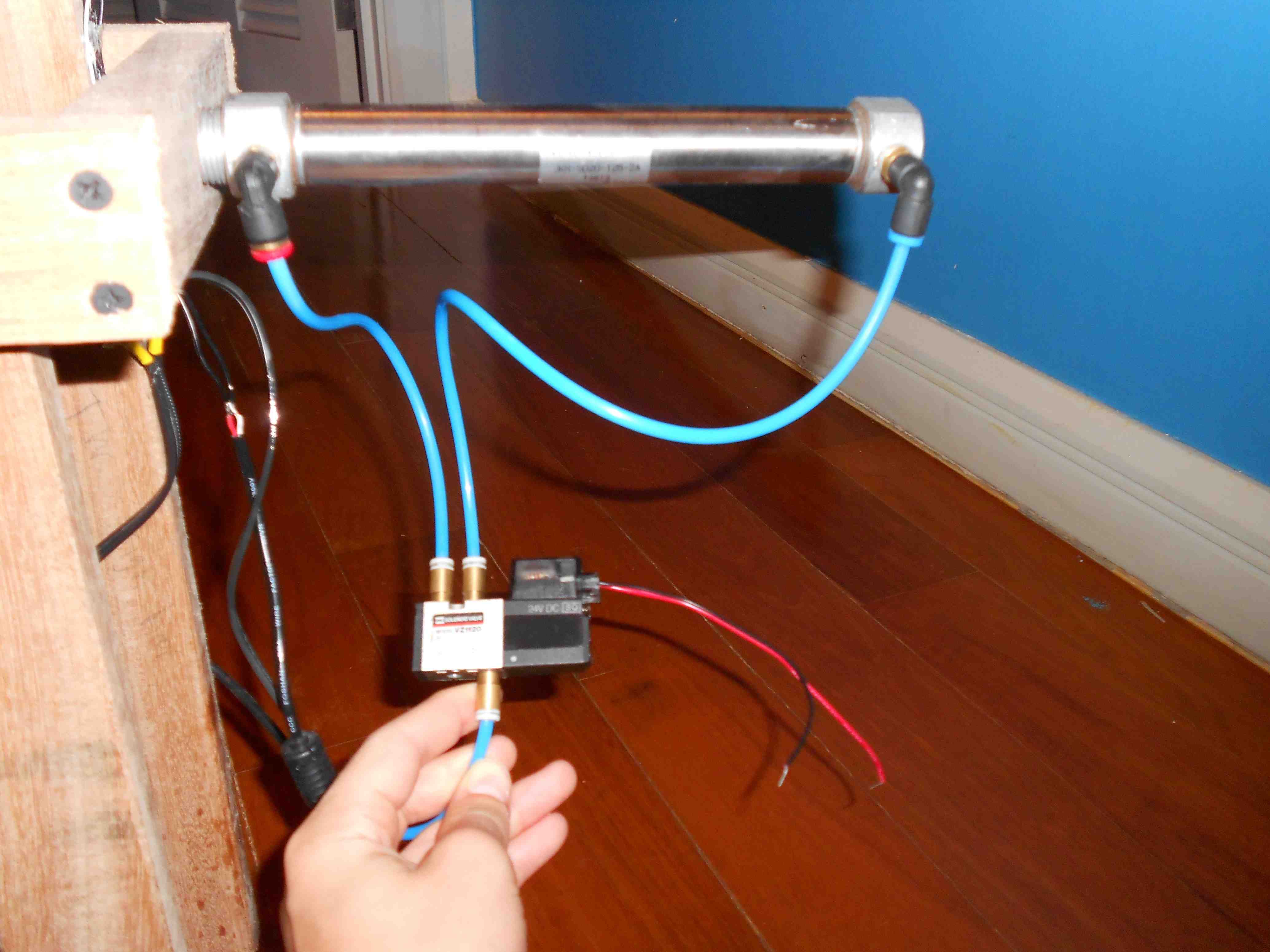

I recently purchased a 4 way, indirect acting valve for a school project (reason iv'e been so inactive lately) I hooked it up to my piston and triggered it with a 24v power supply(pressurized to 60psi). It essentially works but in the second position, It leaks out of the R/exhaust port. Does anybody know what the problem is? It could be a defective valve since I bought it in chinatown though I hope thats not the case...
Here it is:
Here it is:

No, it is a 4/2 valve. And when I said It leaks out of the exhaust port, I meant it leaks even when the double acting cylinder is fully extended. I tried pinching the line of the cylinder (once extended) to check if maybe the inside seal was the problem but it didn't affect the leak at all implying that the valve is defiantly the problem.

you know what? a better pic of the valve and a pic of the whole setup could help

as you wisha better pic of the valve and a pic of the whole setup could help

thx so now I know that everything is connected the way it shouldas you wish
