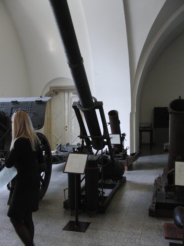

Having had the opportunity to look at surviving examples of the 12 cm Luftminenwerfer M.16 and 20 cm Luftminenwerfer System Bartlmus preserved at the Heeresgeschichtliches Museum close up, I thought I would share some photos. Not my best effort, flash photography was not allowed.

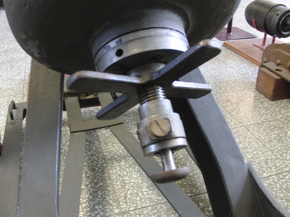

Unfortunately I was unable to get any details of the clutch, but the function can be easily imagined as a quick-release mechanism which releases the projectile when pulled.

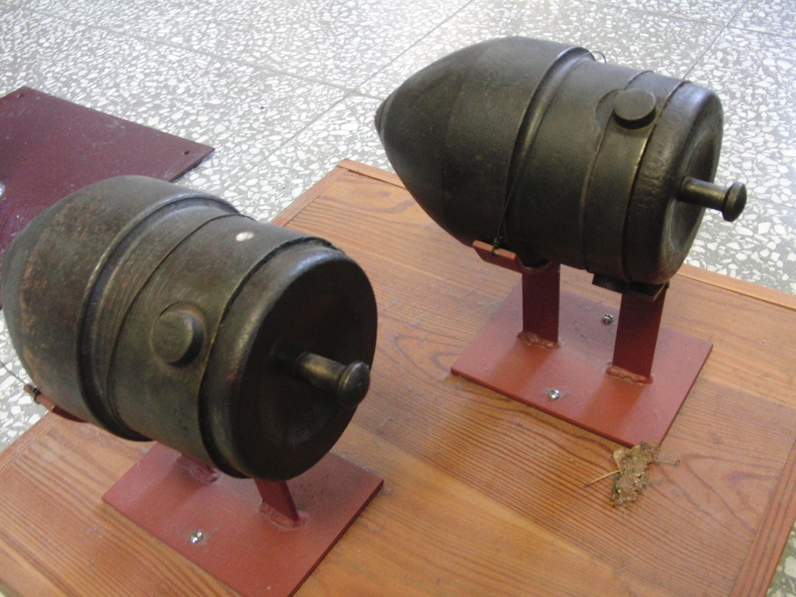

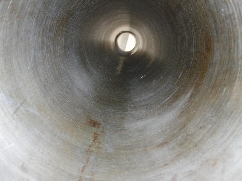

One thing I don't understand is how the projectiles are stabilised. Having seen the studs on the projectiles, my initial idea was that they engaged rifling in the barrel in a manner similar to the La Hitte system, but in actual fact the barrels are smoothbores, and the studs do not project beyond the major diameter of the projectiles.
Looking at a cross section, the CG and CP are about central, so it doesn't appear that it would be drag stabilised.
The most plausible answer to me is that the place where the projectile sits actually contains a short rifled section. Even thought it's only over half the length of the projectile, this could provide enough spin to stabilise the relatively short projectile in flight. The 20cm model had its breech open but a projectile was in place and I was unable to confirm this. Any other theories welcome :)

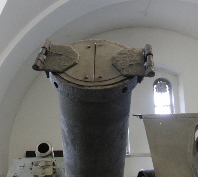

One other interesting thing is that the 12cm model has a spring loaded shutter at the muzzle. The springs look fairly weak so I imagine this was mostly to keep debris out when not in use, but it could also have had a limited suppressing effect.

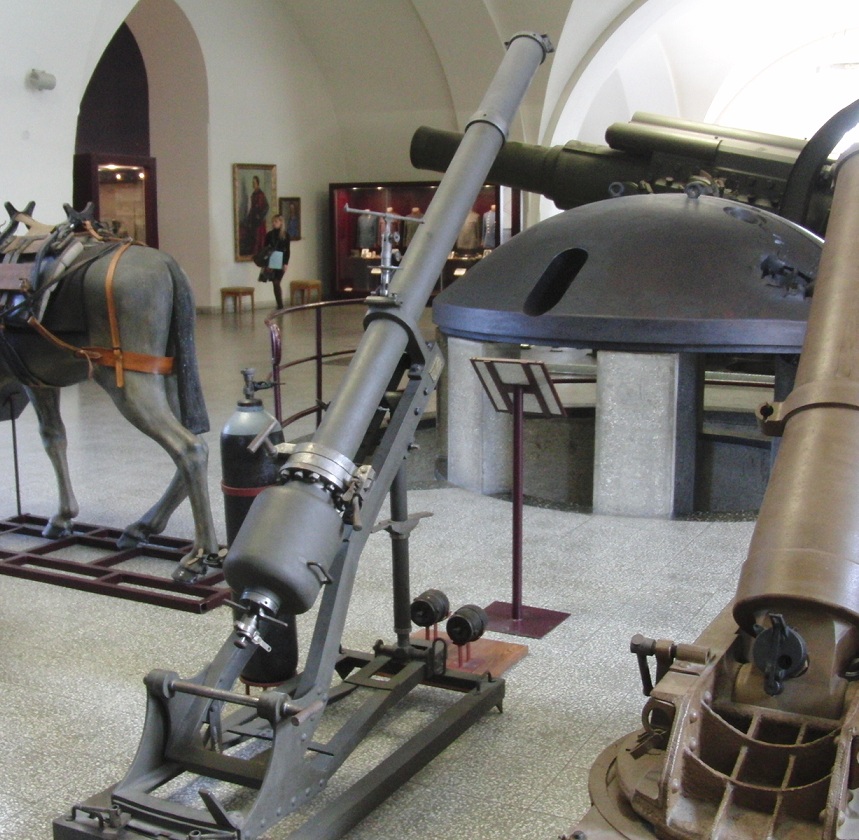

12cm in action
12cm in action

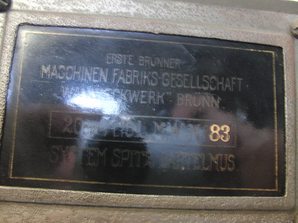

20cm manufacturer's plate
20cm view up the barrel
20cm projectile
20cm projectile
20cm reloading rack and pinion.  Elevation was fixed with range being varied by altering pressure.
20cm clutch detail
20cm clutch detail

12cm projectiles
12cm projectiles
12cm cylinder connection
12cm breech connection detail
12cm clutch detail, the central pin is pulled to fire
12cm muzzle shutter
12cm muzzle shutter
12cm rear view
12cm rear view
12cm rear view
12cm rear view
The display including the 12cm mortar in the foreground and 20cm mortar in the background

Question: what´s the pressure they used? pretty high I guess.
How does the firing mechanism work?
Also the muzzle shutter is open before shot right? Or does the air/projectile force it to open when fired?(witch reminds me, did your shut off suppressor ever worked?)

It would be a hinged claw that held the flared end of the pin then opened when the firing knob was pulled back.
At a guess, imagine a clothes peg.
The jaws will not open if you block the opening levers from closing.
Remove the block and the jaws will open.
The screw part at the rear I imagine would be to loosen and tighten the grasp on the pin of the projectile. Possibly requires resetting after each shot.
As for the studs...
Could be we are not seeing the projectile as they were and the studs were to hold a material which would have helped sealing.
Alternatively the seal may have been generated by the force of the "clutch" pulling the projectile onto a sealing material within the mortar.
If it's to engage a rifled section its an incredibly short one since the studs don't seem to protrude past the diameter of the shell.
see the basic attached diagram, the clutch holds the pin at the base of the projectile, at the moment of firing the clutch releases the pin and bang!
It seems the force of the shot opened it.

Interesting. I may have to take notes now... How did the clutch work? Was it pretty much a jaw that was released when you wanted to fire?

warhead052 wrote:Interesting. I may have to take notes now... How did the clutch work? Was it pretty much a jaw that was released when you wanted to fire?
I imagine so, have a look at other quick release mechanisms:
Essentially my ballistic knives use exactly the same principle - a projectile held in the barrel by a mechanical catch, and is released to fire.

I've seen those before, industrial quick release for cables right?

I'm fascinated most though by what I imagine to be the rifling system. Only having to rifle a tiny part of the breech would be infinitely easier than having to rifle an entire barrel...

But fire arms were very available already in the early 20th century...
Well some FX airguns are only rifled in the end of the barrel, giving the pellet a initial space to accelerate, then in the end, give it the spin.~
