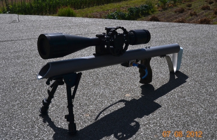

So, I decided to build a airsoft sniper rifle, my objective it´s to see how accurate a airsoft bb can be.
I used a 1/4 3-way valve to pilot a 1/4 QEV, the exhaust port of the 3-way is suppressed. But I´m not going to make it semi-auto, instead I will use bolt-action plus magazine for reloading.
The gun isn´t finished yet, I still haven´t decided the barrel/bolt configuration.
Video made at 5 bar, I tested 10 bar after the video, the QEV really rocks off the ground
