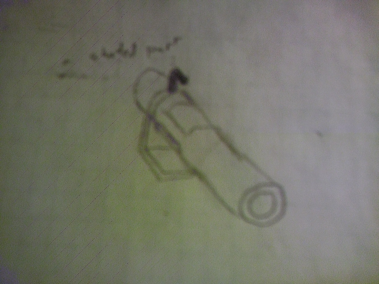

So, here's a few things I've messed with, and some I've gotten to work. Please excuse the picture quality, my good camera is busted and the scanner doesn't pick up pencil well. It's conceptual anyways. What if you made a gas blowback, just like a semi-automatic rifle?
This is technically like a 6 stage shell carrier system, but it's really simple. The slide is a pipe a little larger than the barrel with square slits so that a shell can slide all the way through. It's gravity fed, so there's no springs or plungers involved. Without a gas blowback, this system would work like a bolt action rifle. It's easy to build and manipulate. It's simple. And it works, cause me and a few others have made stuff very similar.
How bout gas blow back?
The basics of this; the gas tube is in-line with the barrel. When the gun fires, combustion or what-not, the potato goes from a shell to the barrel. At a certain point in the barrel, the potato will pass a small hole with a latch. Gas will blow the latch out, and the entire system will cycle under the pressure. At the back of the cycle, a new shell falls into place on top of the used one. A spring pushed the action forward, closing off the new shell.
The "repriming" part takes some imagination, whether it be a pneumatic valve or a timed spray or a propane release... just attache it somewhere to the action. As to how you make this sort of thing, I'm good with welding and some machining, so my stuff is usually metal. A friend of mine did something like this using boards and plywood, cause he's good at making cabinets.
I think what your trying to do sounds fly as ****. If I had to guess, you don't want to throw money at this thing. It sounds like you're innovative and ambitious, so please don't let the challenge wear you down. I can get you better explanations of how some of this stuff was done if you'd like, such as the gas block. We made one using male fittings, simple as that. No machining or rubber gaskets n such.
