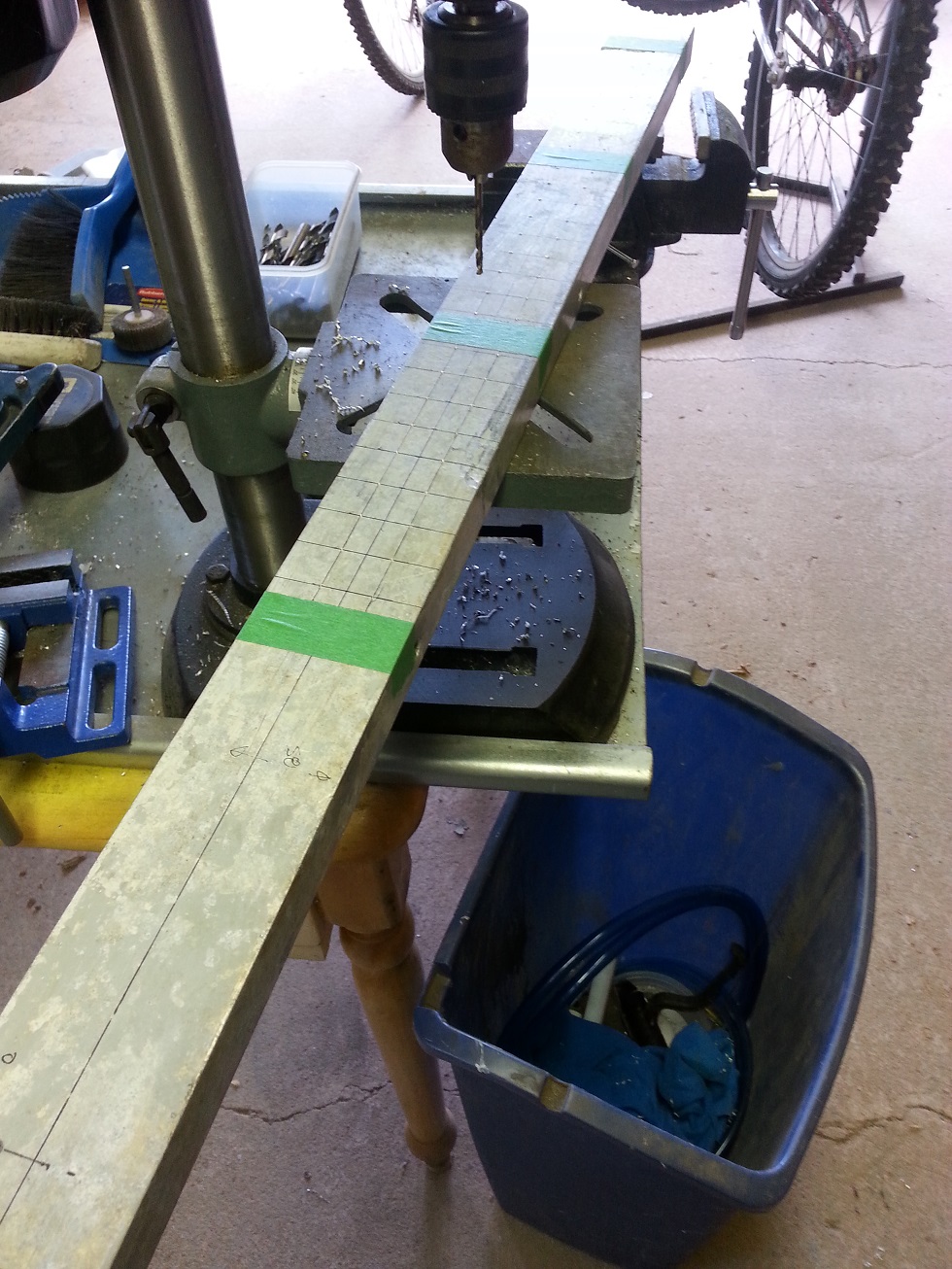

Started to work on the main piece, it's 2 1/4" x 1" aluminium channel, a bit rough in places but should work ok.
Many holes to drill

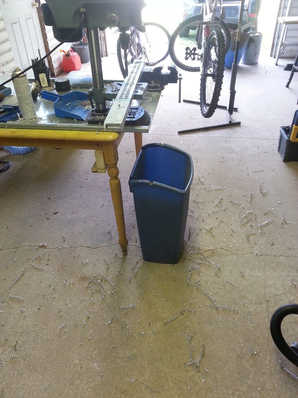

Was a bit messy
But turned out nice

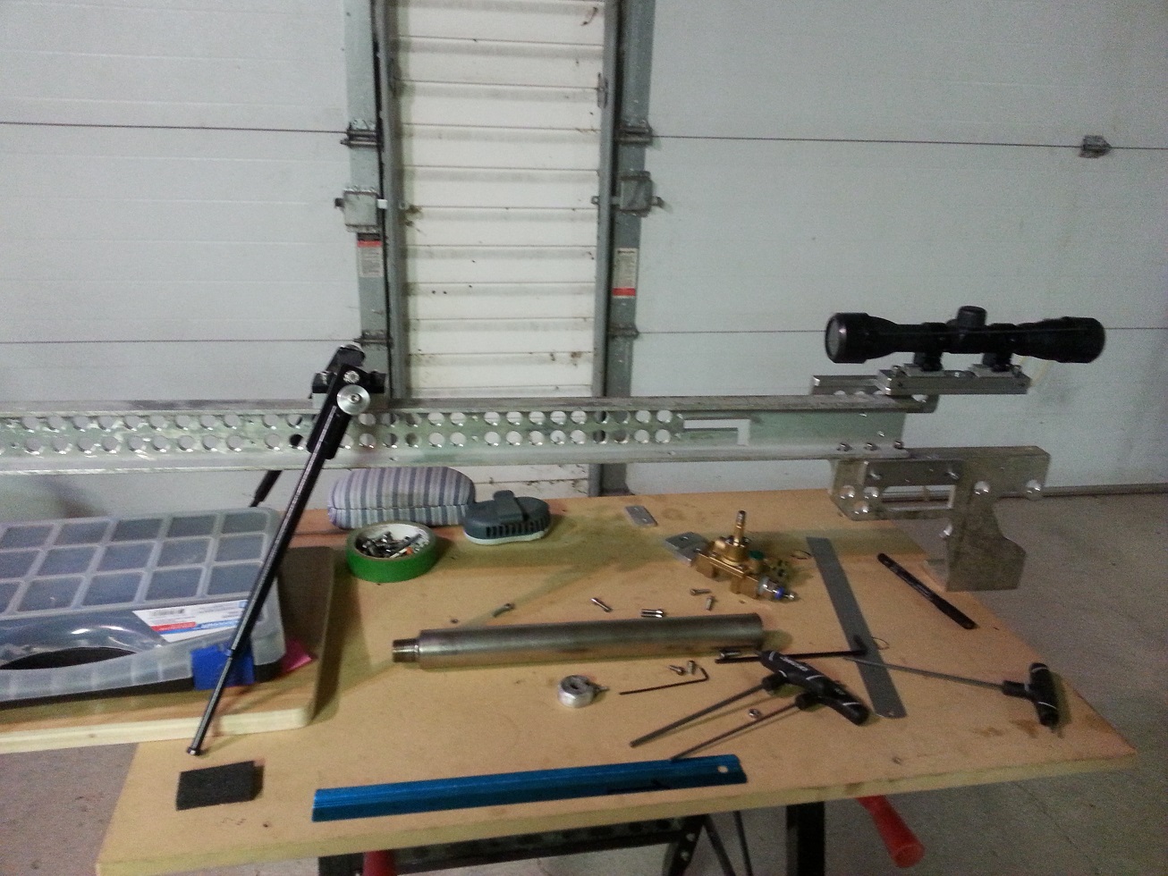

Fitted a few parts together for a preview

Sun Aug 12, 2018 5:08 pm
It looks long. Is it repetition?

Sun Aug 12, 2018 5:32 pm
Just a single shot, the barrel tube is 900mm long at the moment, that's how it came, I will cut it down to about 750mm.

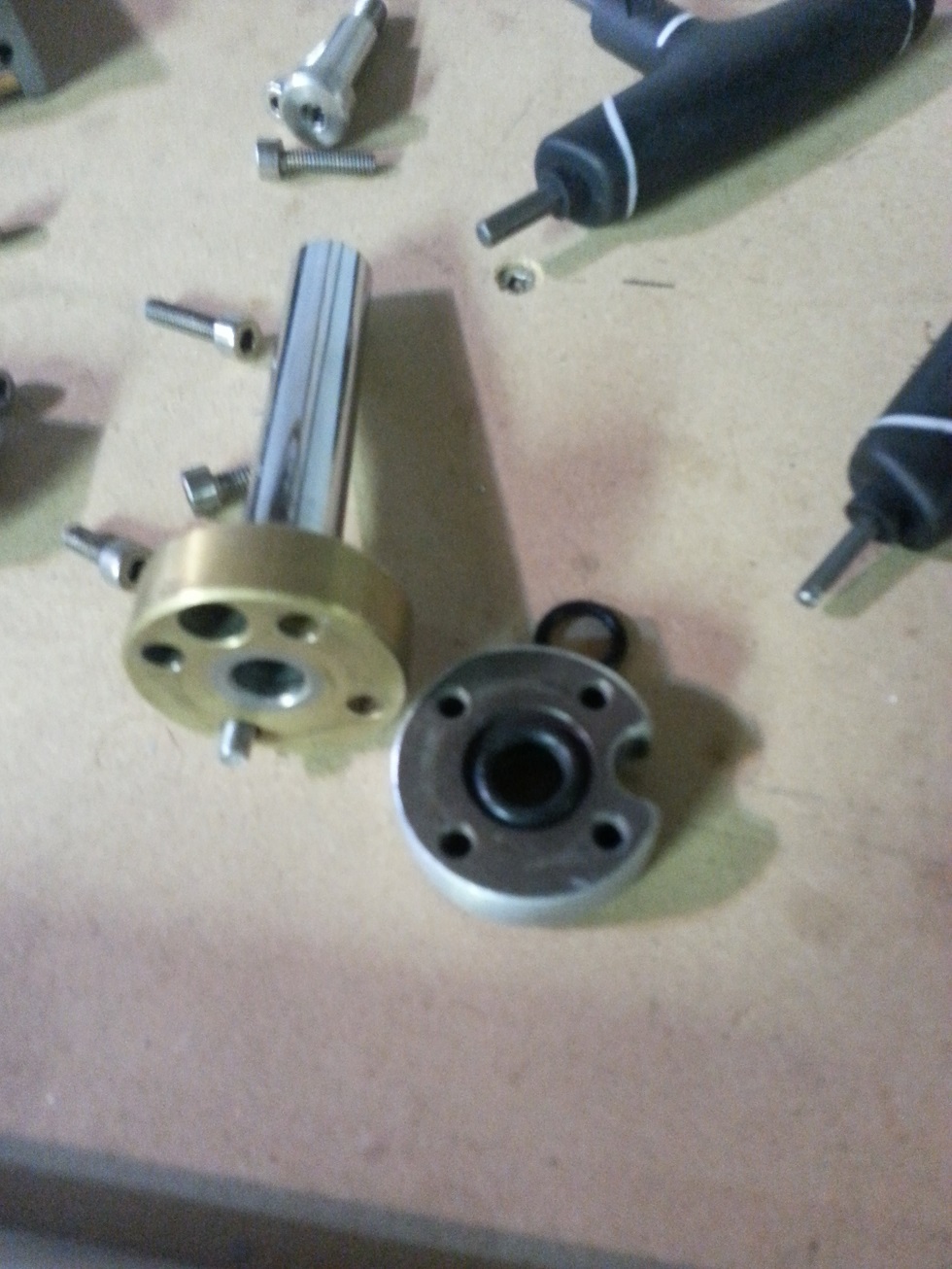

O ring seal on the breech tube.

wyz2285
Austria
Posts: 2388
Location: Porto, Portugal
Sat Aug 18, 2018 7:17 pm
That's a push to connect fitting at the barrel attachment if I'm not mistaken, which means if you press the blue plastic ring the barrel will come off? Even if the barrel is locked somewhere else that's not a perfect spot for the o-ring to seal against but probably won't leak much.
