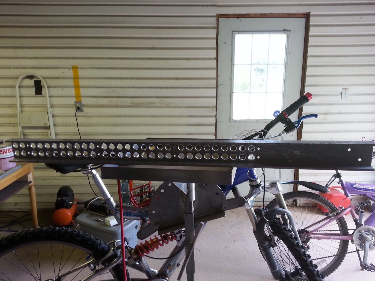

Started to work on the main piece, it's 2 1/4" x 1" aluminium channel, a bit rough in places but should work ok.

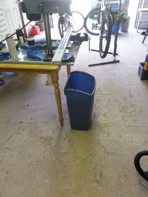

Many holes to drill Was a bit messy But turned out nice

lol no, just drilling holes for the sake of drilling holes.

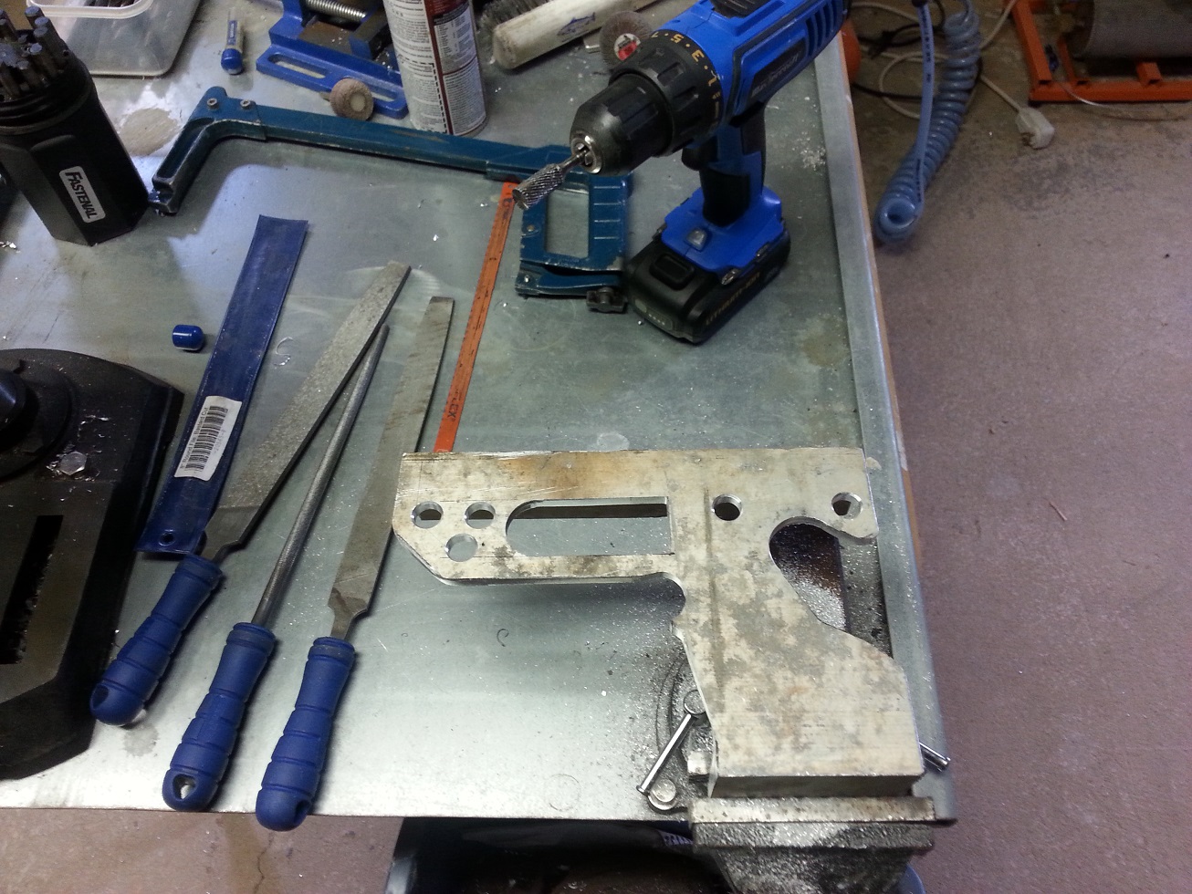

A couple of hours work with the hand tools
