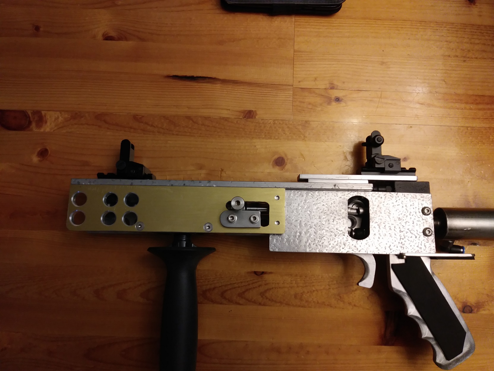

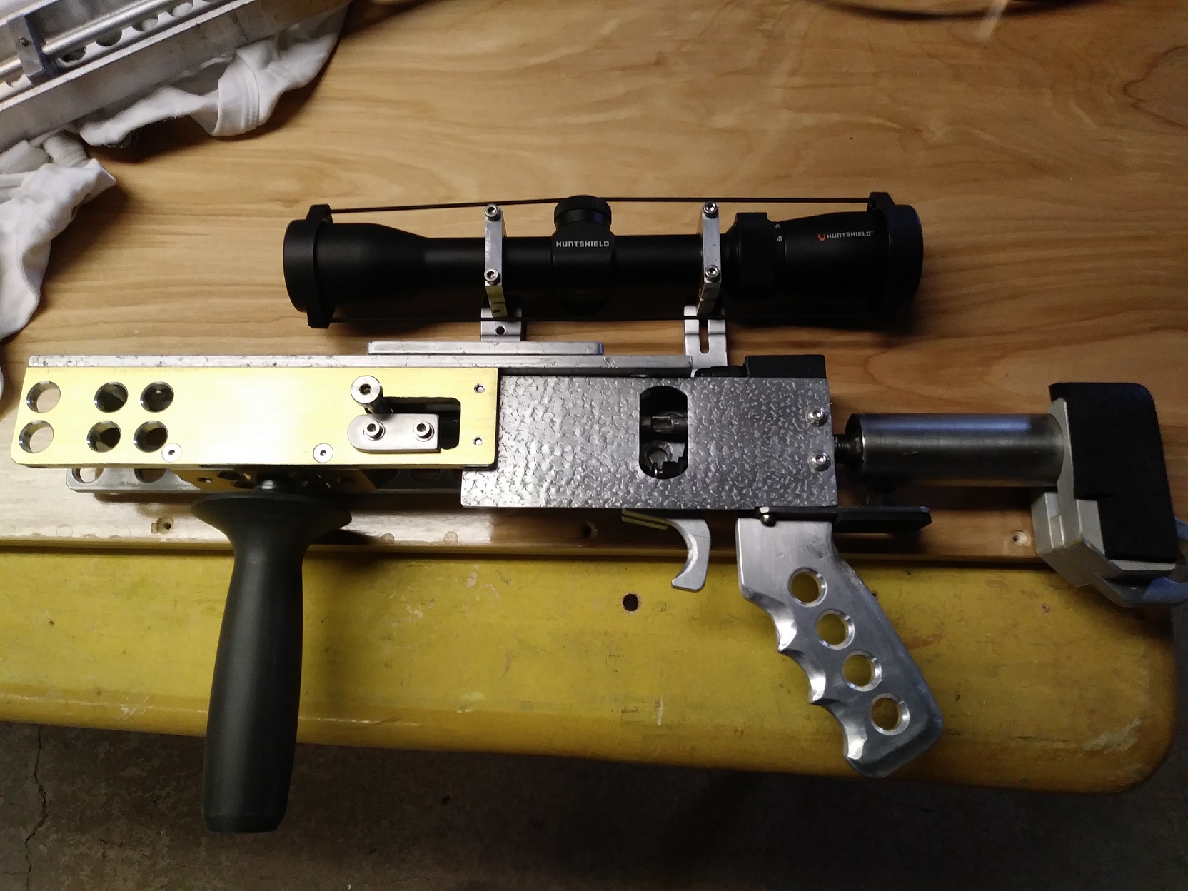

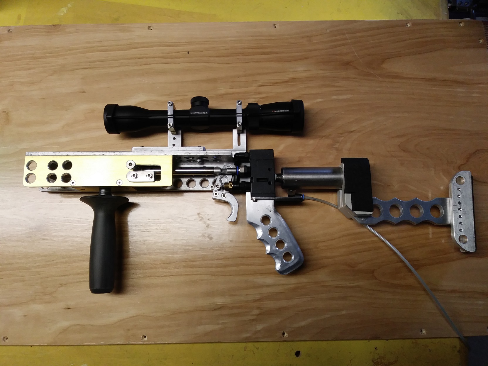

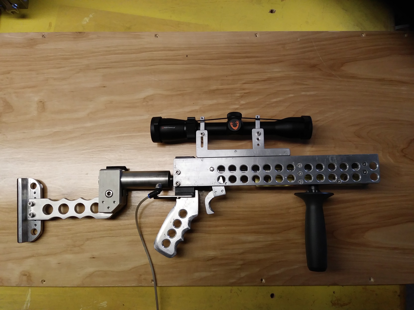

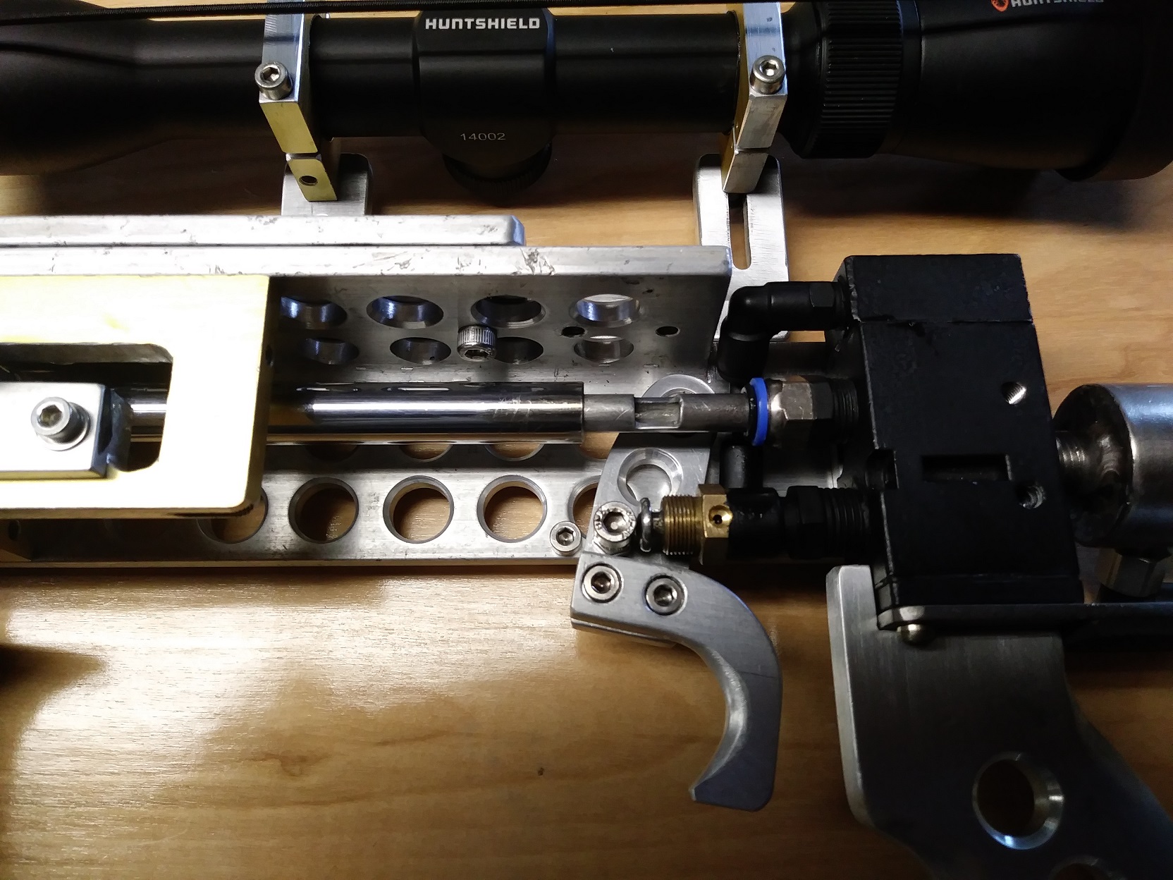

Finished the compact .177, barrel is 12" long. 11" if you allow for the dead space, valve is 1/4" pilot operated, accuracy as expected, about 1 1/2" group at 9m. Running straight off compressed air as usual at about 150psi. One of my favoritist guns to shoot so far :D

Looks nice! Linking to the other thread here for some more information. :D
Mon Oct 08, 2018 1:45 pm

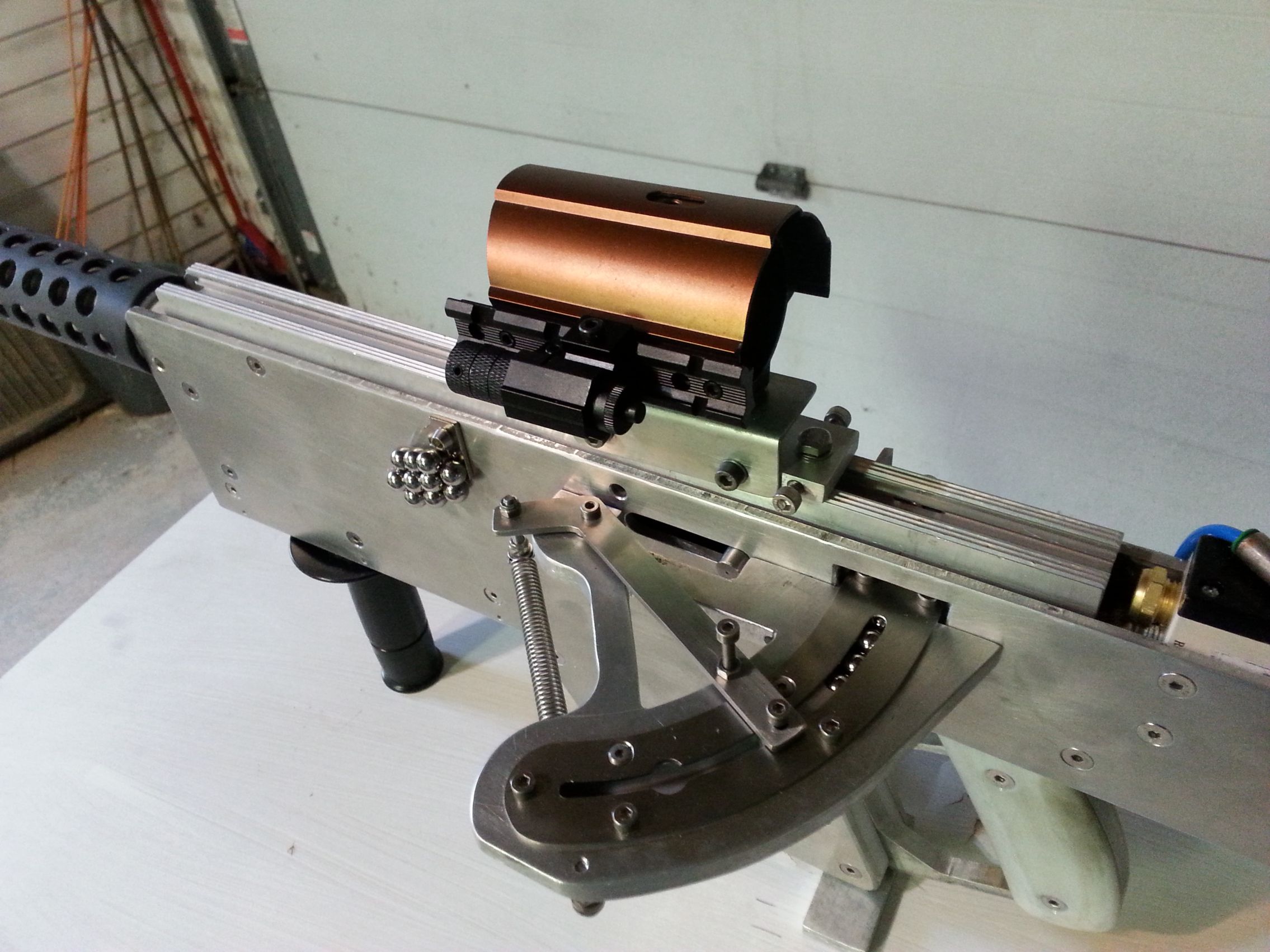

Love the foregrip, it seems like you have a cousin in South Africa ;)

Ah, he is using the shiny grooved variety

Interesting, noticed that the pellets were a tighter fit in this barrel than the last one, so tight that I had to seat them down the barrel otherwise 150psi was not enough to get it moving. This tube measures 4.60mm ID, the last one I built with a different piece of tube is 4.70mm ID. Just the luck of the draw with tolerences :shock: Going to polish out a small section at the breech end and see if it still works at 150psi.

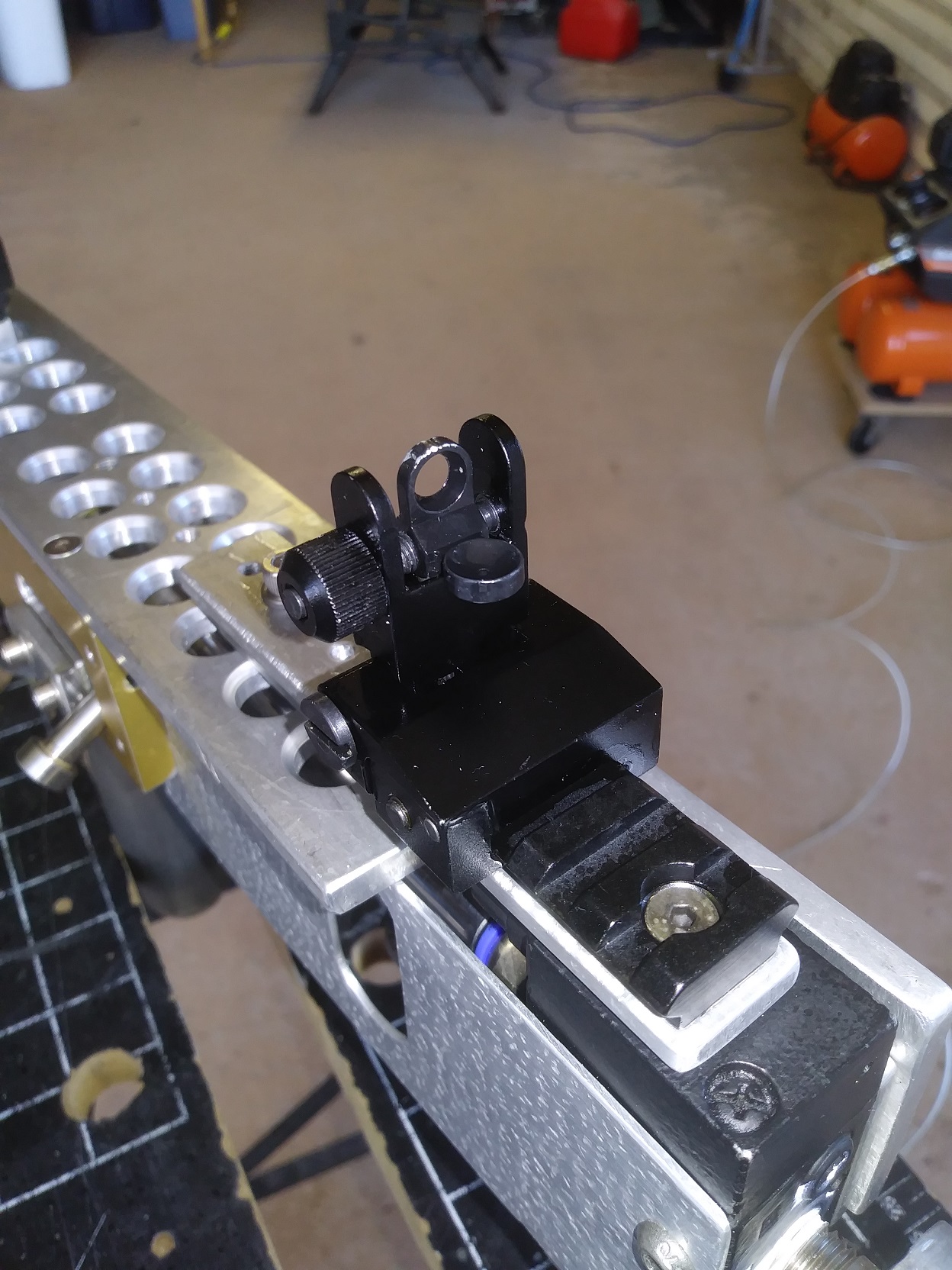

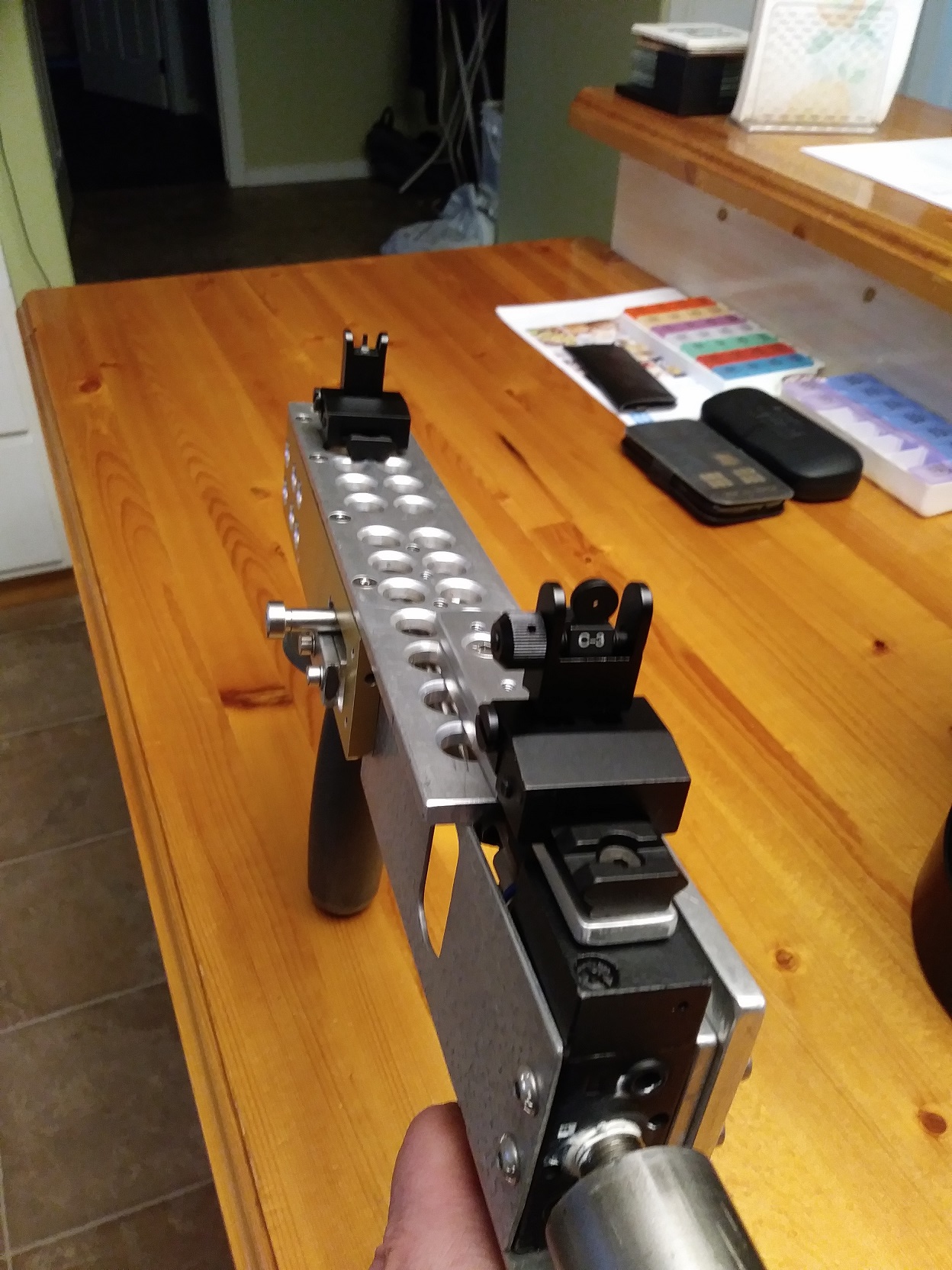

Got some decent ($20) flip up sights off Ebay to try. :D

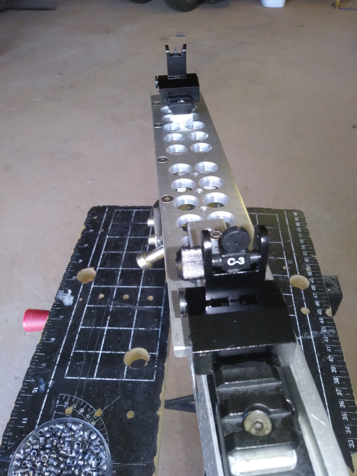

Sun May 05, 2019 10:54 am
Finally got the flip up sights set up.
Rear sight has duel apature, the small one seems better at close range.
2 x 10 shots at 9m bullseye target.
Wed May 08, 2019 9:10 am
For a home-made smoothbore those are excellent groups at 9 meters with open sights, bravo!
