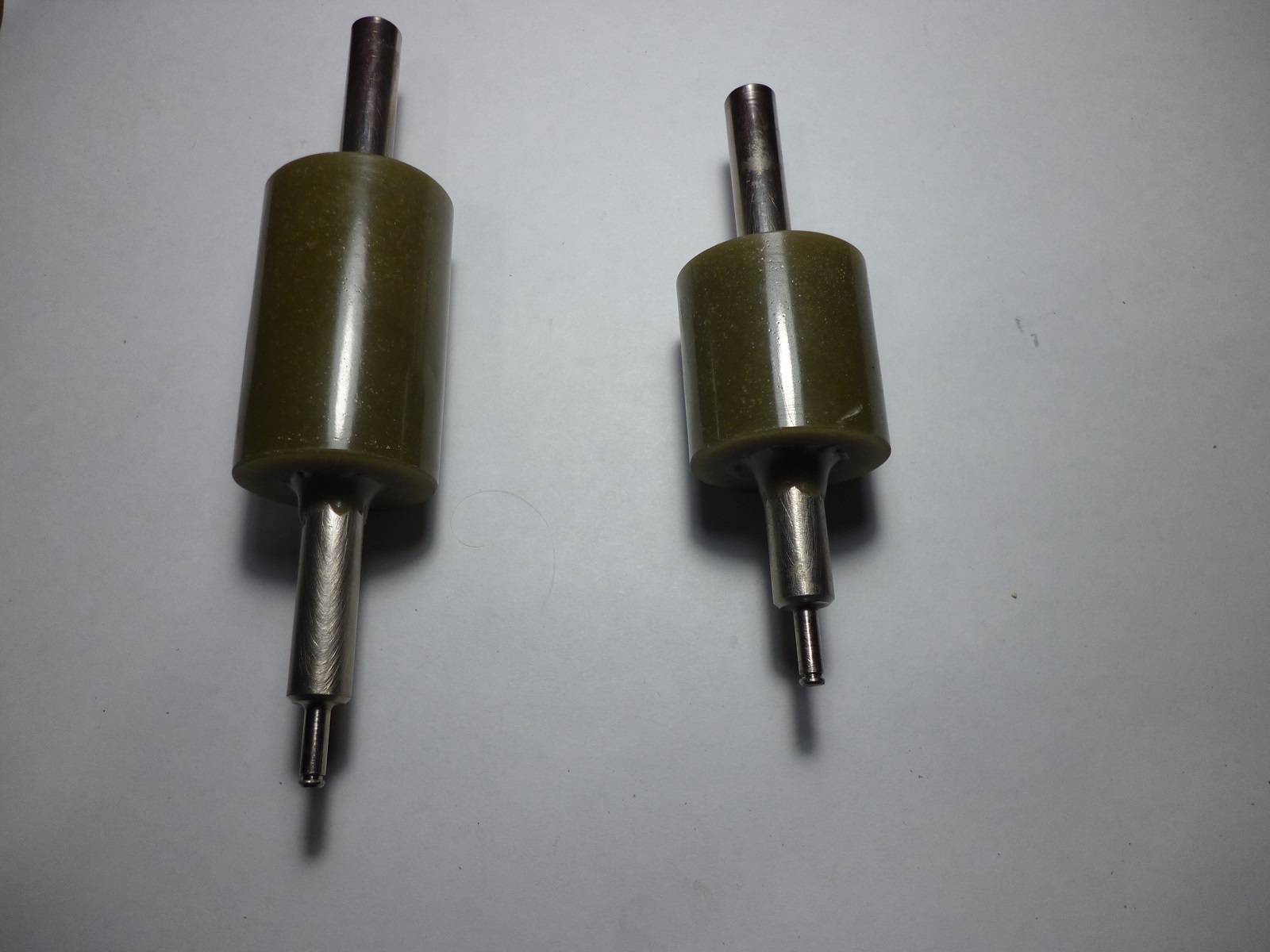

Today I manufactured the cover where the ignition goes and the valves, and the piston. They are prepared to be installed in the bank's boiling machine, to make the grooves of the o`rings and to give the necessary exact diameter. I have installed a small bearing on the end of the shaft that is down, to avoid buckling when doing lateral force, when the pieces are rectified and grooved. I will do this work on the weekend.

jackssmirkingrevenge wrote:Beautiful work on these, the epoxy-casting technique can provide great results once mastered.
Up to now the polyester and epoxy resin perfectly supports the forces generated in the hybrids up to 8X.
A few days ago, I disarmed the HA III that shoots at almost 8x with which I shot many times, I would say 300 or 400 shots, and the piston and cap that delimits the combustion chamber, where the ignition is located, are in perfect condition. I think the fact of incorporating 80 grams of fiberglass mts2 fabric in the central part has helped a lot, because it gives it more resistance. The o`ring have passed the test with good results, equally. For now I continue with this material, which is cheap and I can work without any problem. I imagine that it can take a little more pressure all this. :)

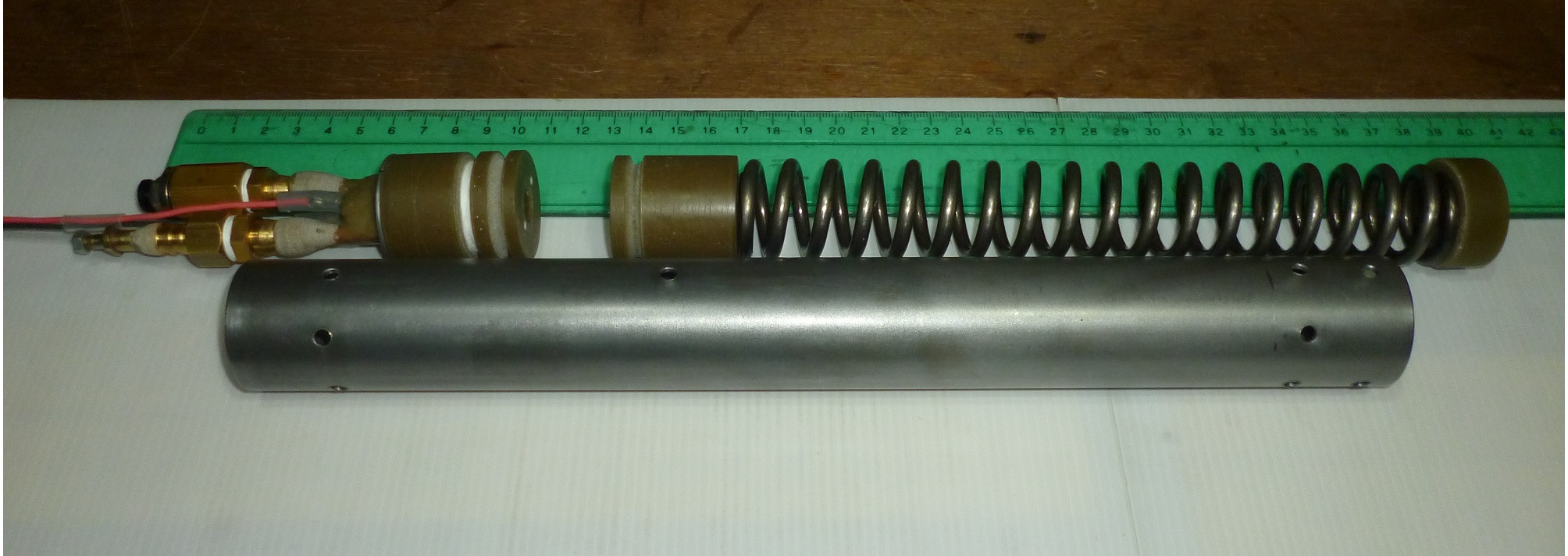

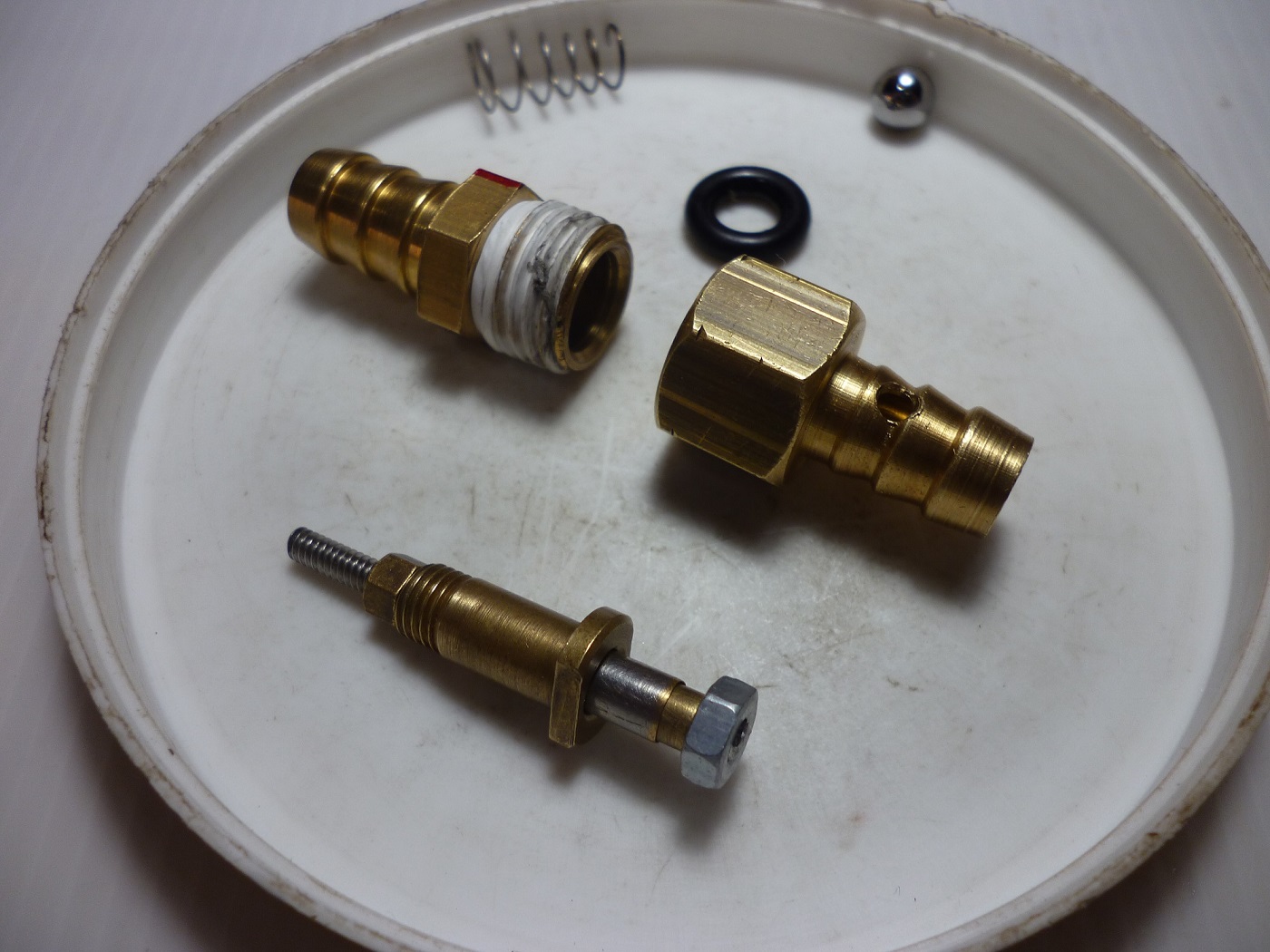

Here are some more photos to illustrate the construction process of this weapon.
The ignition is finished and tested, and the two valves are mounted on the cap of the steel tube head containing the spring and the piston, and have also been tested, it functions correctly :bounce:
It remains to do some things from the bolted system that loads the pellets and little else.
The space between the lid and the piston that was seen in the antepenultimate photo is the size of the combustion chamber. It has a diameter of 32 mm, (the diameter of the steel tube), and 30 mm in length, resulting in an approximate volume of 24 cm3.:)
