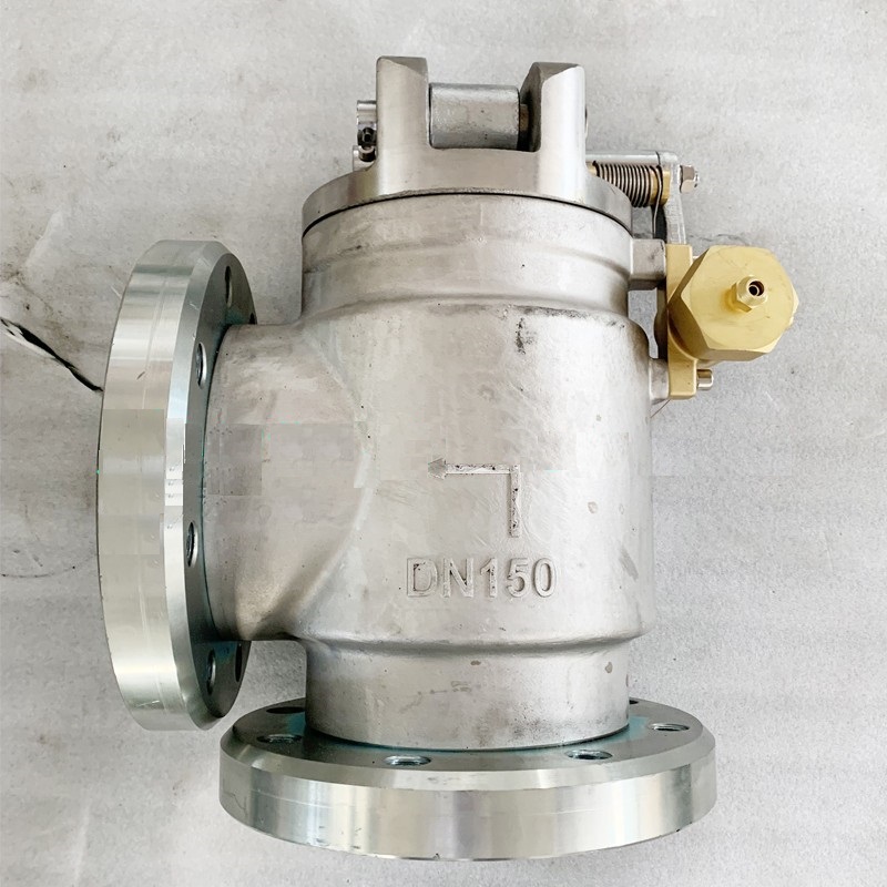

If you need approvals and have tax dollars to spend, you could drop Emerson a line and ask about piloted relief valves. Anderson Greenwood has something that might be made to work...not sure how quick it'll open as supplied, but it's basically a big ass qev.
https://www.emerson.com/en-us/catalog/a ... od-p001062

try using the name pressure relief valve, over exhaust valve
im in the same boat, trying to track down info on an supposedly adjustable pressure relief valve.
between 150 and 800 psi.
boiler or steam pressure relief valves might work too, some even have a triggering device on them too.
