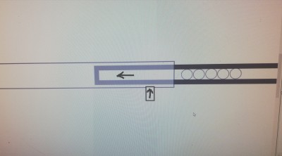

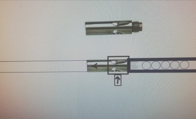

Yes, however back pressure could present some headaches such as all the BB's in the magazine blowing to the rear every time a BB enters the breech, then all sucked forward again as the fired BB clears the muzzle. They would alternate back and forth with a little farther to travel every time one is fired. I couldn't come up with a simple solution for that potential issue right off so I worked around it with a gappy barrel to avoid backpressure altogether. Perhaps a check valve on the end of the rear of the magazine tube could help a bit.

I should also mention that I did try a short tube one size smaller (5/16") at the muzzle end of the barrel, a "choke tube" of sorts, in attempt to tighten the spray pattern lol . Unfortunately, even this small restriction rendered it inoperable.
