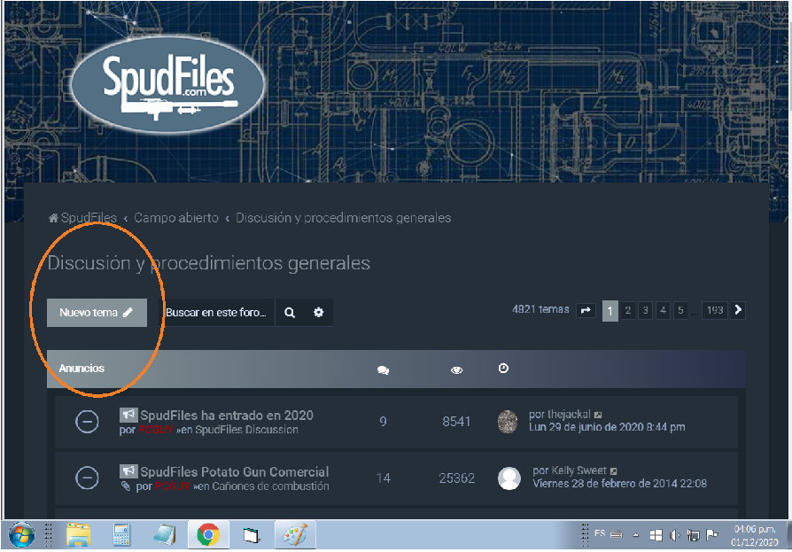

bravootome wrote:
Tue Dec 01, 2020 12:58 pm
it past over 1 year and still cant figure out how to make a new topic ,, admin explained me couple of times but i just cant find "new topic" like it was old times
any how i'll ask here, where the heck do i get particles of dust inside barrel ( accuracy issue ), unscrewed airtank couple of times and lot of dust on the walls . i cleaned it pretty well, put it back, and after 30 shoot same problem. i did this like 30 times on and on. where from all this dust ? the first 10 shoots after each clean are : "i shoot a cherry" by 20 m , then, " i try to shoot a watermelon " by 5 m..........
air tank is a stainless steel pipe welded by me, i welded another one thinking dust is particles from welding, air source is fridge compressor 60-70 bar. i improvised an air filter inside the fitting of the compressor- no effect............ what else should i do ?
Go to the link that I show you in my previous answer and "New topic" you will find it where the orange circle is, in the screenshot.
