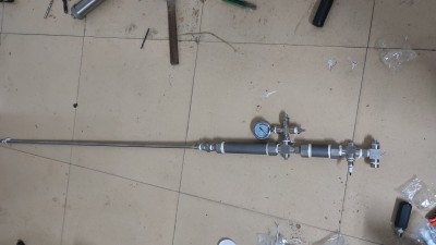

Well, actually, my secondary ignition device is almost finished. At present, I am more worried about whether the check valve can survive under great pressure. If it can't, I will choose to use bursting disc. I plan to use 1mpa mixture to ignite 5mpa mixture, and their components are propane+oxygen. I will update my results in the last few days, so let's wait and see!

I would like to focus the conversation on the possibility of turning on a high pressure chamber with a lower pressure one, which is the subject of your publication. what you explain about increasing the pressure with two connected chambers, I know well, because I have already talked about it here. For simplicity, I prefer to use a lower pressure ignition chamber, as small as possible, and a one-way valve calibrated to open as needed. I think it would work fine, you have to do some tests. 8-)

Cool!! I look forward to seeing his experiment. I will be careful. Do not forget the security measures. Cheers ;)

Thank you for your support. What target do you want me to place? It will launch a 10.5mm steel ball.
