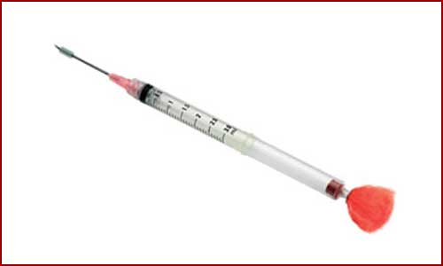

Are you using a smoothbore or rifled barrel? I know they're 0.50 cal but maybe you could roll your own version from an insulin needle or something?
I, for one, would be terrified of ketamine darts...
.30 cal rifled barrel from a firearm, I've collected quite a few in various calibers for just such projects...
I'm guessing you had missed this one? viewtopic.php?t=26708

Also lol at hectmarr's last post.
Tue Feb 09, 2021 11:55 am
mark.f wrote:
Tue Feb 09, 2021 11:47 am
You can see what happened, to tame is "domar" in Spanish so an easy leap to make when English is not your first language :D
