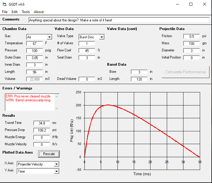

I am trying to use the GGDT software but im having issues. I keep getting an error stating that the projectile never cleared the barrel, but I believe I put in reasonable numbers.
The odd thing is if I increase the chamber inner diameter, it decreases the volume. If I increase the outer diameter, it increases the volume. I don't know why the outer diameter is even relevant to the experiment since its just the wall thickness.
Wed Mar 17, 2021 12:12 pm
"Outer Diam" is the inner diameter of your chamber tube.
"Inner Diam" is the outer diameter of your barrel for a coaxial cannon.
If your design is not a coaxial, the "Inner Diam" should be zero.

Man how were we supposed to know that. Anyway I'm starting to get realistic numbers now. Thanks!
