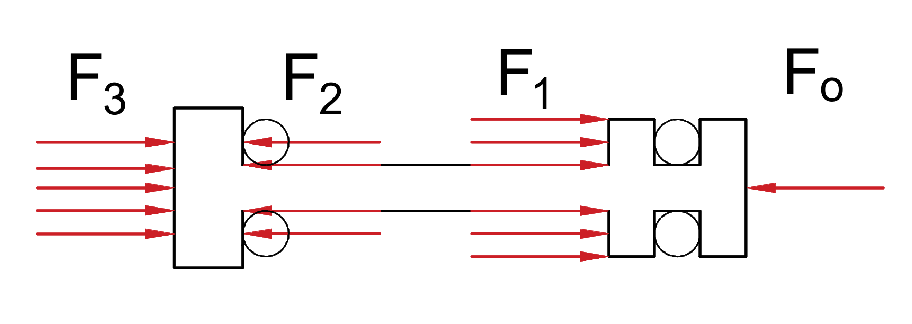

Hello everyone!
I finally found some free time after finishing my undergraduate degree and I'm starting to get back into this hobby. One thing I always wanted to make is a pressure regulator to fill my creations from a external tank. Currently I have a 2l fire extinguisher to use for this purpose.
My fluid mechanics is a bit rusty and I've never solved problems with compressible fluids like this before, so I'm asking for help figuring this out. Basically I'm trying to set up a mathematical model of a regulator to find the appropriate spring, overall dimensions and working pressures. I'll be trying to shrink the design as much as possible, so knowing the forces and stresses will be important.
This will be used for my last build, the Barret M98b replica. Unfortunately I can't find the old showcase post, as if it's been deleted, so here are a few photos. Some of you might remember it

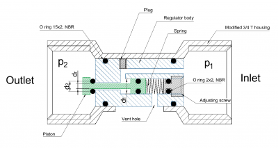

Initial regulator design will be based on the following image, posted years ago on Spudfiles. Forgive me I don't know the author
This is what I came up with:
Initial values are:
p1 = 15 bar -Inlet pressure from the external fire extinguisher tank
p2 = 6 bar -Outlet pressure, inside the onboard tank
d1 = 6 mm -Piston diameter, minimum value limited by the smallest available O ring (2x2mm)
d2 = 4 mm -O ring contact diameter
dr = 2 mm -Rod diameter

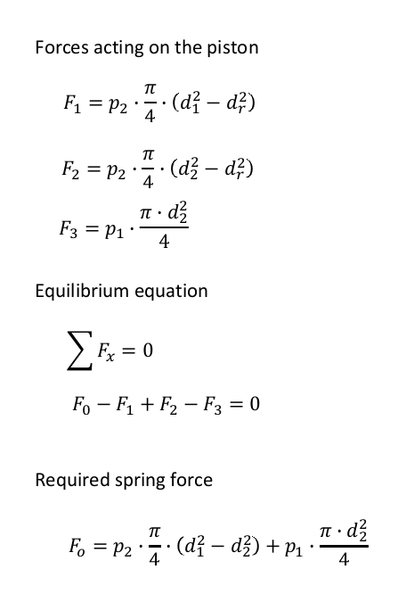

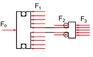

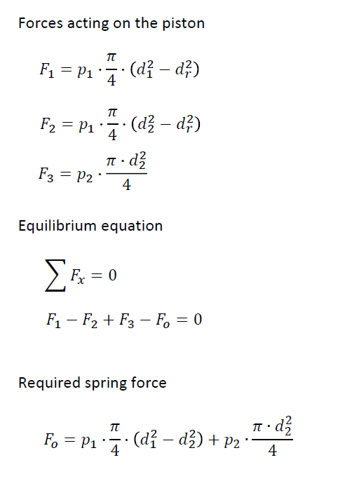

Forces acting on the piston:
Forces on piston.png (14.87 KiB) Viewed 20671 times
Where:
F1 is the force due to pressure p1 that is closing the regulator
F2 is the force due to pressure p1 that is opening the regulator
F3 is the force due to pressure p2 that is closing the regulator
Fo is the spring force that is opening the regulator
Equilibrium equation and spring force:
Equations v1.png (16.51 KiB) Viewed 20671 times
If forces in the picture above are set up correctly, spring force that keeps this system in equilibrium is Fo=31,1N.
When I keep the spring force constant at Fo=31,1N and solve for pressure p2 while lowering inlet pressure p1, the math falls apart below p1=11bar. The results become nonsensical in that the outlet pressure p2 becomes greater than p1. I'm not sure if this is due to some error I made or the assumption of constant spring force is no longer valid when the spring elongates, opens the regulator and stops it from functioning.
My overall concern with this design is that outlet pressure p2 rises when inlet pressure p1 drops. I'd very much prefer it to be the other way around, if that is even possible. Also I'm not sure what effect friction will have or how to model it. Could anyone double check these equations? Any suggestions are welcome.
Please help if you're a mechanical engineer laughing at this simple problem :D

I think these are really simple equations, it's not like I'm writing out Navier-Stokes here :D I just don't trust myself in correctly assuming the surfaces on which pressures are acting upon, because I literally have no experience with solving this kind of problems. My major deals with incompressible flow and hydrostatics, I've never dealt with sealing faces, O rings or pistons like this.

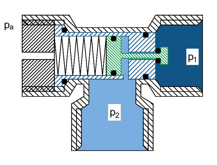

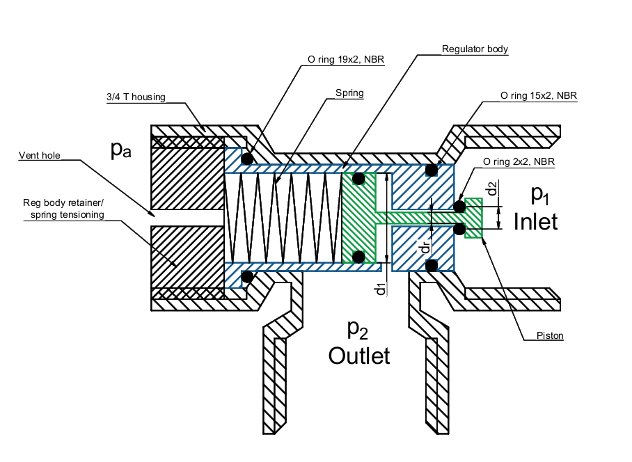

Anyways, after tinkering with this a bit more I figured out mirroring the design worked better when the spring is acting against the lower (outlet) pressure. This significantly lowers the spring force. Also having access to the spring should make testing easier. I'll call this version v2:
After figuring this out, I found the following article showing the exact same design (Fig1) used in paintball regulators http://www.docsmachine.com/tech/regs.html
Unfortunately there were no dimensions or equations for sizing such a thing.
To better visualize which pressure is acting on what surface, I've colored the low pressure (p2) zone blue and high pressure (p1) zone dark blue:
I think the resultant forces due to (gauge) pressure acting on the piston now look like this:
Forces on piston v2.png (7.42 KiB) Viewed 20518 times
Setting up the same equilibrium equations resulted in changing the minus signs and switching p1 with p2:
Equations v2.png (28.07 KiB) Viewed 20518 times

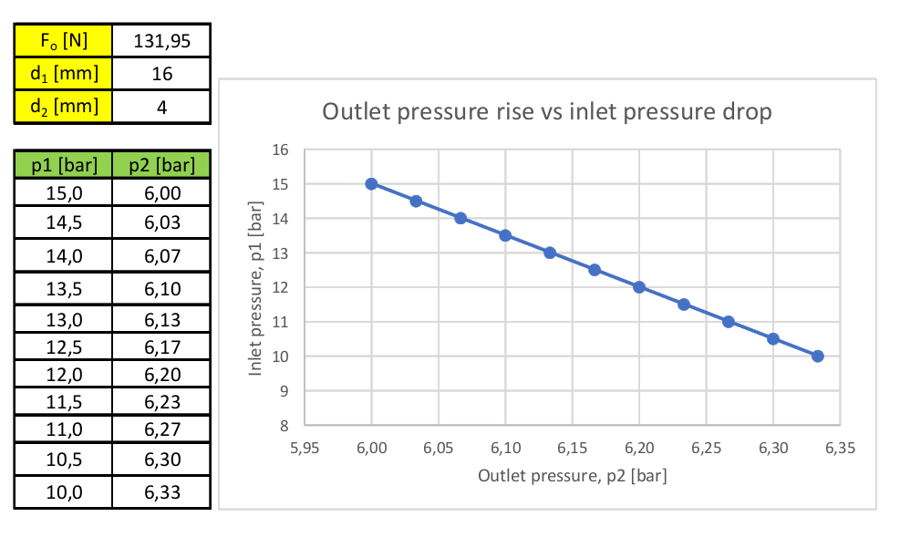

After trying a few dimension combinations, I've settled on the following:
d1 = 16 mm -Piston diameter
Fo = 131,95 N -Required spring force
Plotting the outlet pressure as inlet pressure drops with a constant spring force now shows a much better situation:
Does this look reasonable for a pressure regulator?
I will soon be fabricating a prototype to verify these equations and hopefully find out if I made some big error.

I completely agree and this is the idea behind the v2 design. It’s very different compared to the initial design and probably doesn’t deserve the name inline anymore :D
Maybe I should have noted that the left side of the v2 is open to atmosphere and allows external adjustment of the spring force, where pa is the atmospheric pressure (or where the gauge pressure is equal to zero). The drawing in this area is more illustrative for simplicity, there would be a separate part for keeping the regulator body in place and another for tensioning the spring.

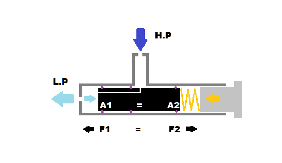

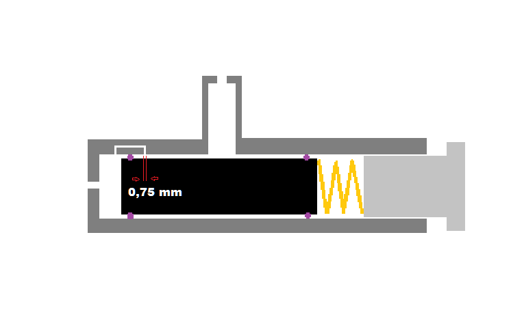

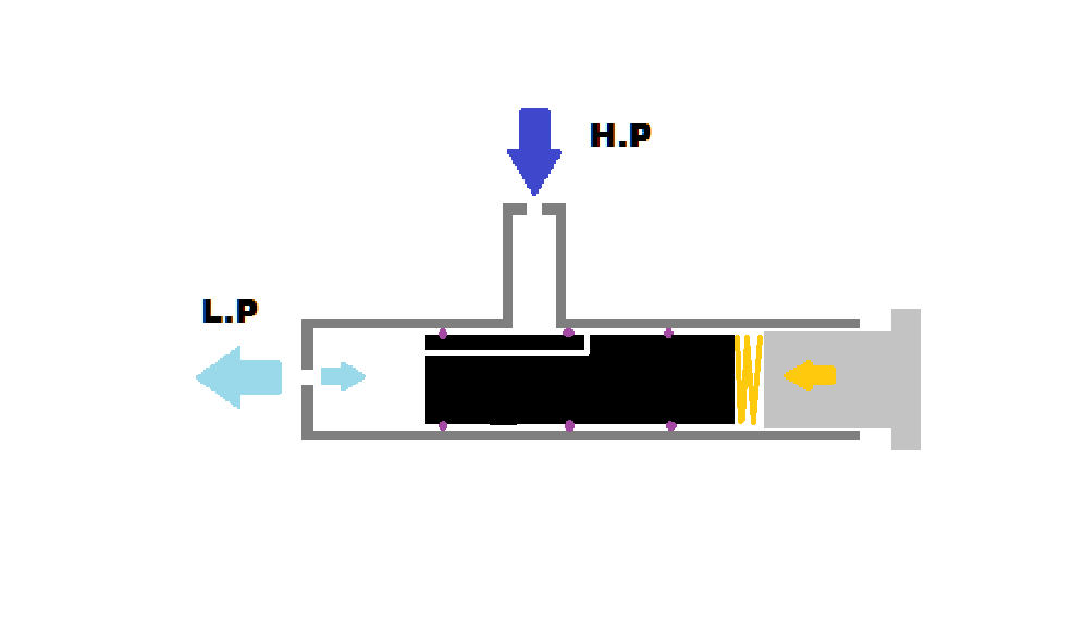

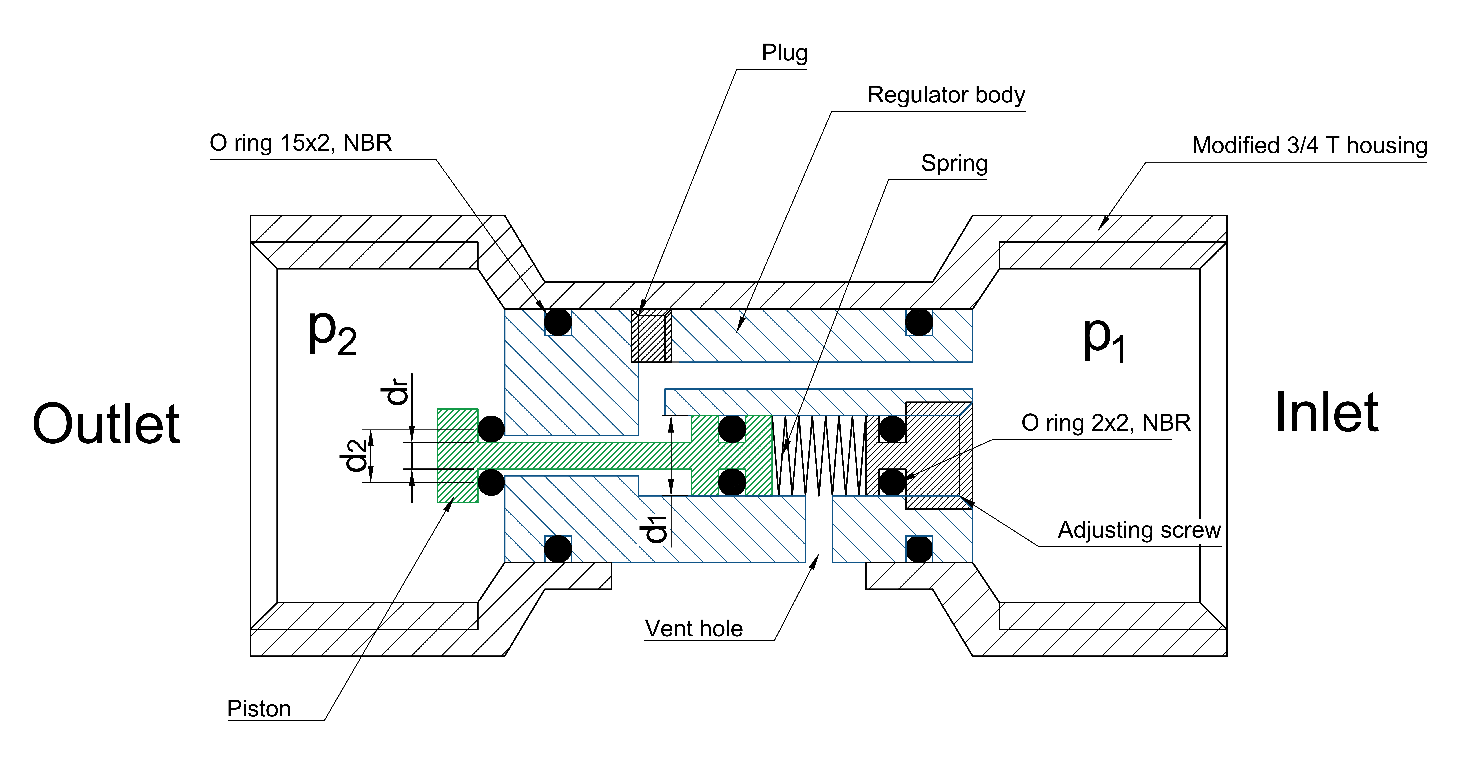

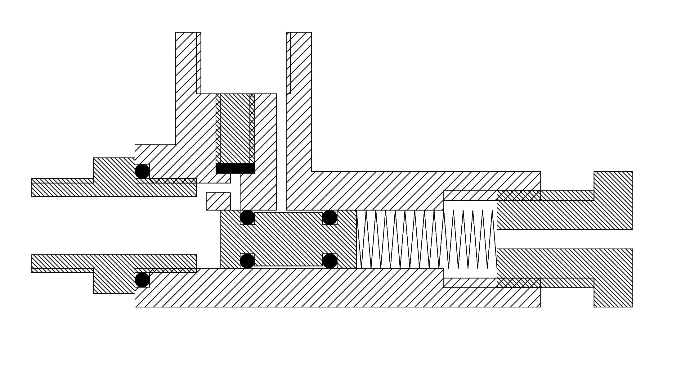

This little pressure regulator, I made it.
As the areas on the two faces of the piston, (6.3 mm) are equal, the high pressure compressed air, (arrow in dark blue), that enters produces the same force in both directions, and the piston is balanced, without any math.
The displacement of the piston is only subject to the force of the spring, which is adjusted with the screw on the right of the drawing, and the force of the air produced on the left side, (arrow in soft blue).
It works very well, at the entrance it can load up to about 30 bar and at the exit, it regulates between 3 and 30 bar.
In the drawing there are the two positions: 1- when high pressure air is entering, 2- when the force of the regulated air overcomes that of the spring, and the piston moves to the right and does not let more air pass.
reg. pres. 1.png (6.88 KiB) Viewed 20370 times

That's a great design.

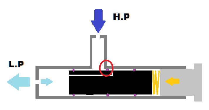

That looks really nice! I like how the piston is acting like a spool valve, making the output pressure depend only on the spring force. The spring must be very light for 3bar output. Does the input HP pressure actually have no effect on the output LP pressure with your design?
My only slight concern is with this corner acting like a cheese grater against the O ring:
Perhaps this could be mitigated with a really small input port on the HP side, smaller than the O ring diameter.
How small did you make the hole going through the piston?

Actually the one I show in the photo has only two o'ring, which are 2 mm thick. The inlet hole is very small, 0.75 mm and is polished on the inside, which added to the lubrication, a little silicone, which does not come off, does the job.
It works as a shut-off valve for the "HPA" bottle, which I use, (a co2 tube that I can fill up to 60 bar).
When the spring screw is completely loosened, the piston is positioned to the right, in a position that does not allow air to pass to the left face of the piston, closes the air inlet and the regulated pressure outlet can be depressurized, leaving high pressure the entrance. It loses nothing, luckily.
The blue hose you see is only up to 12 bar. To use more pressure at the inlet, it is screwed directly into the "HPA" bottle.
The spring is about 4kg compressed to the maximum. Below 3 bar of regulation pressure, the piston has a hard time moving because the spring forces vs the regulated air on the left side is poor ... Note that friction increases a lot when the small o'rings are under a lot of Pressure. It would be the weak point of the regulator, but I never use such low pressure, for my things it is between 7 and 10 bar and in this range it works correctly.
Answering your question. The inlet pressure has no effect on the sideways displacement of the small piston, because the forces are the same and opposite. I imagine that all pressure regulators work the same, although the mechanical solutions are different.
I use it to power a hybrid rifle that operates at 8X .
Regulador presión casero dos oring.png (4.25 KiB) Viewed 20281 times

This last picture with the 2 O ring piston would be rather hard to fabricate... Brass could be drilled and then soldered shut, leaving the 0,75mm diameter path for the air. I plan on making the regulator body out of AlMgSi0,5 stock (6060 Al) so this is not an option.
hectmarr wrote:
Sun Nov 14, 2021 10:17 am
It's down to pressure differential. If you have a HP bottle at 60bar and output pressure of 10bar, that's a 50bar difference acting on the O rings.
I would be running it at a much lower 9bar differential, so maybe 3 O rings wouldn't be an issue. Drilling a 0,75mm hole through the piston, using 3x1,5mm O rings leaves me about 6,6mm^2 at the critical cross section, holding back 15bar in the closed position. That equates to about 13MPa of tensile stress, low enough for aluminum.
On the subject of O ring friction, I found this research paper "Friction Forces in O-ring Sealing" which gives an analytical formula for determining friction forces in O ring seals. Problem is that the formula they submitted results in a friction force that is 3 times greater than they reported in the study. I spent a good few hours going through the math in this paper until I realized it was botched. I should really look for a better source of info on this subject :D

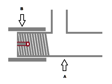

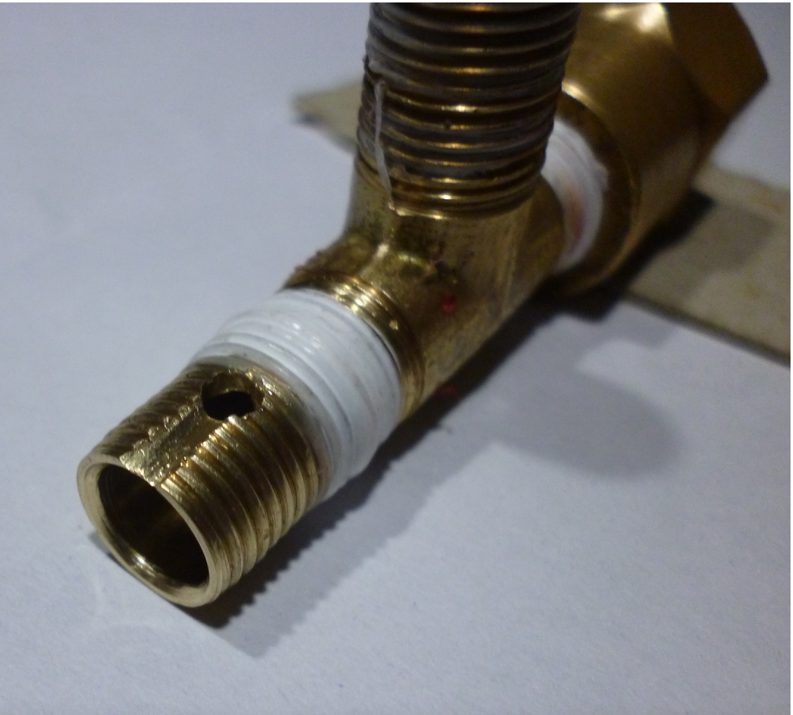

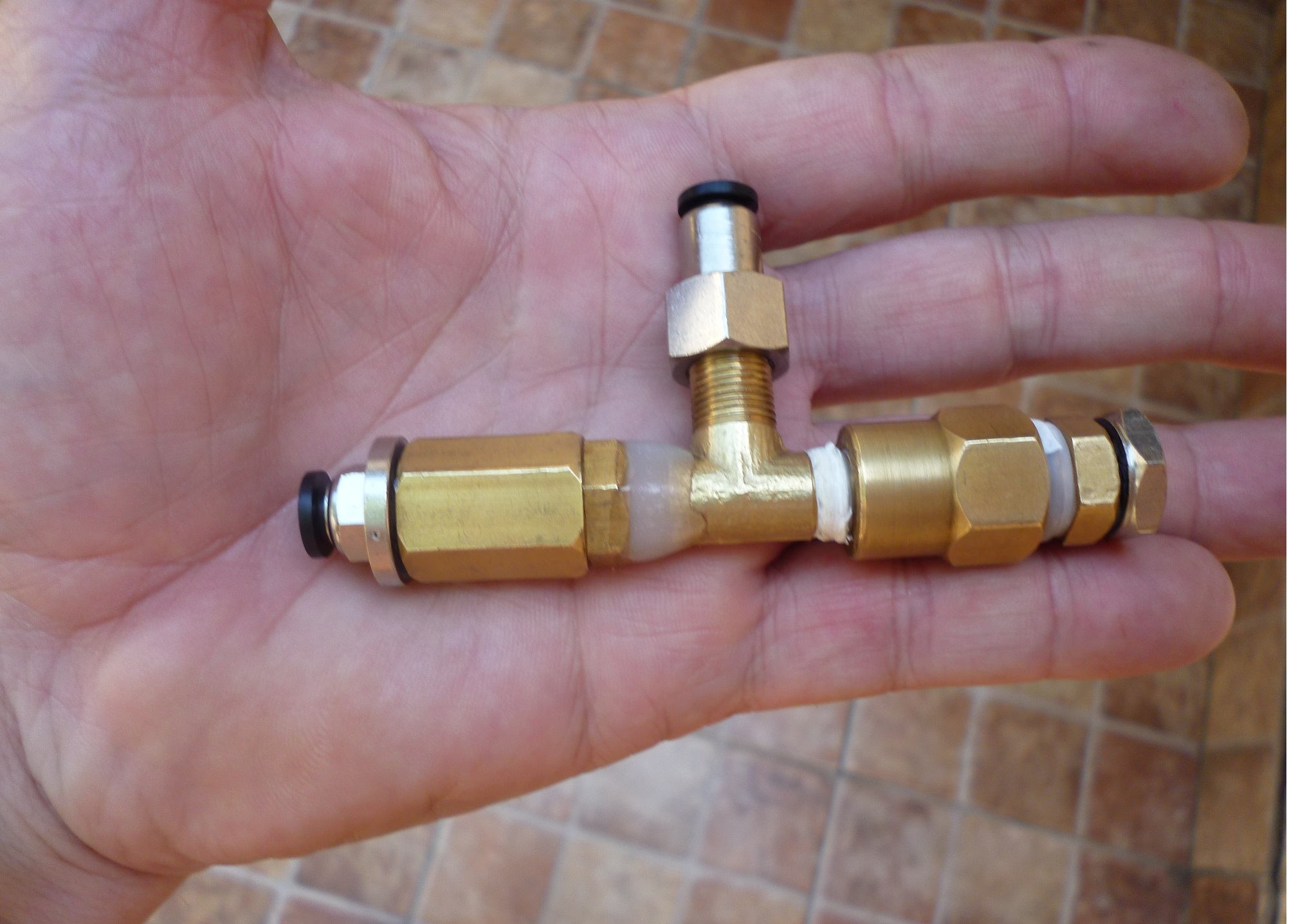

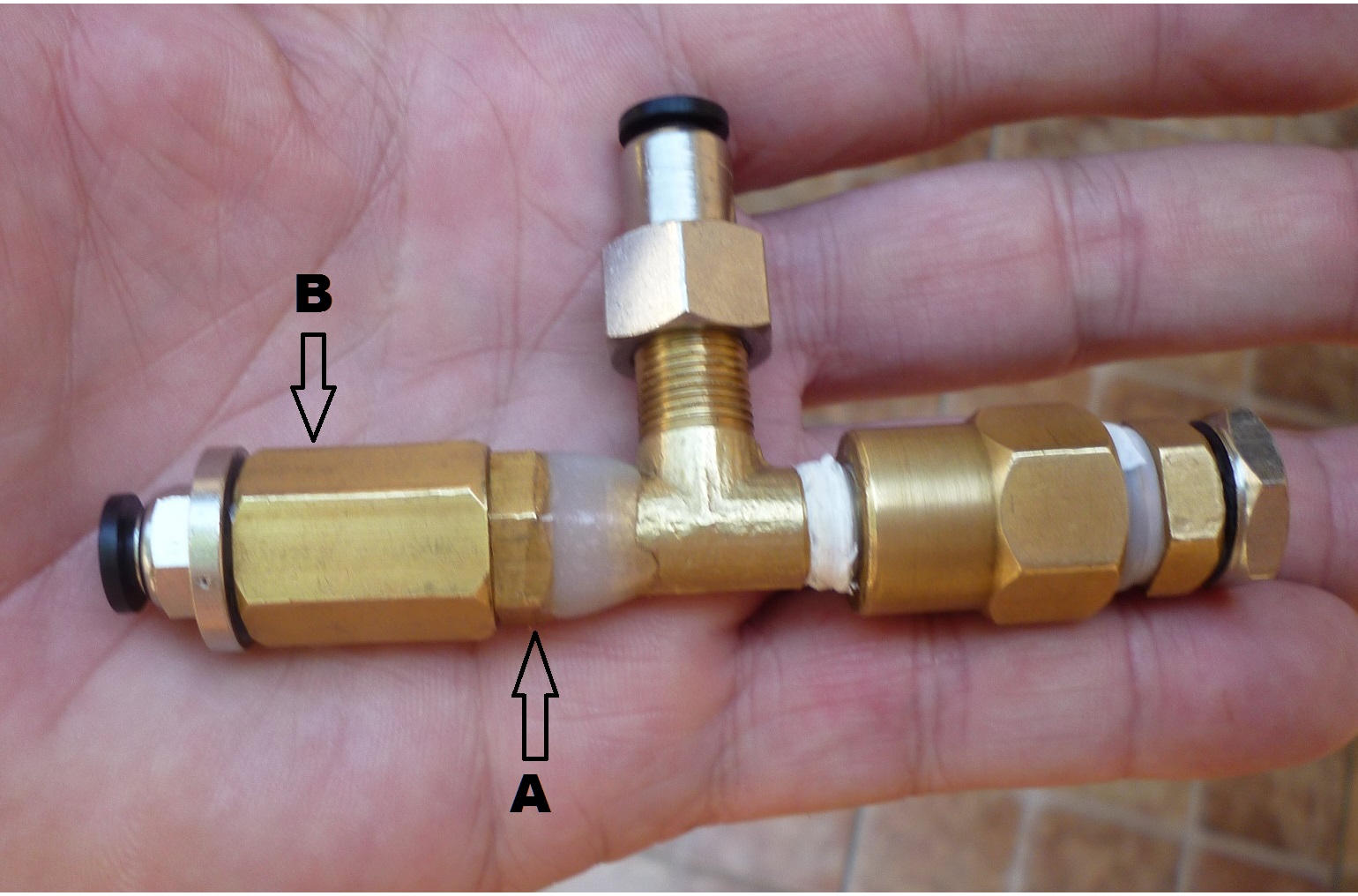

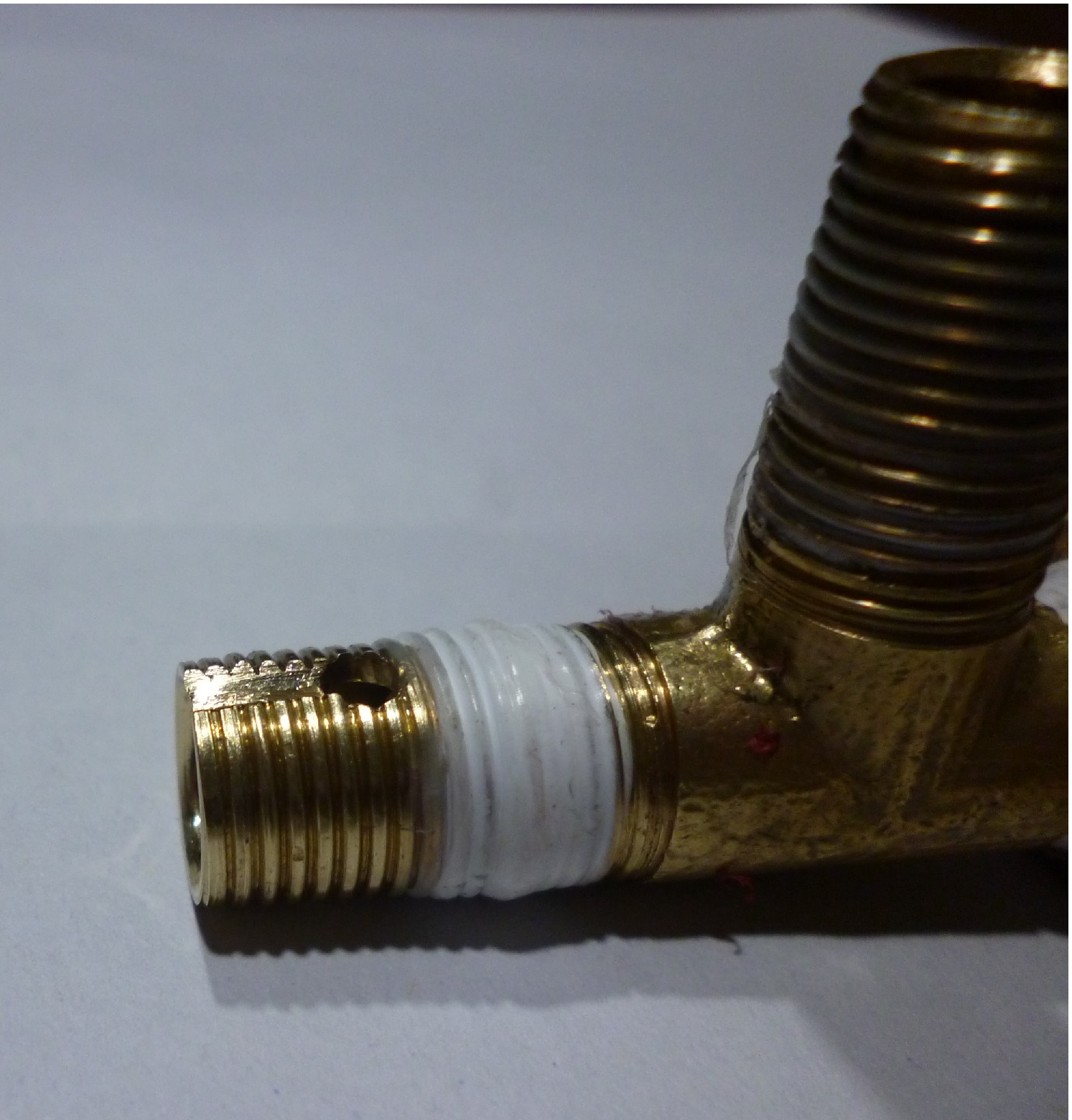

It is not so difficult to make the air passage channel.
I drilled a hole in the body of the regulator "A" and then made a slot with the Dremel, as the drawing shows, but without breaking the inside of the body, where the piston moves.
In this way, there is a conduit through which air can pass between the body "A", and the threaded piece "B". I made a diagram to make it easier to understand.
In this particular case, it is a bronze body with a larger air passage hole, about 1.5 mm and there is no problem with the o'ring, if it meets the condition of these mirror polished inside, no inner edge. It is a body of evidence that I have photographed for you.
I think that increasing the diameter of the piston, in my design, the bid between the resistance of the o'ring vs force, would be favorable to the force. I mean that since the perimeter of a circle increases linearly with the diameter, and the area with the square, I can make the piston 12mm instead of 6mm. If the friction for a constant pressure differential increases as a function of the contact area of the o'ring with the cylinder wall, the friction for a 12 mm piston will be approximately double, (approximately because I do not take into account other factors, and both being o'ring of the same thickness), and as the area has increased 4 times, the force will be 4 times greater and everything will move more easily.
Thanks for posting the pictures. Machining it from a solid block requires a different solution though, this is what I'm working on right now:
I agree with your assumption of friction doubling for a piston of double diameter, but knowing its value is important in determining if it's relevant or not. Does your regulator have some issues in operation that would make you rather have a 12mm piston?
iknowmy3tables wrote:
Tue Nov 16, 2021 11:36 pm
sorry I'm very late to provide any useful contribution, Statics class is a long time ago did a slightly different force analysis on your original regulator design and got basically the same force formula just phrased F0=(pi/4)*(p1(d1-d2)+p2d2) if that any reassurance
also the pressures involved doesn't seem too exotic is there a reason you aren't buying a regulator like this? https://www.mcmaster.com/41735K12/
Have you taken friction into consideration somehow?
As for the commercial regulator, besides what I mentioned already, it's way too big defeating the second purpose of this project.
