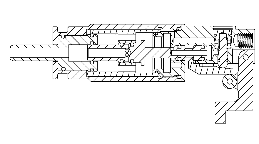

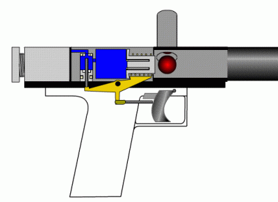

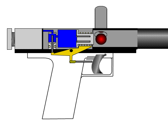

Those curious attached giff.
From patent drawing ,
Here's how the release system works .
Without the action of nozzle / back forward loads BB.
Assume done , inbetween trigger pull / sear , shots .
( Other attached giff / automag , seems design is sort of same working principal )
fire position .gif (25.92 KiB) Viewed 30453 times

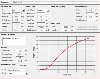

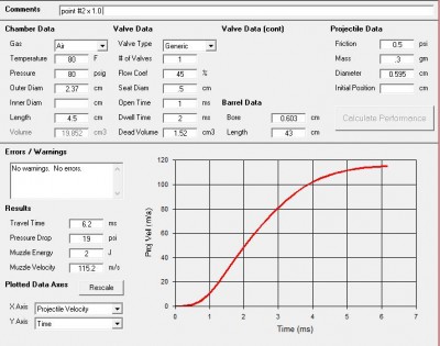

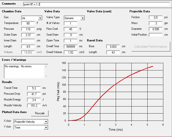

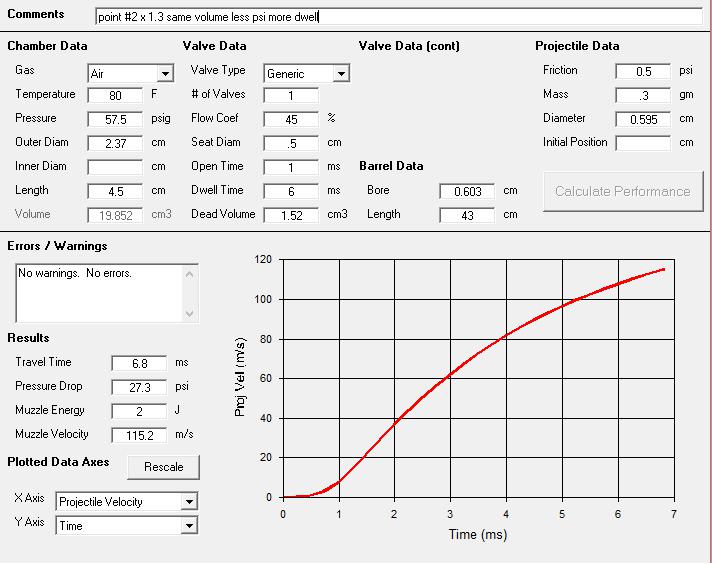

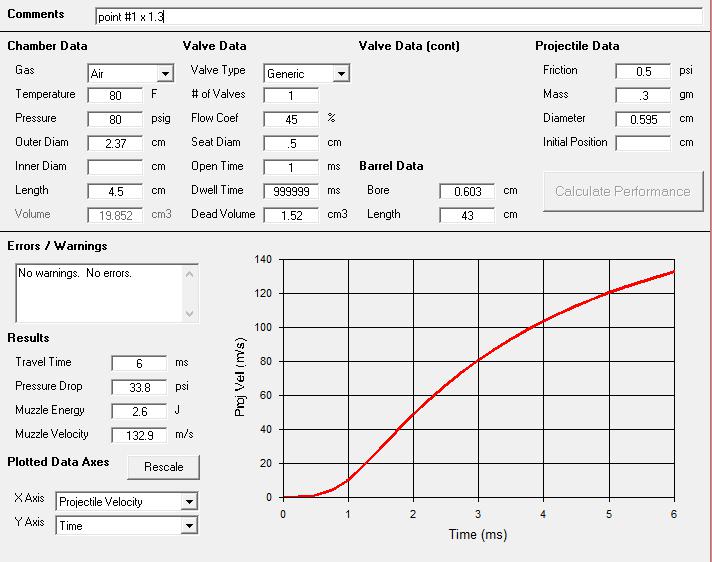

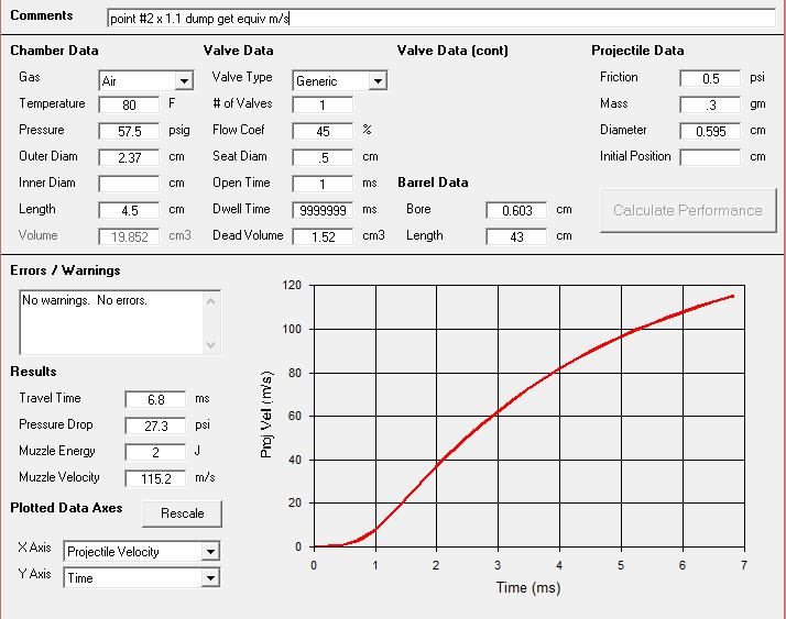

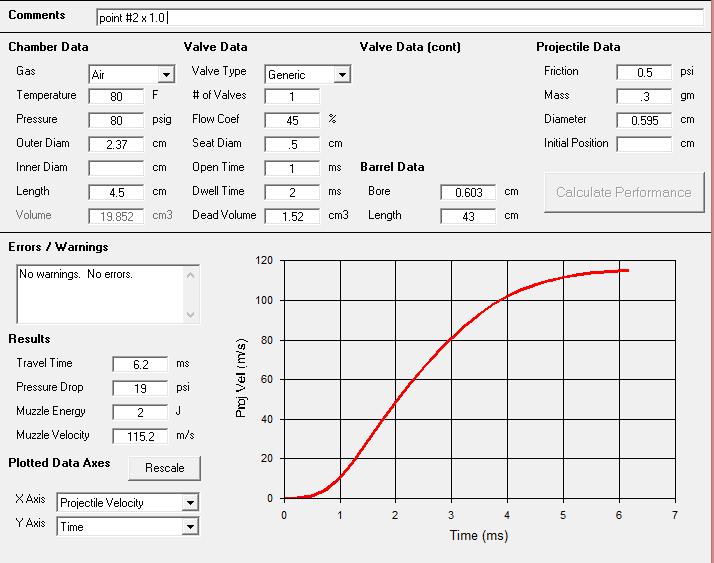

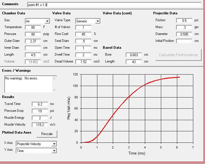

Ran scenarios through GGDT.
Regards to point 1.
.30 gram BB @ 5.95 mm
.603cm I'd barrel @ 43 cm long
Assuming 1.52cm3 dead space.
Asummed Nozzle , 5 mm I'd . Same as seat ?
@ 80 psig timmed
@ 80 psig timmed
@ 110 psig dump with reduced volume to match 80 psig volume equiv
@110 psig same volume as first pic but dump .
As first pic same volume @ 80 psig but dump

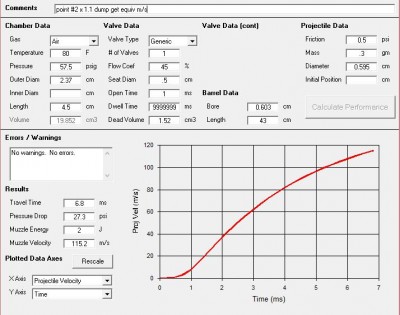

Wed Dec 21, 2022 1:41 am
As above .
But in relation to point 2.
Same as pic 1 for reference timmed
Reduced psi ( -28.125%) dump to get same m/s as first pic
Reduced psi More dwell to achieve same m/s as pic 1

Wed Dec 28, 2022 11:29 pm
Hi
Maybe someone with more experience with the GGDT ,
Can explain why in the Dump ( 9999+ ms ) of valve .
In the results section : the pressure drop is not equal to the pressure in chamber .
( Train of thought if volume of chamber is completely dumped , it would equal the pressure
Drop .?)
Outside of what done above ,
To get dump valve and results of pressure drop higher ,is to reduce the volume of chamber by some 60% of the timed valve .
Wed Jan 11, 2023 2:12 am
If I'm getting it right, the trigger simultaneously blocks the airflow from the main chamber and releases a blow-forward valve that dumps the firing chamber?
