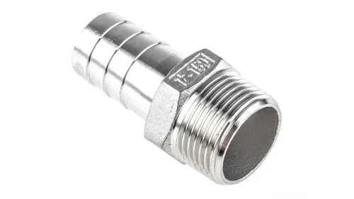

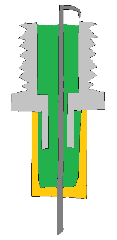

I would make something like that:
Using this sort of fitting:
Yellow is a plastic cup or similar insulator, glue to the fitting, stick your electrode through then pour marine epoxy.
Thank you for your advice. It looks good. I will try to make it. :)
