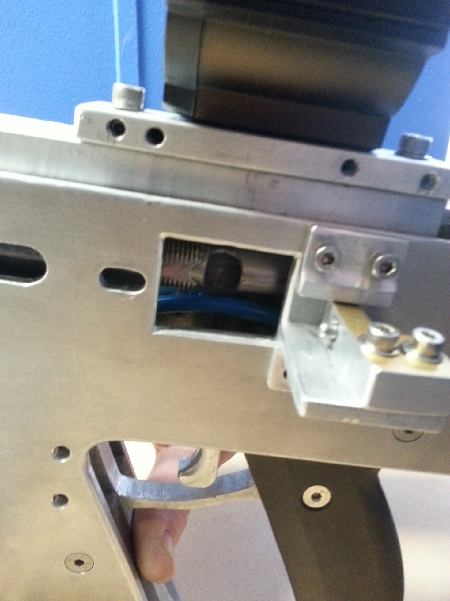

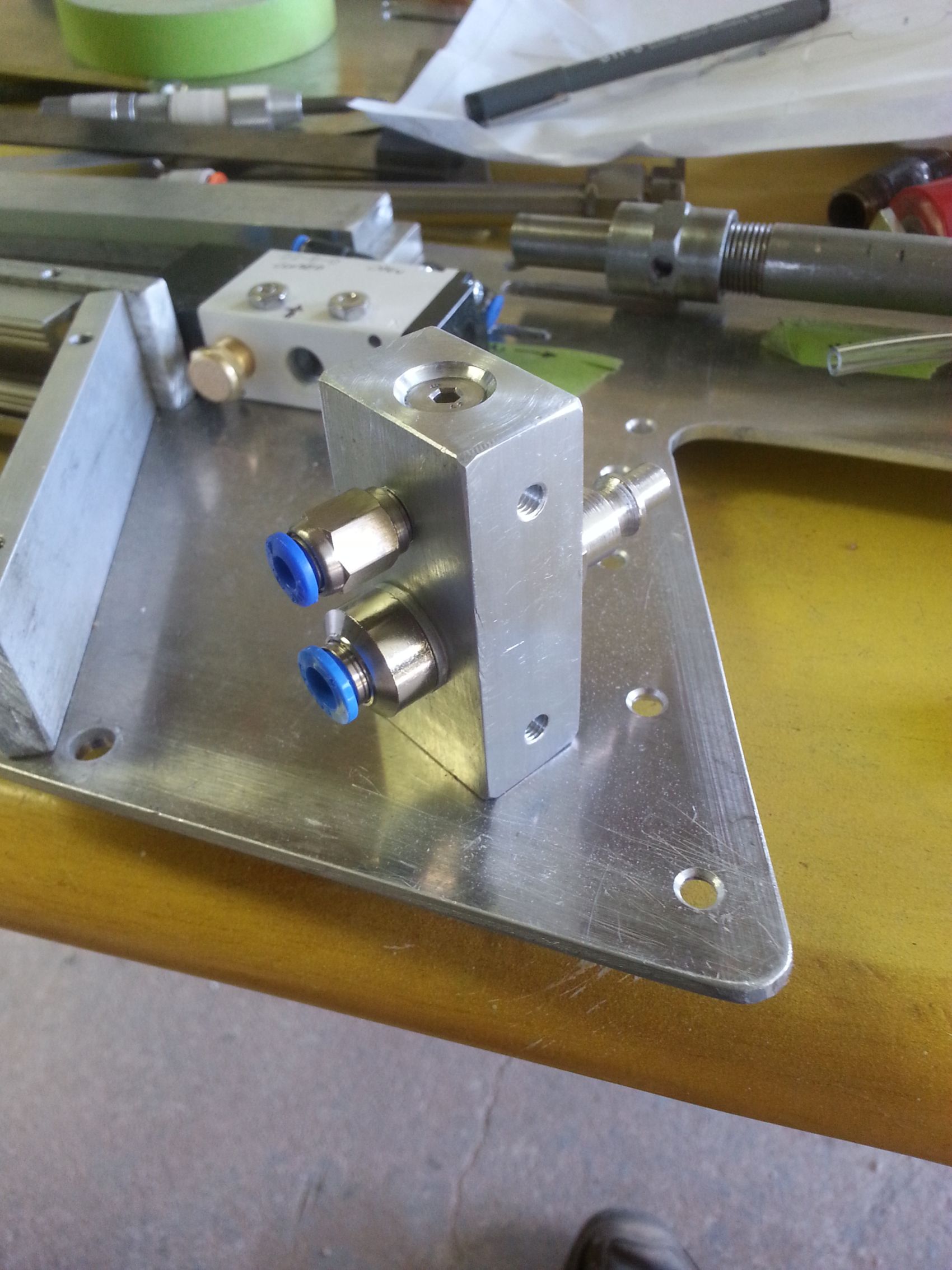

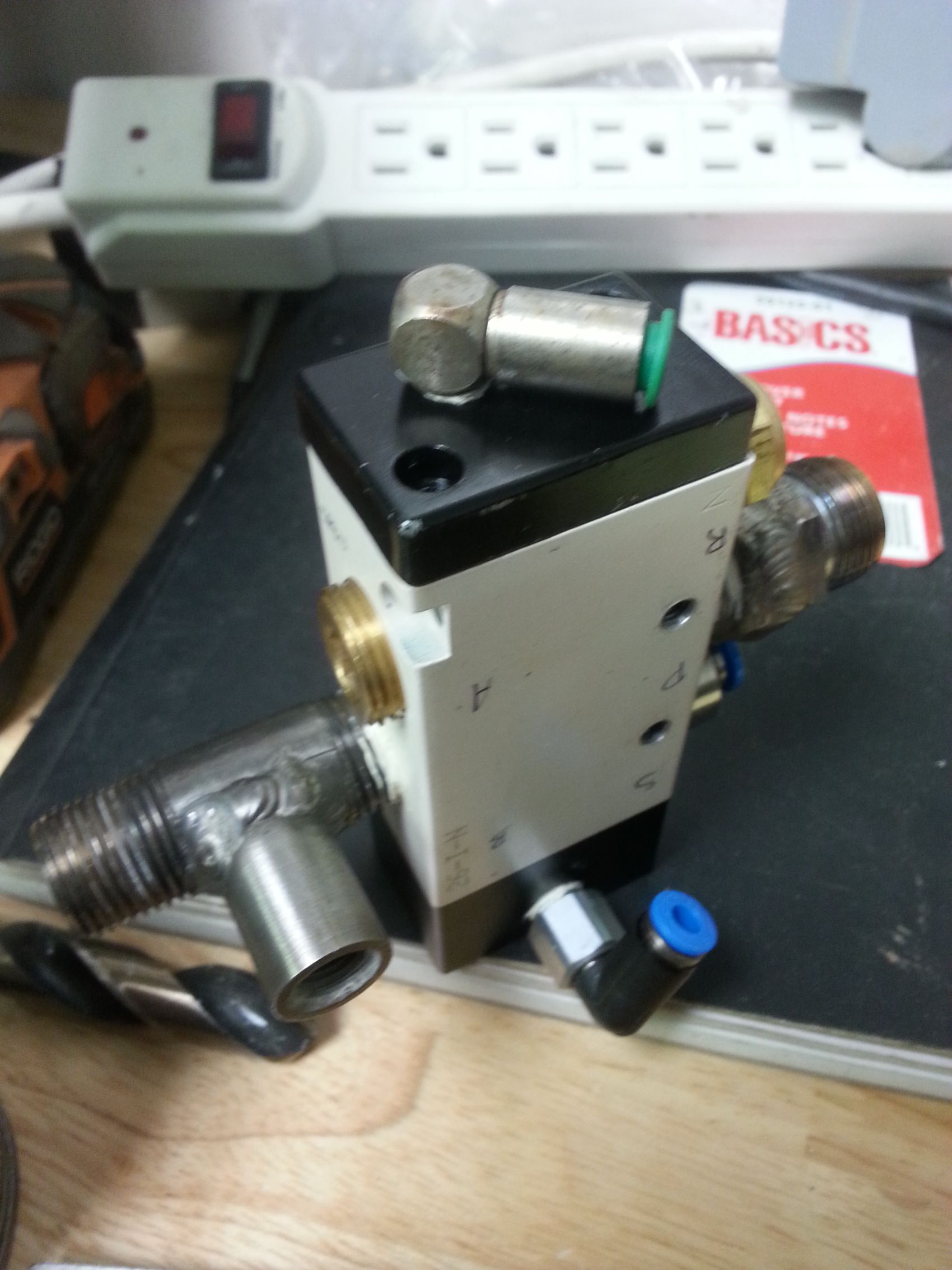

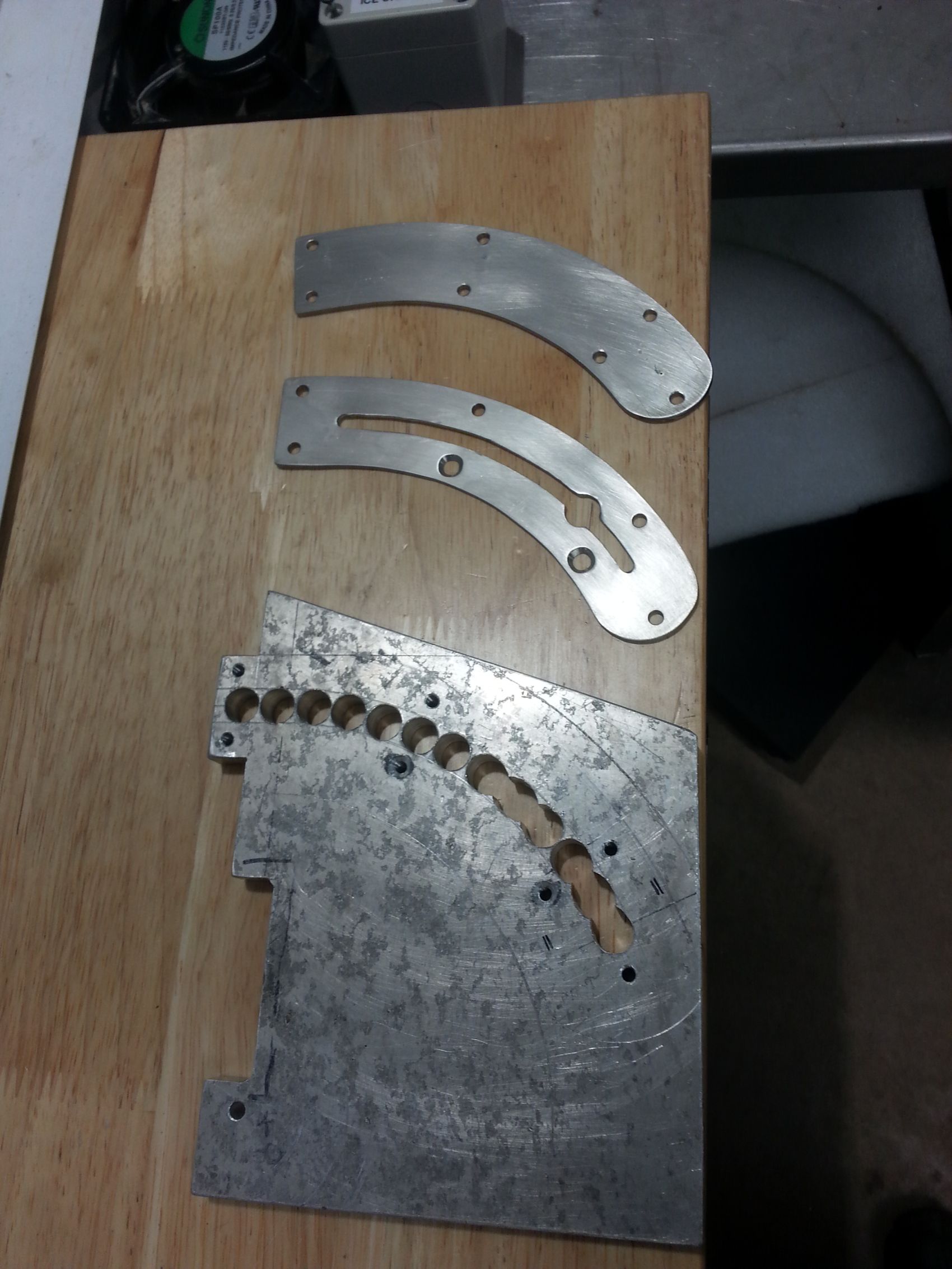

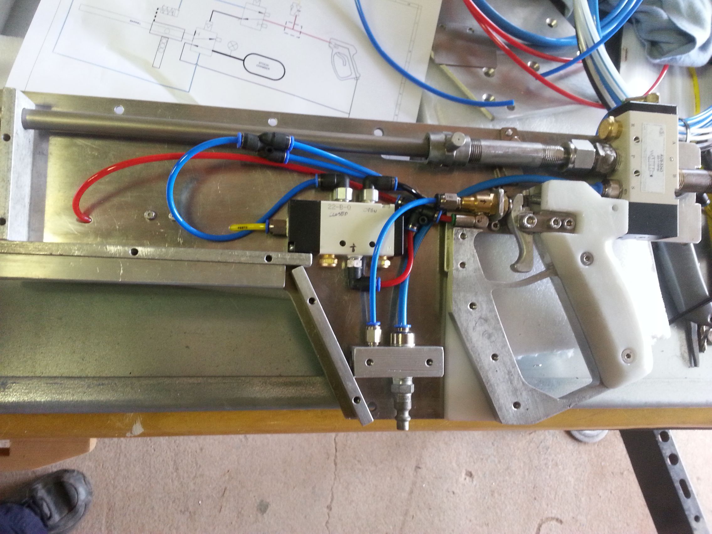

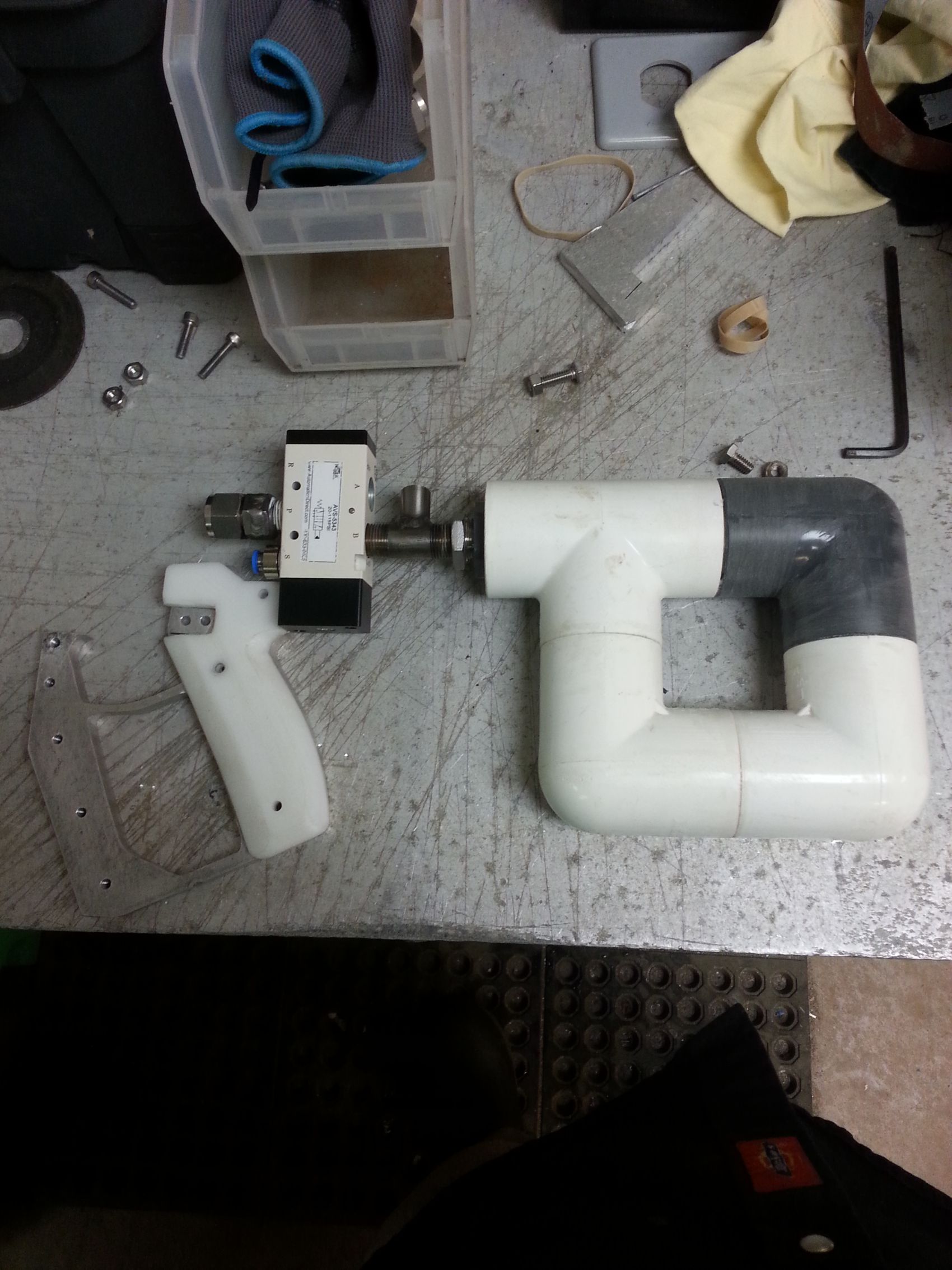

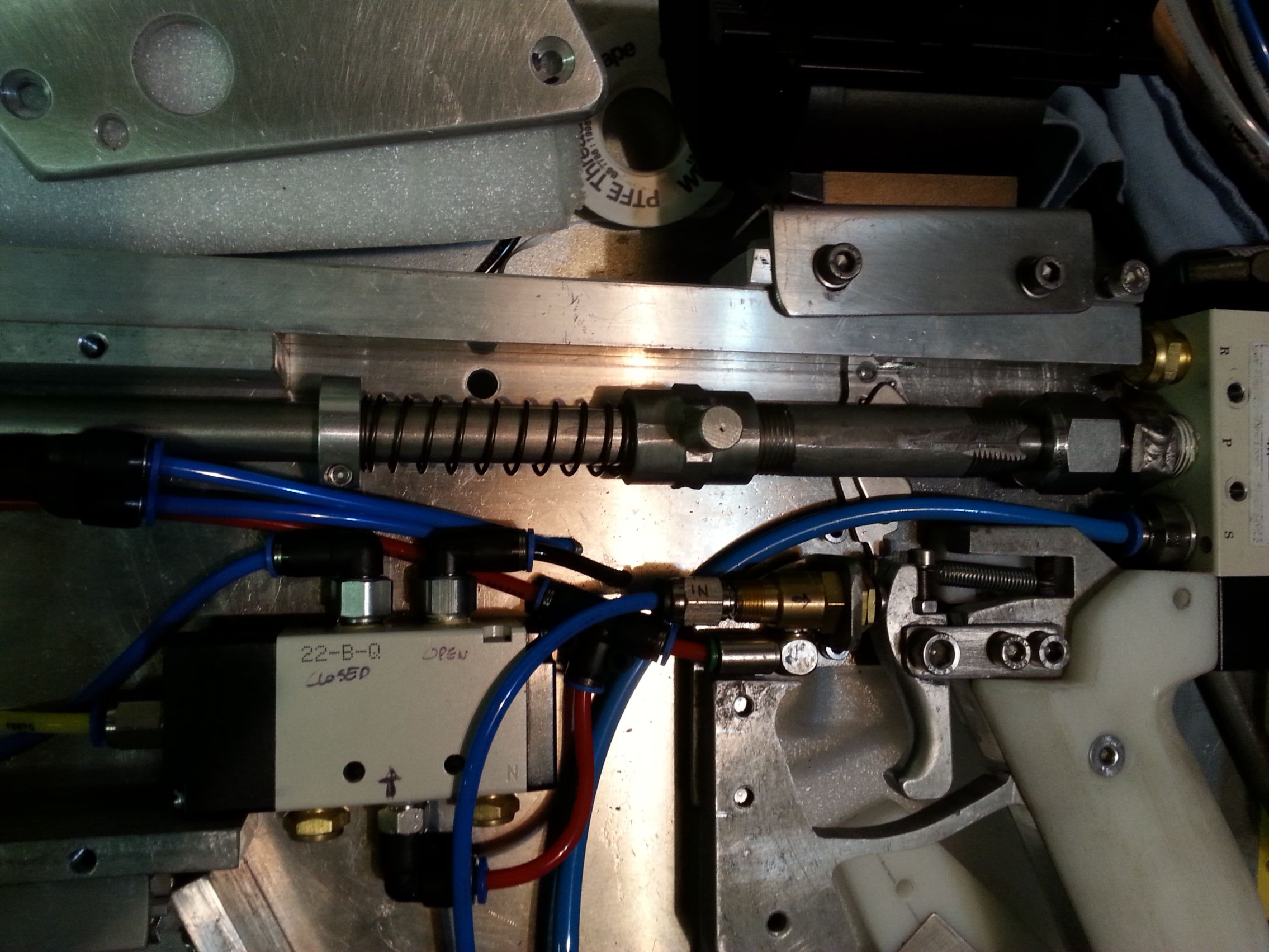

Time to call it finished, compressed air (135 psi) powered, 10mm ball bearing ammo, semi automatic, magazine holds 10 + 1 in ready. The stock is the chamber (1 1/2" pvc), barrel is 1/2" OD seamless stainless tubing (10.2mm ID) 700mm long. Main valve (3/8) is controlled by pilot valve (1/8) pulse, this pulse can be adjusted by the air restrictor to give different times/power. Valves are pilot air actuated 5/2 spring return, but had to add external pilot air to main valve as I was feeding it through an exhaust port not the P port. :shock:
Mostly made from scrap aluminium/stainless/pvc, about 200hrs+ work, hand tools and a drill press only, couple of the fittings were Tig welded, but only because I didn't want to buy anything for it. Front grip is a grinder handle :idea:
It is 1070mm/42" overall length, 6.4kg/14lbs in weight.

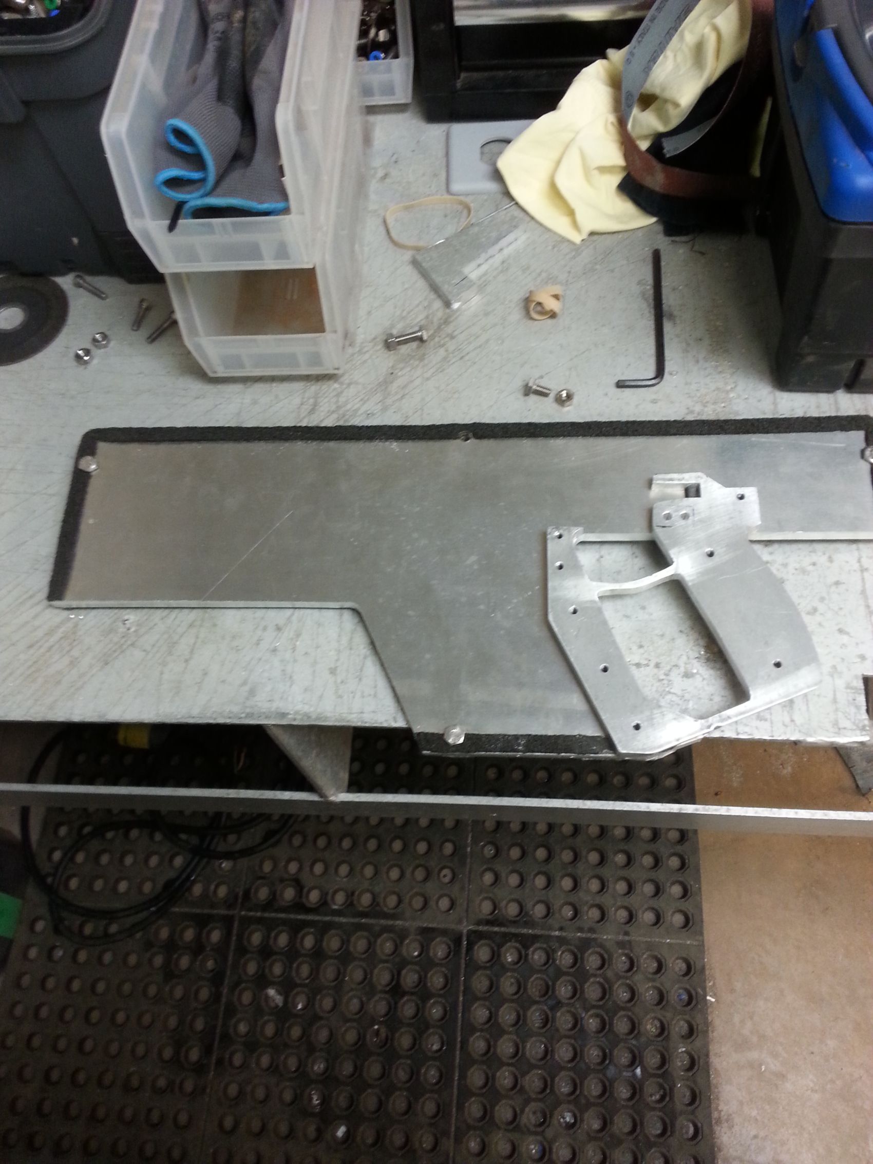

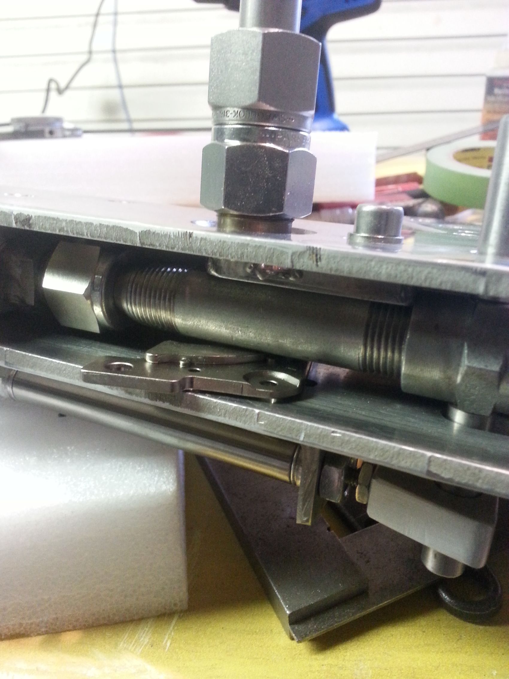

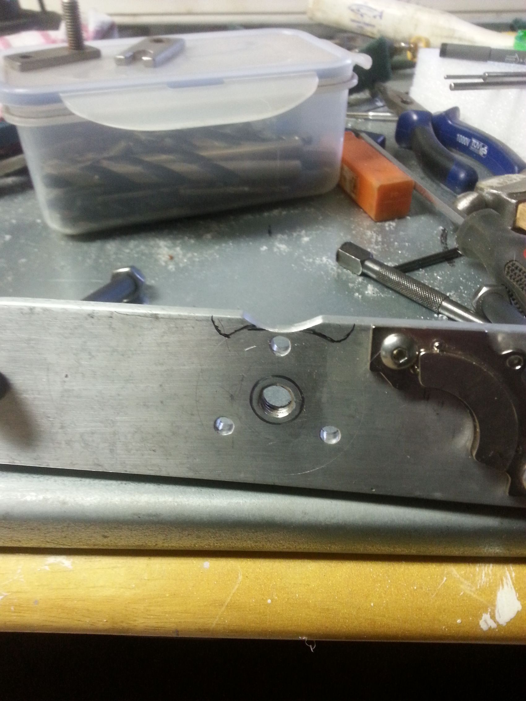

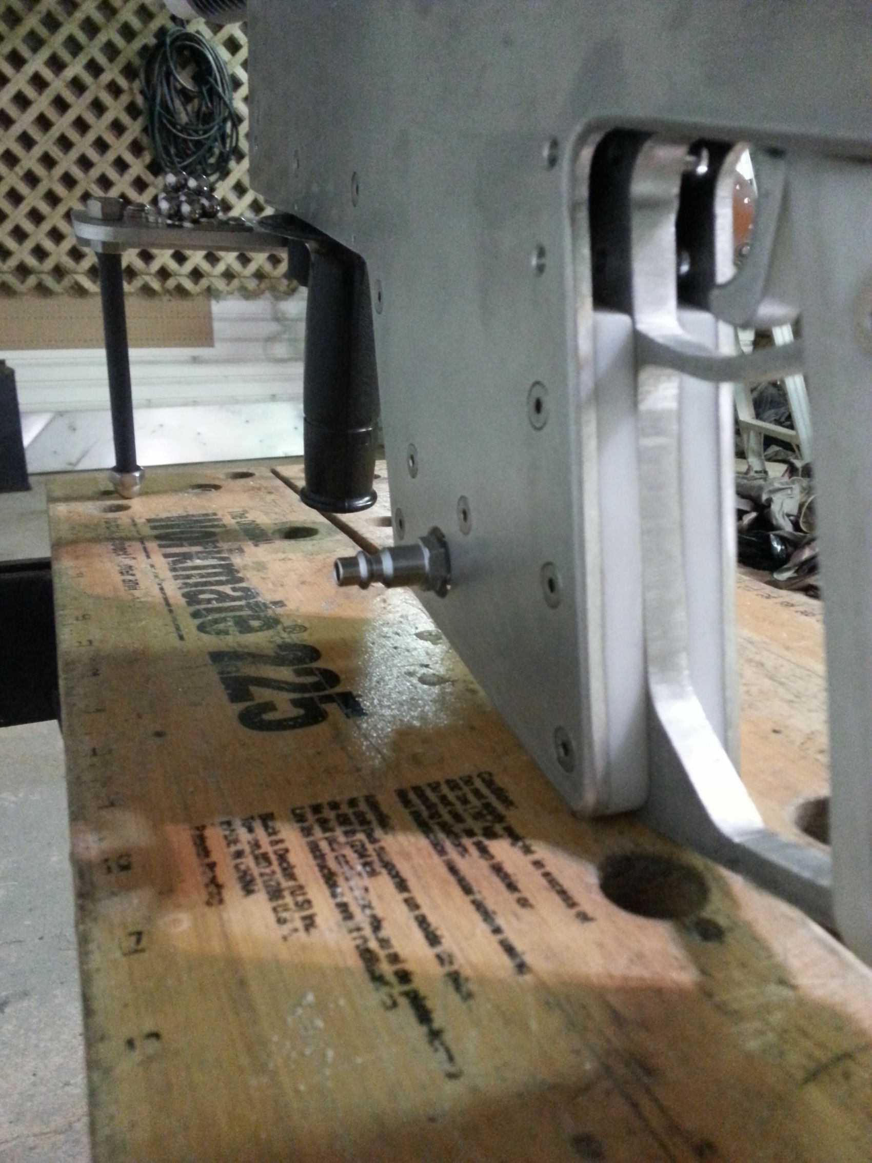

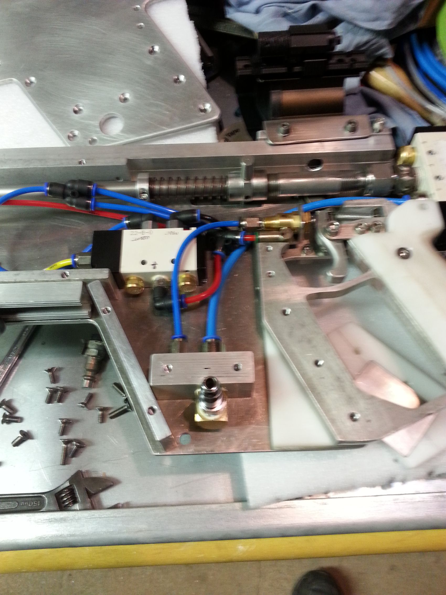

Adding some construction pictures cause I'm adding this link to Youtube. Also adding a video :D

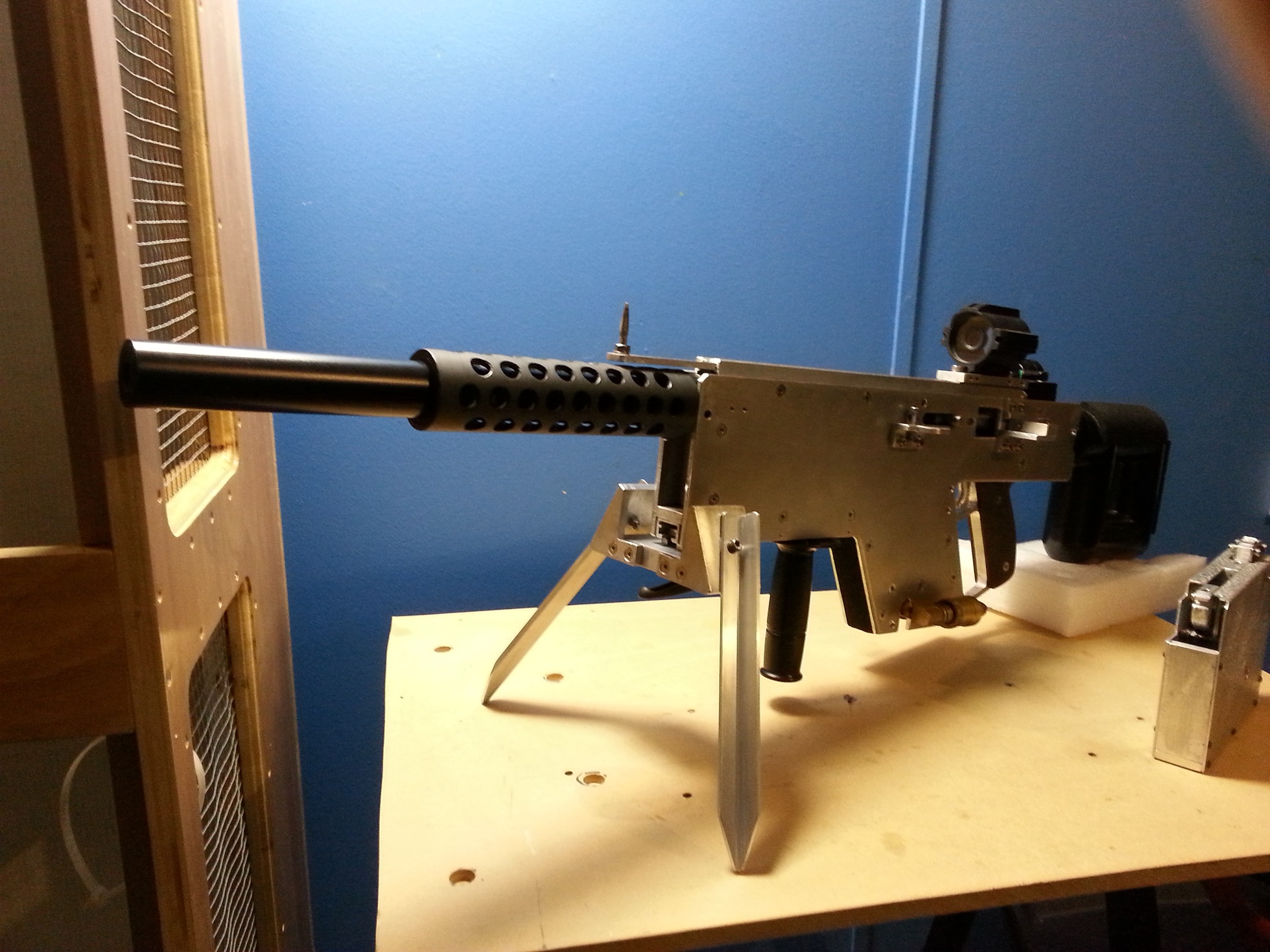

Still not sure about the bipod, I think it needs to pivot slightly, might work on that today. :idea:
That was easy, removed locknut and did a bit of filing to let it swing

Got the BFG out and gave it a Xmas paint job, brown grips and black barrel now 8)
Air2theBrain
Posts: 222
Wed Nov 15, 2017 4:16 am
Wow! 8)
Such a clean professional build, i noticed there is no qev but a pilot valve?
What are they like compared to a qev?
Love the workmanship, great inspiration thank you. :)

BFG uses a 3/8 air pilot valve about the same flow as a 1/4" QEV, it is a lot more bulky, I mainly used it because I already had it :o
This is my first QEV attempt, 3/8" chineasiem one of Ebay.

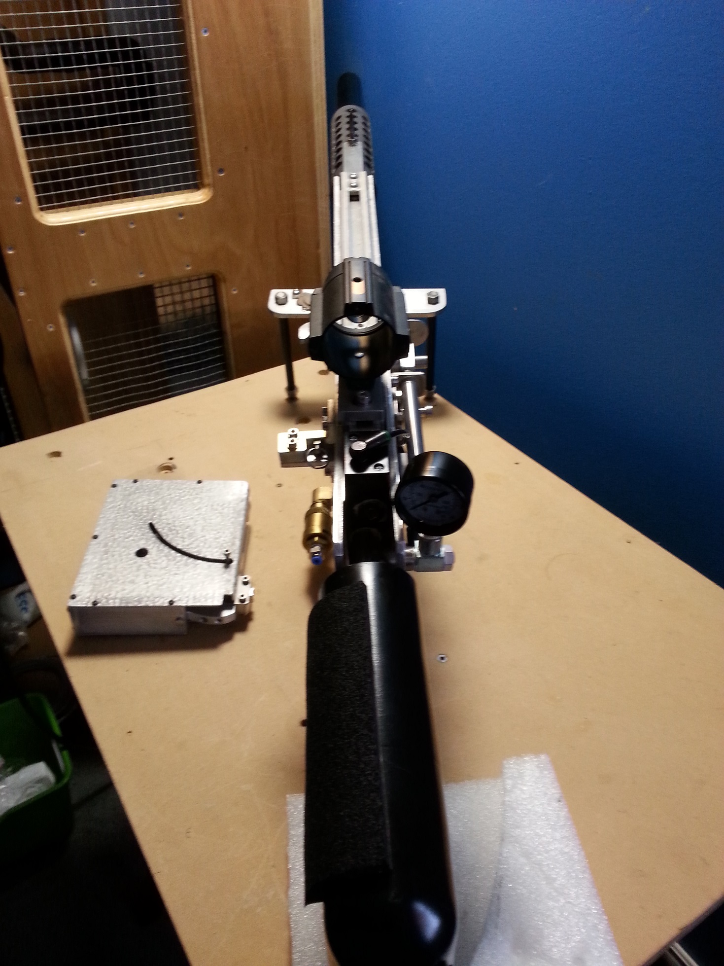

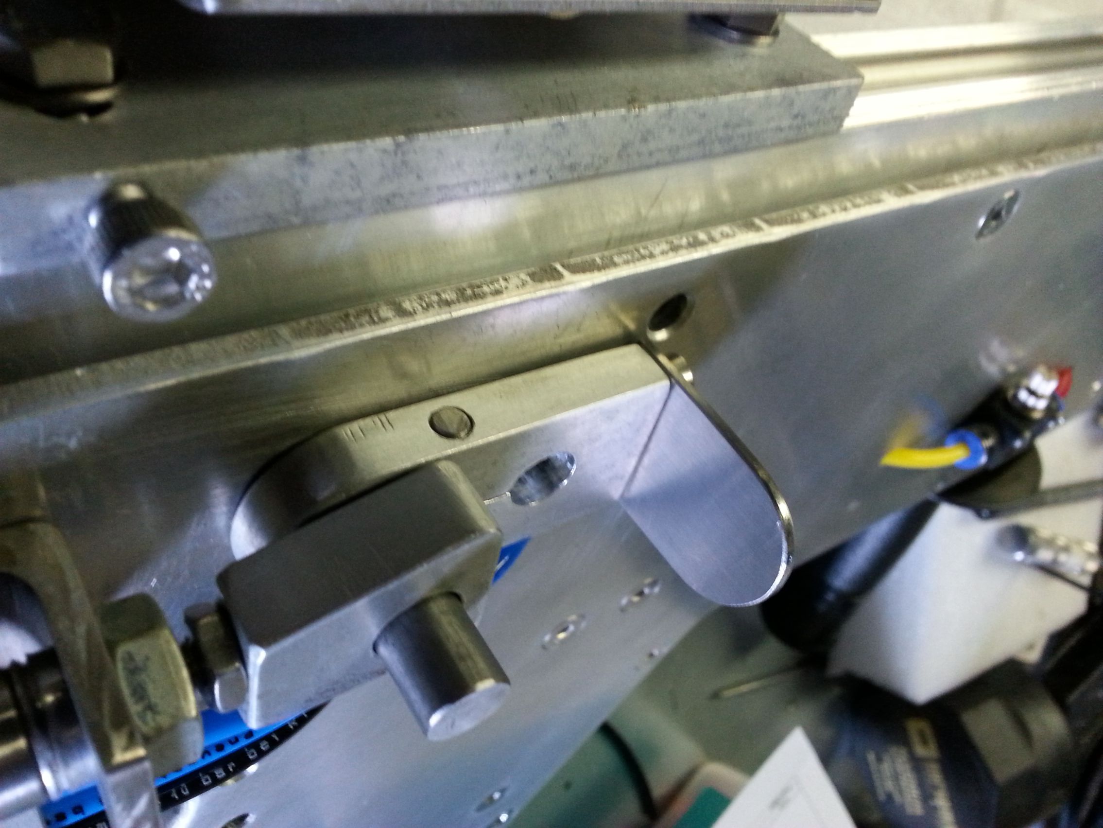

Finished the removable magazine :D
It hooks onto a pin at the front then pivots in and locks
New charge handle and shut off for loading cylinder to make it single shot
Now it's much slimmer with the magazine off
And I can check to see if it is loaded or not :D
