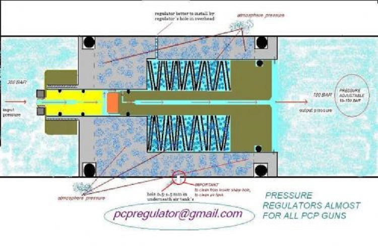

I have this drawing of a pressure regulator to share.
