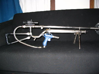

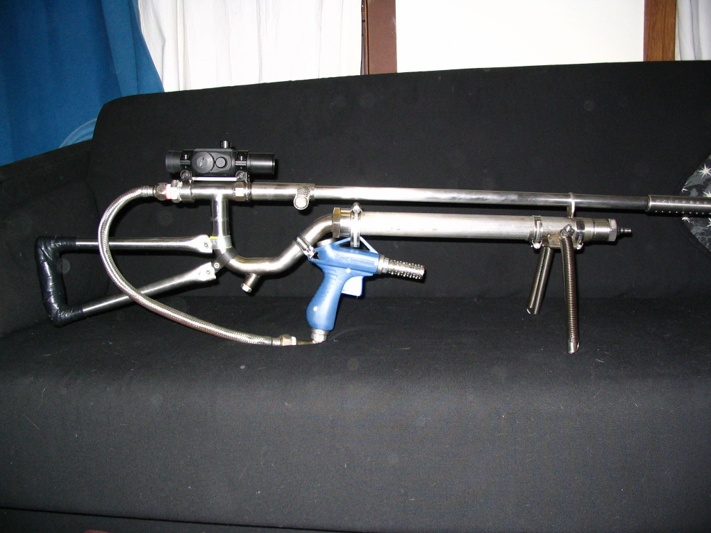

The S400 ~ By Chaos
Category: Pneumatic
Stats:
- Material: 316L grade stainless steel.
- Valve: Custom Barrel Sealing piston
- Operating Pressure: 10psi-400psi.
- Loading: Revolving Bolt Breech.
- Barrel I-D: 16mm
- Barrel Length: 800mm
- Chamber I-D: 34mm
- Chamber volume: 389cm3
- Piston Housing I-D: 24.400mm (1")
- Pilot Valve: Modified SMC High Flow Blowgun ($150AU a piece i got it for free)
Aesthetics:
- 100mm Muzzle Brake
- Walther 30mm Top point Red Green dot scope / custom rail.
- 470mm X 50mm silencer
- Harris Style retractable/detachable Bi-pod
- S/S Braided hose on pilot exhaust to blowgun
- Custom S/S mesh pilot muffler
Ammo:
- 16mm marbles 4g
GGDT Calculated Velocity @ 200psi: 238m/s (783fps)
- 5/8 lead fishing sinkers 12g
GGDT Calculated Velocity @200psi: 162m/s (532fps)
Pictures
The Gun Itself

Wow, that gun looks amazing. I absolutely love the Stainless Steel look. Really makes me wanna try to make me a sniper. Great gun.

I can't help but to think that this looks exactly like the SSS. Regardless, it is still a really cool looking sniper. Keep up the good work :thumbup:

hmm ok, well i did kinda expect that with the pics i took *exact same background, its made of the same color material*
yer i get ya pont, but i must say this packs a bit more punch than *ye olde Triple S*.

lol i was about to say the same, it does look like the SSS. Anyways i know it aint because the video has the rifle without the scope attached.
Nice gun, its too bad us metal smoothbores dont really have any consistently accurate ammo to fire with.

Thats a very good looking gun, but its a shame about the blue plastic blowgun as i think it spoils it, you should have used a metal blowgun.
i Assure you sir it is only plastic on the outside http://stevenengineering.com/Tech_Suppo ... 0PCVMG.pdf
