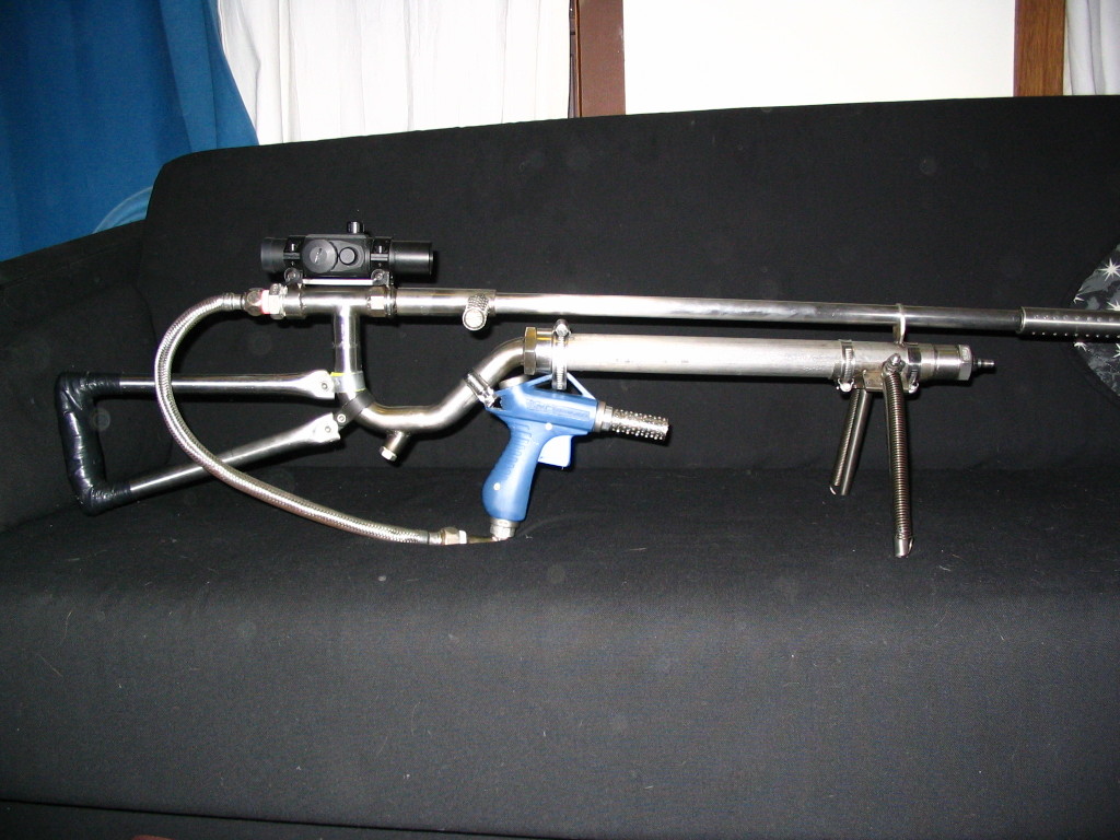

			The S400  ~
By Chaos
Category:  Pneumatic
Stats: - Material: 316L grade stainless steel.
- Valve: Custom Barrel Sealing piston
- Operating Pressure: 10psi-400psi.
- Loading: Revolving Bolt Breech.
- Barrel I-D: 16mm
- Barrel Length:  800mm
- Chamber I-D: 34mm
- Chamber volume:  389cm3
- Piston Housing I-D:  24.400mm (1")
- Pilot Valve: Modified SMC High Flow Blowgun ($150AU a piece i got it for free)
Aesthetics:  - 100mm Muzzle Brake - Walther 30mm Top point Red Green dot scope / custom rail. - 470mm X 50mm silencer - Harris Style retractable/detachable Bi-pod - S/S Braided hose on pilot exhaust to blowgun - Custom S/S mesh pilot muffler Ammo: - 16mm marbles 4g
   GGDT Calculated Velocity @ 200psi:  238m/s (783fps) - 5/8 lead fishing sinkers 12g
   GGDT Calculated Velocity @200psi:  162m/s (532fps)Pictures The Gun Itself Videos

			Wow, that gun looks amazing. I absolutely love the Stainless Steel look. Really makes me wanna try to make me a sniper. Great gun.

			I can't help but to think that this looks exactly like the SSS. Regardless, it is still a really cool looking sniper. Keep up the good work :thumbup:

			hmm ok, well i did kinda expect that with the pics i took *exact same background, its made of the same color material*

			lol i was about to say the same, it does look like the SSS. Anyways i know it aint because the video has the rifle without the scope attached.

			Thats a very good looking gun, but its a shame about the blue plastic blowgun as i think it spoils it, you should have used a metal blowgun.

			This is kinda a random question, but did you machine all your pieces or is just shiny store bought stuff?

			bboymatty wrote: lol i was about to say the same, it does look like the SSS. Anyways i know it aint because the video has the rifle without the scope attached.consistently accurate ammo to fire with .
meh i find that hard to believe, marbles are pretty damn accurate.
i Assure you sir it is only plastic on the outside
http://stevenengineering.com/Tech_Suppo ... 0PCVMG.pdf
awsome, but why on earth would you shoot in your house?
yer i did it coz it was dark outside, yer 3-4 bb's went into the couch lol there plastic at 40psi.
i diddnt spend a cent on this gun, nothing is machined.

			Very nice cannon here.... could you possibly make a list of all of the differences between the S400 and the Triple S?
