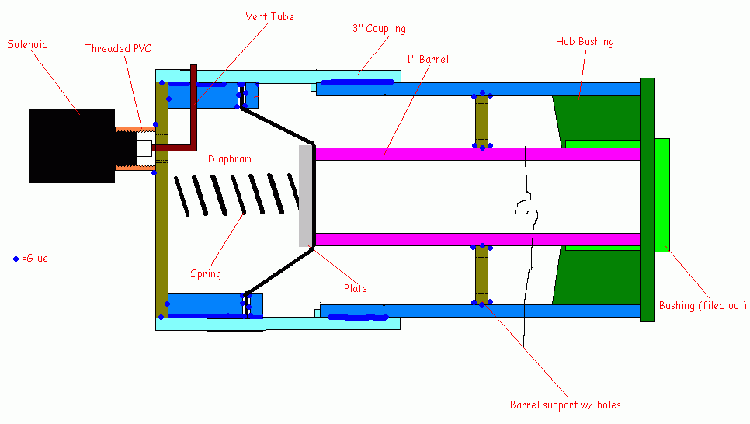

This is the old diagram I used to build the KingPin.

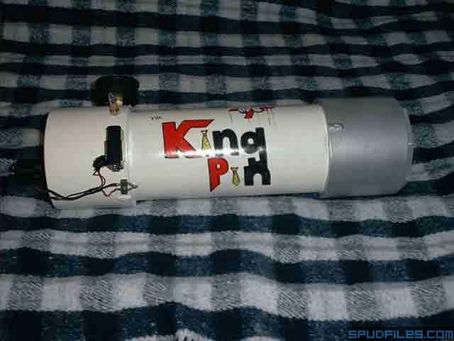

Side view of KingPin and all her accessories. From top to bottom you can see the pressure gauge, Schrader valve, battery, and contacts. I made the contacts myself, two pieces of metal that were normally closed until a thin piece of plastic was slid between them. The plastic was tied to the trip wire so when the wire was tripped the plastic would pull out and complete the circuit.

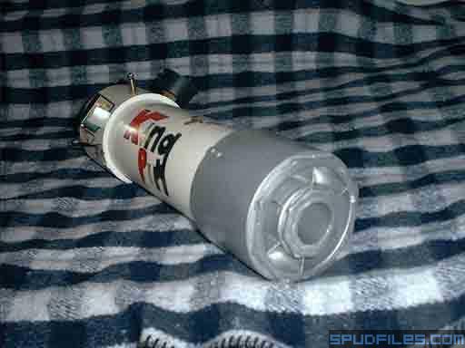

Nothing special here, front view of KingPin, 1.5&amp;quot; barrel.
Nothing special here, front view of KingPin, 1.5&quot; barrel.

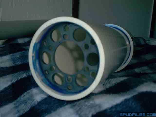

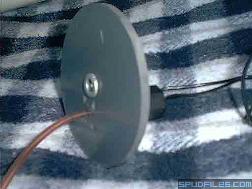

Picture of the back plate as seen from the inside. The washer glued in the middle is to hold the spring in place. That's the pink vent tube going into the solenoid housing with two hole (above and below the vent tube) to equalize the solenoid housing.

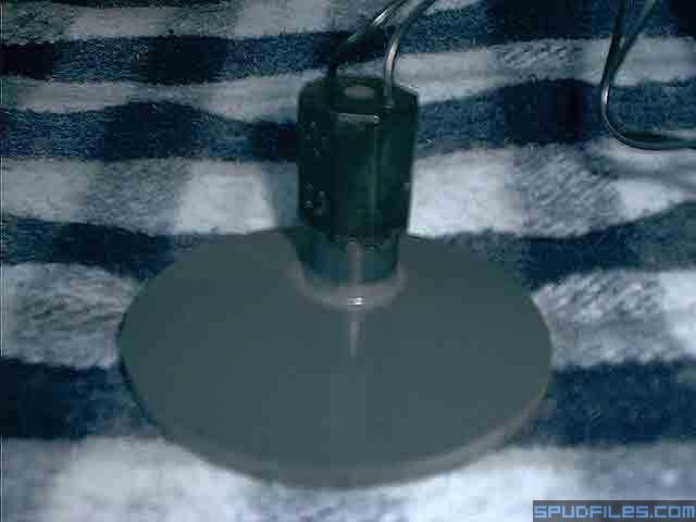

Here's the other side of the back plate. Kind of cheap construction now that I think about it, but the solenoid housing was a piece of 3/4&amp;quot; such 80 I think, it was held onto the back plate by 4 metal pins and some JB Weld. What was I thinking!
Here's the other side of the back plate. Kind of cheap construction now that I think about it, but the solenoid housing was a piece of 3/4&quot; such 80 I think, it was held onto the back plate by 4 metal pins and some JB Weld. What was I thinking!

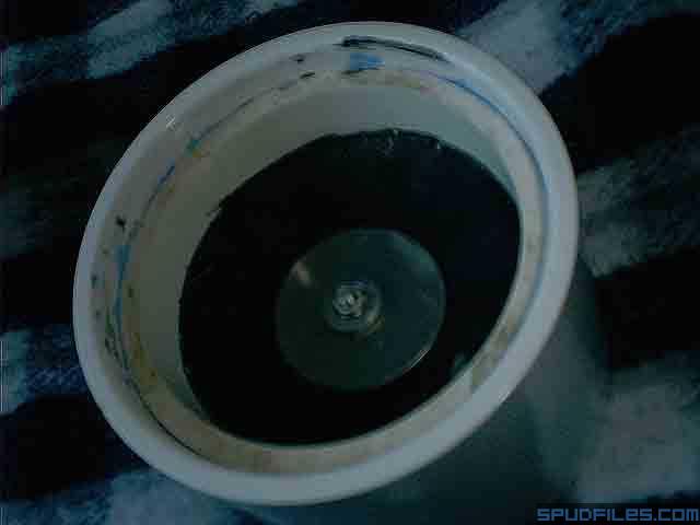

Now this is old school. 4&amp;quot; homemade diaphragm! It's nothing very complicated, just a real pain in the ass building! The back plate rests on that inner piece of 4&amp;quot; pipe.
Now this is old school. 4&quot; homemade diaphragm! It's nothing very complicated, just a real pain in the ass building! The back plate rests on that inner piece of 4&quot; pipe.

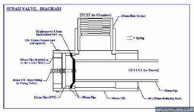

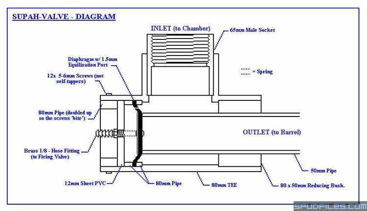

I wish I could give credit to the designer of the home made diaphragm but I can't remember his name or his web site. But here it is if you ever feel like making one. You can always shoot me an email too, I've made 3 of these quite successfully.<br /><br />That's all I have for now. Thanks for checking out an old relic!
