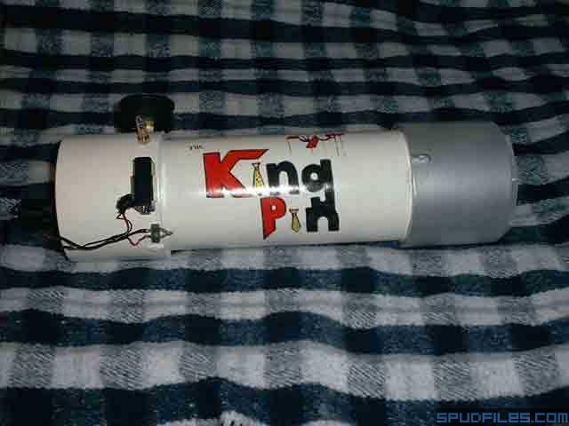

This is one of my favorites, just for the sheer joy of doing something different I came up with the KingPin.
It's built around a home made diaphragm and utilizes a normal sprinkler solenoid to actuate it. I went with a sprinkler solenoid because the KingPin was designed to be trip wire activated.
The vent tube was way too small, it fired with an insanely loud honk! We must have laughed about that for a good half hour.
KingPin was retired after the solenoid holder cracked under the pressure. Here's some previously unreleased photos of it's construction.

- This is the old diagram I used to build the KingPin.
- KingPin.gif (9.44 KiB) Viewed 8333 times
- Side view of KingPin and all her accessories. From top to bottom you can see the pressure gauge, Schrader valve, battery, and contacts. I made the contacts myself, two pieces of metal that were normally closed until a thin piece of plastic was slid between them. The plastic was tied to the trip wire so when the wire was tripped the plastic would pull out and complete the circuit.
- Now this is old school. 4" homemade diaphragm! It's nothing very complicated, just a real pain in the ass building! The back plate rests on that inner piece of 4" pipe.
- KPdiaphram.jpg (15.98 KiB) Viewed 8333 times
- The barrel support inside the 4" chamber.
- KPsupport.jpg (18.58 KiB) Viewed 8333 times
- I wish I could give credit to the designer of the home made diaphragm but I can't remember his name or his web site. But here it is if you ever feel like making one. You can always shoot me an email too, I've made 3 of these quite successfully.
That's all I have for now. Thanks for checking out an old relic!

real nice construction, how big is it?

yea, I like the whole thing except for the solenoid actuation, I'm still confused by it, explain
