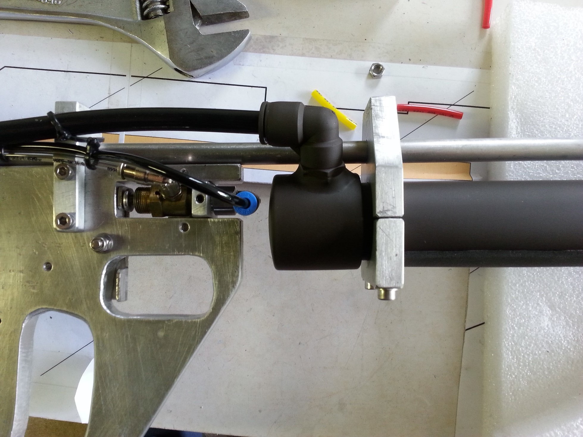

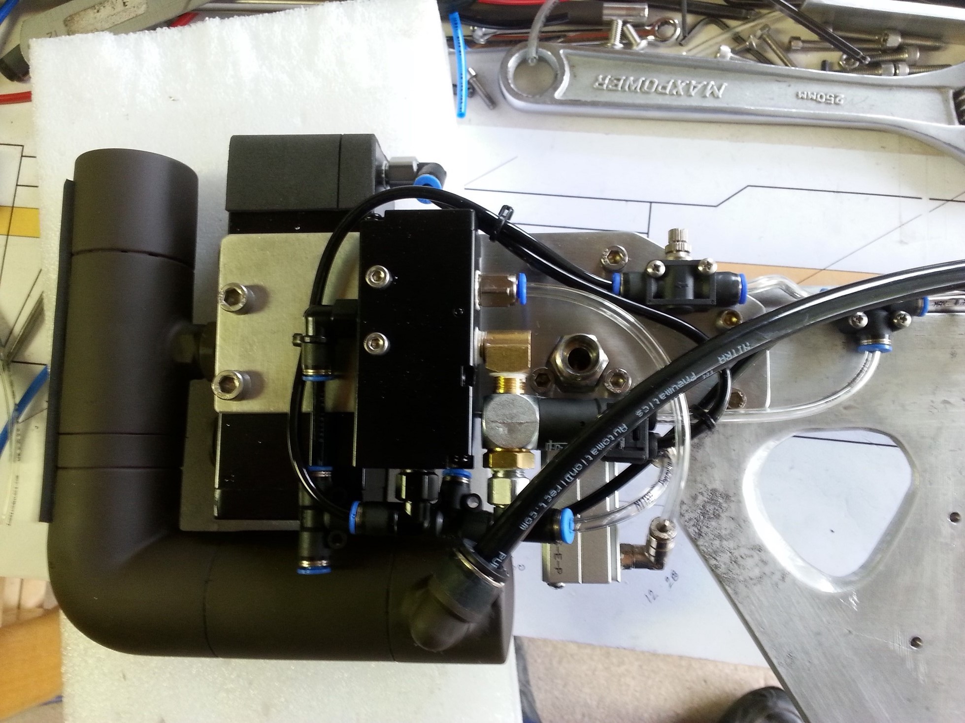

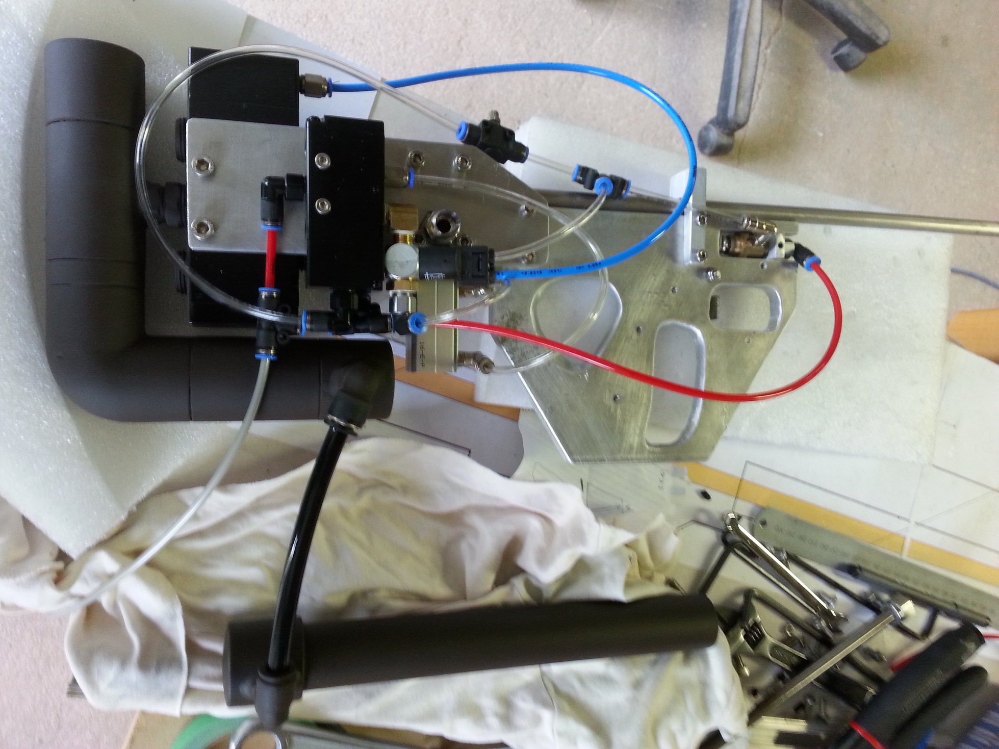

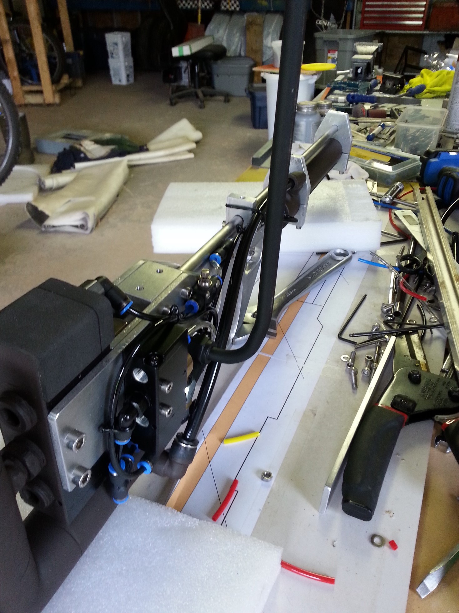

Got enough parts assembled to test fire, the small cylinder will do the reload, magazine tube tube attaches to the threaded fitting on the side.

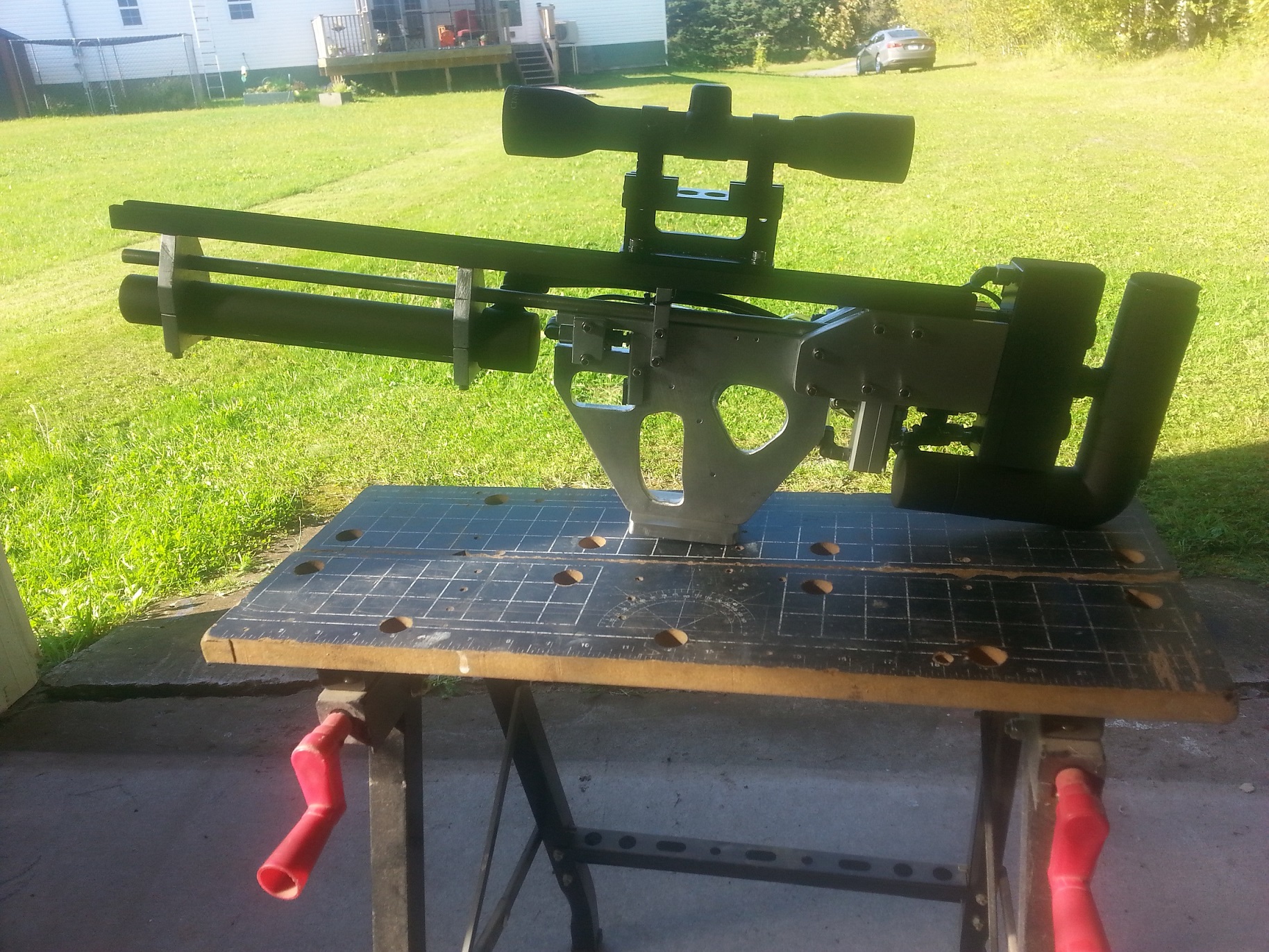

tidied it up a bit, still got to make nylon grip pads, palm rest & attach the mounting rail for the scope and bipod.

Shaping up nicely! It's odd though to see that lovely metalwork juxtaposed with PVC pressure chambers.

It's called 'Art' and I did paint the pvc brown :D

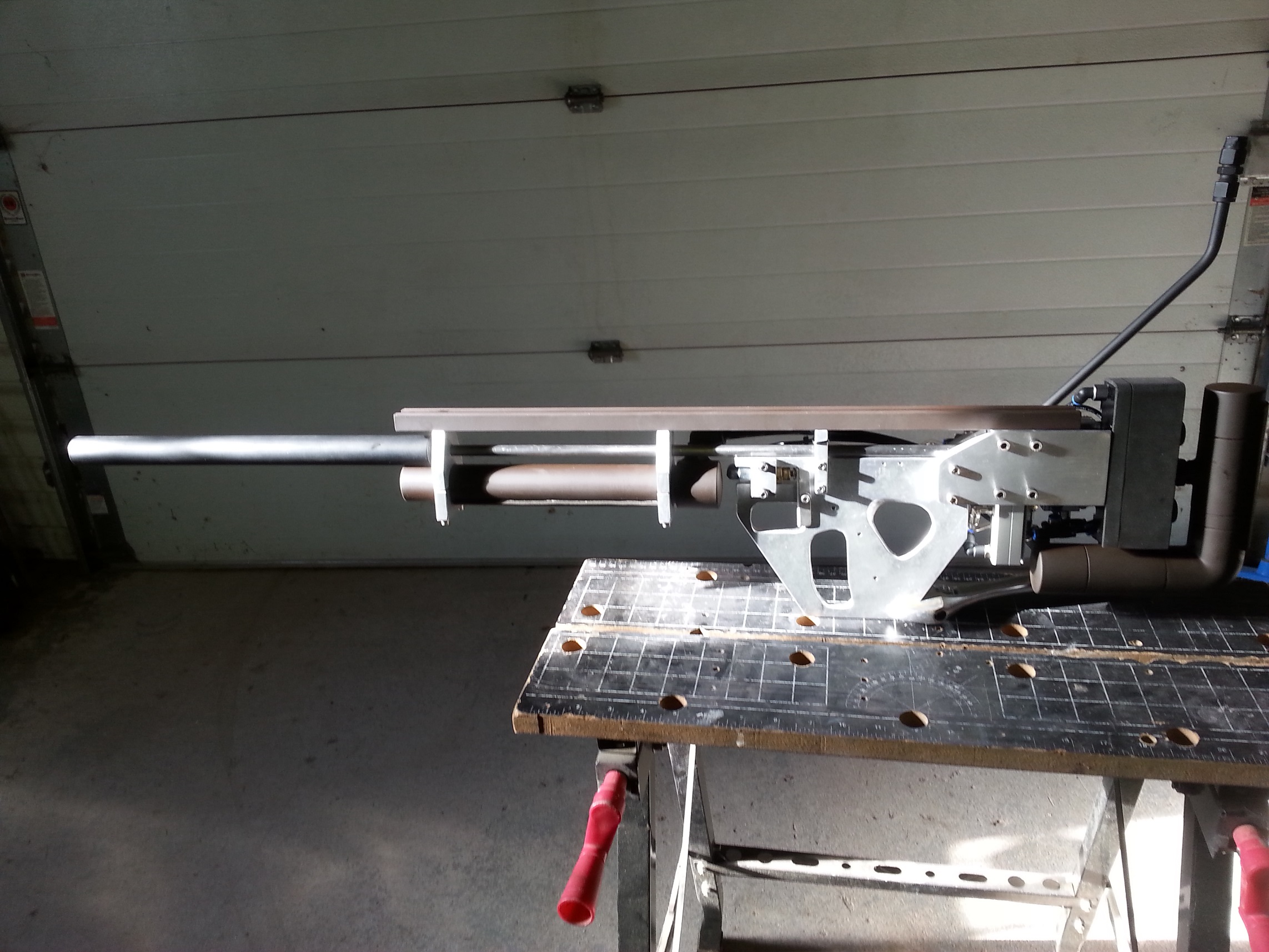

Did some actual firing at 140psi, no sights yet. Extension takes barrel from 500 to 800mm, still has some kick with it on.

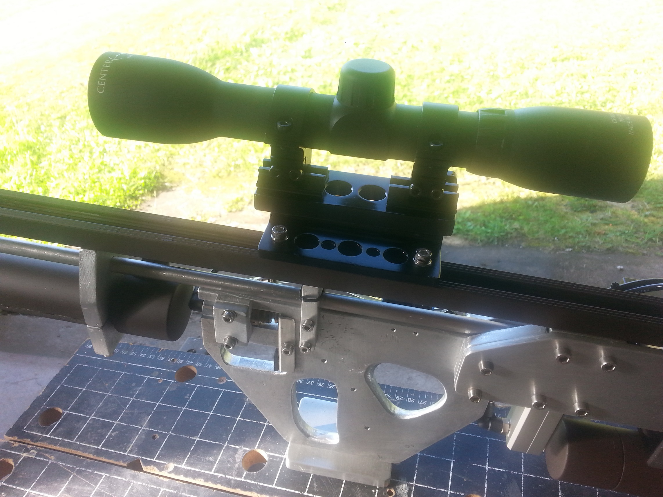

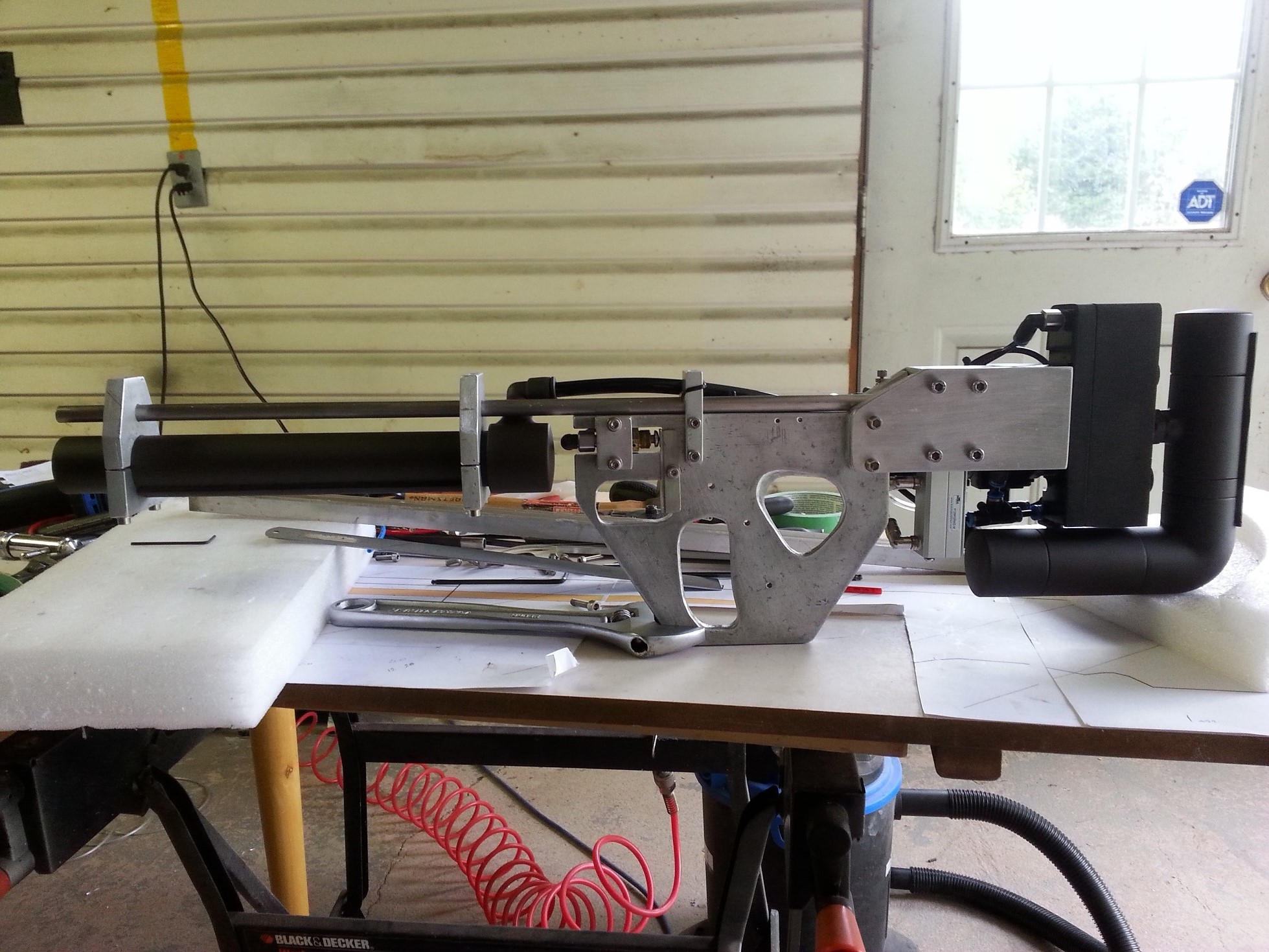

Scope mount finished.

This job looks great! I really like the look. Waiting for video test shot, with telescopic sight. :)

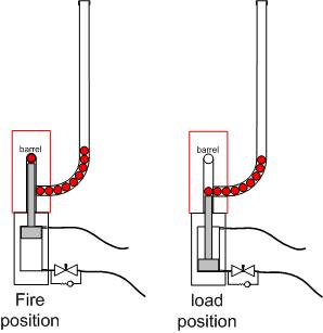

Dropped the scope about 10mm and moved forward 20mm.
One problem I discovered was double feeding, especially when the ammo tube was full, I guess the extra weight was the cause. When fired, some air leaks into the ammo tube and shoots the BBs up, (you can hear them rattle) and because the reload cylinder opened the instant the main valve closed the BBs were managing to feed 2 instead of 1. I put an exhaust restrictor on the reload cylinder to slow it's opening and make sure the BBs have settled before it opens the port. It slows the reload cycle time slightly but does seem to stop the double feed.
This is how it works inside
