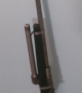

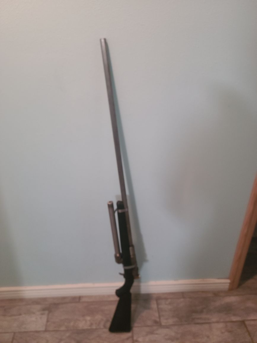

I just want to note that a proper weld joint is MUCH stronger than any threaded arrangement. Note only that but a proper weld is stronger than the base metal in most cases. The primary concern is most certainly HAZ and proper execution. The chamber on my air rifle is a section of 3/4 hydraulic pipe that i chopped one end off and tig welded the head of a grade 8 bolt in the end. If you trust your ability you will be fine.

may share a photo, is it stainless ?

Wed Dec 30, 2020 8:36 am
I dont know if you can make it out properly but this is a picture I have on hand.
The pipe is stainless, I am not sure what alloy...
Works fine for me. I have been up to 3500 so far. I did not do a hydrostatic test.
