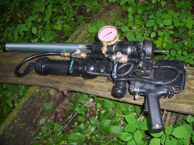

Upgraded Valve
This upgrade of my original piston-valved hybrid uses a more efficient, all-steel(ok, so the piston itself is aluminum) barrel sealing piston valve. I've also added an extra port on the end cap for attaching a pop-off valve for easier piston opening, or a high-flow blowgun for pneumatic use. The current pictures show a pressure gauge on this port.
Compacted design
I've reduced the somewhat bulky rectangular look of the last version to a more thin, riotgun-like look.
The entire gun (minus the barrel) can be broken down reasonably quickly to fit in a shoe box.
The propane meter has also been compacted considerably from before.
Better meter
Finally, a propane meter that doesn't leak. Leaking propane has been sort of a curse for me, as there is no way I'm going to give anyone $20 for a $1 tank adaptor fitting. I eventually found an antique(literally) propane/oxy torch and salvaged the usable parts from it.
New handle/stock
New, sturdy grip salvaged from a mig welder. After fighting the spaghetti monster for a while, I got the wiring reloaded into something actually designed for hv. The old hand grip was a spray can gun with a psu power switch hot glued into it. The bad thing about the old version was if you got your hand too close to the charging switch wires when firing, it would arc out of the trigger and into your hand.

Ignition
For Ignition I used a camera flashboard and capacitor dumped into a (motorcycle?) ignition coil. The wiring and circuitry is contained within the handle, and the coil and battery are packed neatly above. All the external wiring is inside uber SciFi-looking wire jackets from and old car.
The output voltage is around 35KV (estimated from jump distance).
Construction Materials
The chamber is black iron, and the fittings are all steel(one is brass though). The barrel is also galvanized steel and can be changed in seconds. I'm planning on a breech loading system soon.

Even from the beginning, I never expected this gun to work, as I have never trusted my engineering skills with any task more complex than a ball-valve gun. It was constructed for around $40 usd, with most of that being for the large pipe fittings. The first parts were purchased around January (07) and the first real testing was only days ago (6-29-07).

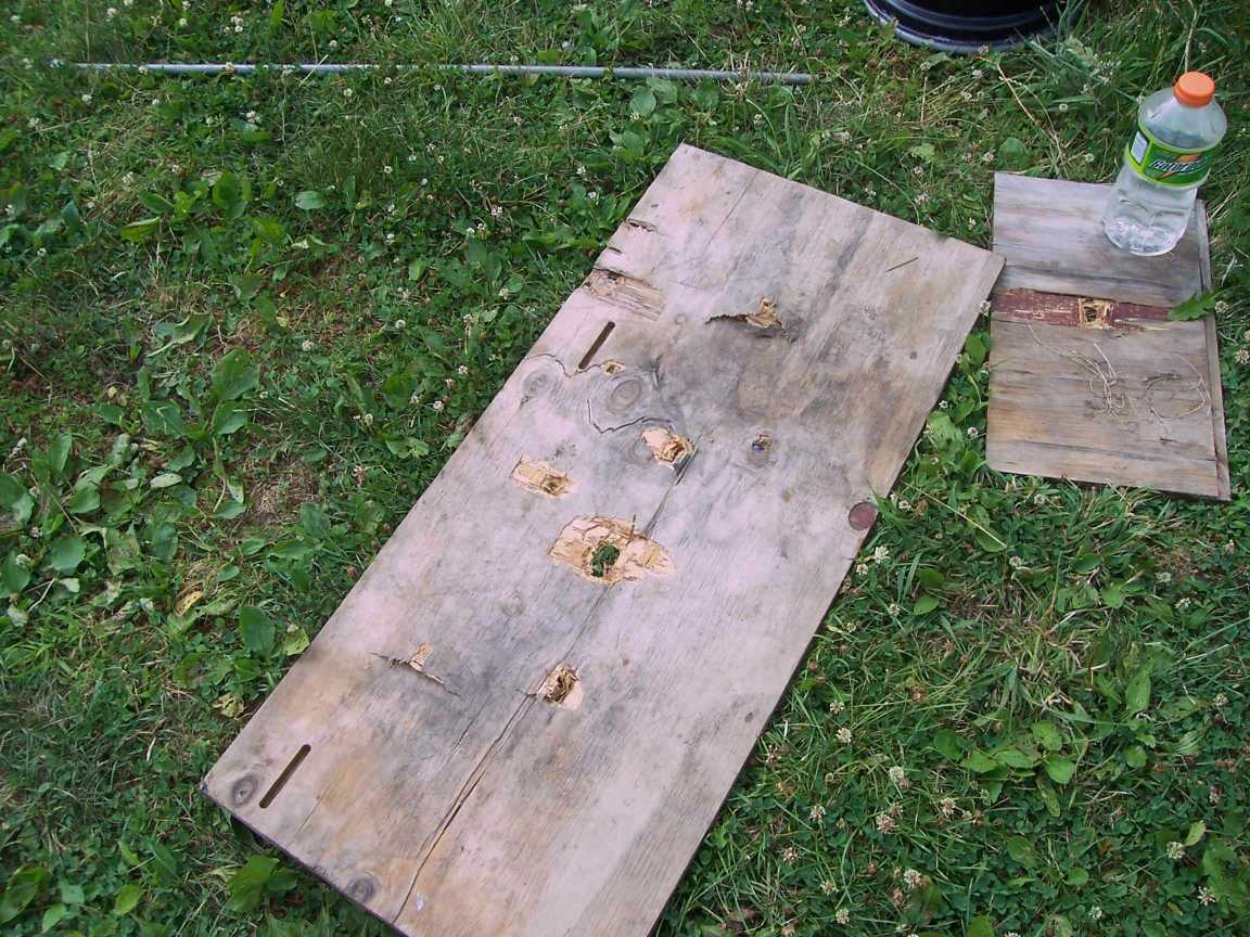

The damage shots I've done are fairly impressive. Bricks get shattered. Plywood gets pwned. Sheet metal is roughly equivalent to tissue paper.
