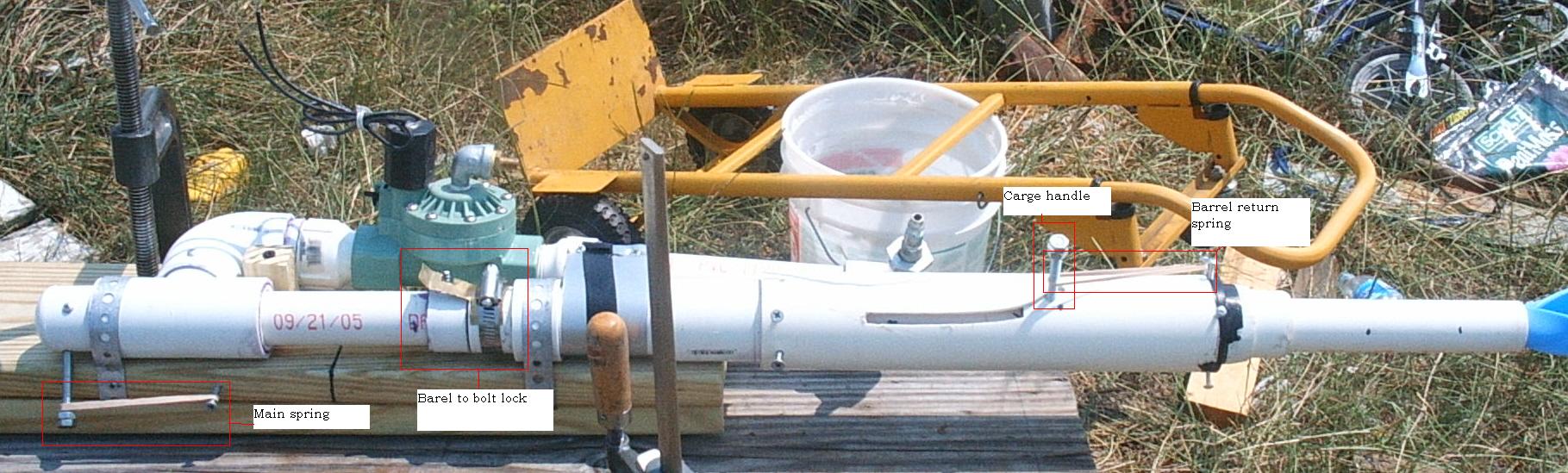

And now the prototype G.A.R., here’s a large view of the prototype with labels to explain it.

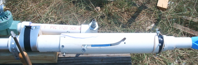

Close up of the charge handle and barrel guide.

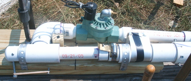

Close up of the bolt and the bolt to breach lock.

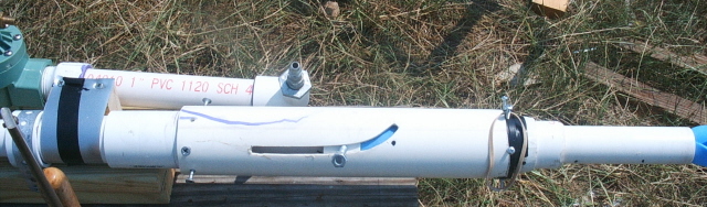

Barrel halfway through recoil.
Bolt halfway through recoil, bolt is now unlocked from barrel.
Barrel all the way back.
Bolt all the way back.
Next two pictures are close-ups of the bolt to breach lock.

It looks good on paper but I have my doubts as to how much bleeding from the barrel will work at spudgun pressures. Firearms that use this system typically generate at least 30,000 psi, nowhere near spudgun pressures.
For this to work well you're going to need a large chamber volume, high flow valve and a sufficiently long barrel to retain the pressure long enough to allow the piston to work. Remember, you've increased the area availiable for the air to work on but you've also added to the weight of the bolt.
From_Hamsterdam
Posts: 110
Joined: Thu Feb 15, 2007 8:26 pm
Sat Aug 18, 2007 10:16 pm
if i were you i would take out the holes that vent to the atmosphere in the recoil thingy. This would be more efficient because you probably loose enough pressure out the barrel.
you already have a large recoil piston so you will not need as much pressure because it is acting over a larger area.
remember psi= pounds per square inch
like jack mentioned you should improve the barrel length, chamber size and add a better valve.
Reduce the weight and friction of any moving parts as much as possible.
it may also help to use heavier ammo with a tighter fit or go up to a higher pressures.

After looking over my plans (which are mostly still in my head) I realized that the gas cylinder on the GAR 1 was made wrong, if you look at the pictures of the charge handle/barrel guide area that grove is in the cylinder, between that grove, and the utter lack of seals, the gas cylinder might as well not be there and just have a ported barrel. This is what happens when you rush perfection…
Do I try and make the GAR1 work or do I just go strait to the finished product, a 1.50cal auto-cannon?
With the 1.50cal I could use a solid lead slug if need be to get the recoil part to work, plus with NERF footballs, which fit really tight, they will create a good gas seal which gives the gas system a better chance of working, plus when I shoot NERFs out of my Bazooka I can feel the recoil.
But all have to buy a lot of stuff, and if it doesn’t work it’s all that money down the drain.
If I just fix the GAR 1 it’ll save money, but for all the work, am I just polishing a turd?
