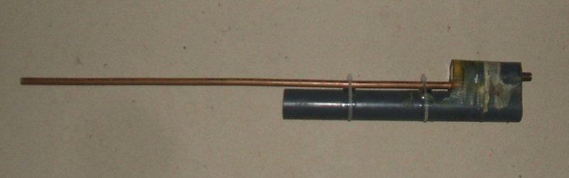

Windshrike's comment here reminded me of a little project I had made a while ago to see the effects of high pressure in a BBMG. Since my only pressure source was a shock pump, I had relatively small chamber (that still takes me about 2 minutes of hard pumping to take to 400 psi) and used a piston valve built in the same way as my mini designs with an epoxy piston in a syringe tube.
It looks ghetto, I know, especially around the breech area, because it's been cut up and rebuilt many times - currently fitted with a 4.5mm I/D barrel for steel BBs, 15.5 inches long - but originally it had a 6mm airsoft barrel. With the current barrel it shoots an average of about 650 feet per second with BBs but is only good for a 5 round burst. as you can see from the damage pic, that's enough to embed BBs to a little more than their own width into a wooden plank.

A "normal" BBMG (ie using typical compressor pressures of 100-120 psi) will succeed in chewing through a similar target, but in this case the effect is achieved using much less ammunition. A single BB at 650 feet per second is enough to fully penetrate 2 soup tins side by side and emerge with enough energy to dent a third can. Single shots from a vortex block BBMG at 110 psi will only dent the first tin. Note also in the second and third videos that you can distinctly recognise the individual exit holes of each individual BB as opposed to the "tear" from the action of many BBs at lower velocity.

however cool it may be, i dont think it would be much fun unless you find a better way to get alot of pressure.
the design itself is very interesting and i really like the gun, i dont think ive seen anything like it before.

Very nice would you still call it a bbmg though even though it is 5 round bursts. Id agree it is pretty ghetto but still nice. This shoots kind of like a shot gun right. Correct me if im wrong. But it is cool though

Pretty much why I forgot about it - now if only I could hook up a reg to my SCUBA tank, hmmm...i dont think it would be much fun unless you find a better way to get alot of pressure.
Yes, but without the need for messy sabots and waddingThis shoots kind of like a shot gun right

No, the chamber holds about 20 BBs and there's an o-ring between the chamber and the barrel which is a little tight, meaning that below a certain pressure, the BB won't fire, which is why it's limited to 5 rounds per shot. It's having to pump it back up to pressure which is female lady dog of the opposite sexgoose_man wrote:Really neat concept! Do you have to reload five more bb's each time you fire?
