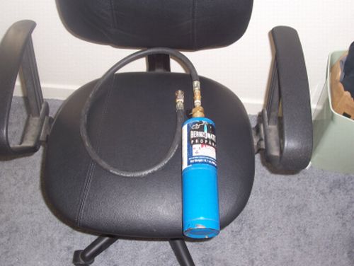

Yeah the 3' 4" chamber is way too big mine is 2' 4" chamber and I have a 7' golf ball barrel and it is like .9 to 1 cb ratio i think for yours i'd go down to like 18 inches long. as far as your meter i'd go metal or here is my meter that works awesome
- Propane Meter
- Propane Meter.JPG (32.76 KiB) Viewed 4478 times

i kno this question is very noobish but considering i have never made an advanced combustion or a combustion in general, the guage on the propane meter is just a regular guage. And to meter your propane, you simply open the ball vavle and that lets in the propane and you fill until you are at a certain psi. Then close the ball valve, then open the other one and that lets in the propane you just metered into your chamber.
