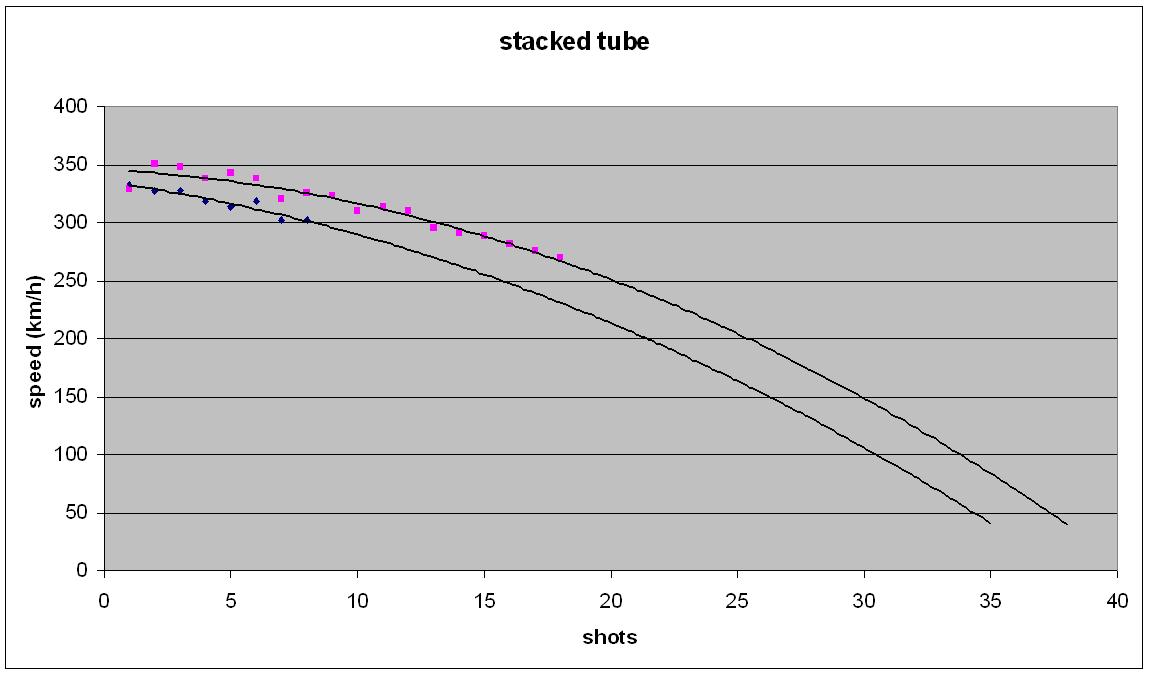

Techincally, as you shoot, the pressure goes down (meaning less power) but the resistance on the valve is also less, meaning it opens for longer (more power) so there should be a reasonable level of consistency.
Thats exactly correct. As thought I have done measurements of speed decrease over shots, and it does go down eventhough the dwell times go up. I guess bc the barrel has a certain length and a longer dwell time has no effect. I have this graph here of the stacked tube airgun (check attachment). I am not sure what bottle I used on this test though, 0.5L or 1.5L I also did this test before I had a compressor so I dont know the pressures I used.jackssmirkingrevenge wrote:Techincally, as you shoot, the pressure goes down (meaning less power) but the resistance on the valve is also less, meaning it opens for longer (more power) so there should be a reasonable level of consistency.
