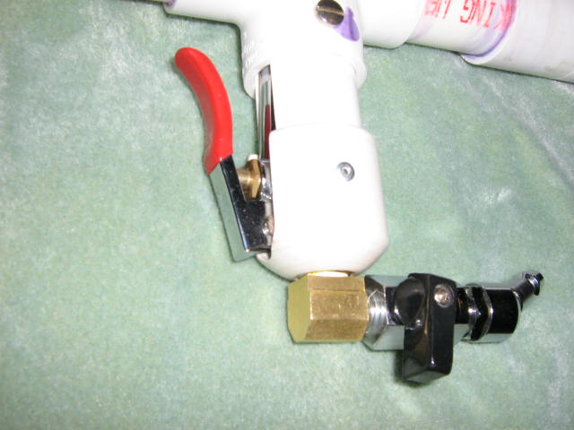

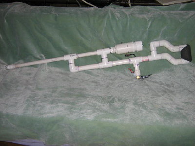

I've been wandering these forums for some years now and decided I would join the group. Reading every rule was more time consuming than some of my air cannon builds. Anyways down to business. I've built plenty of cannons and a joke of a vortex gun so I decided it was time to make a real vortex gun worthy of my time. I have yet to check the range or accuracy but both seem good, it's no sniper but it definitely beats an AEG. The barrel is 30 inches of break line, the vortex block was machined from aluminum bar with a one inch diameter through hole design that is half an inch thick. I have to give spuddin some credit, his MAC 10 gave me the basic idea and I ran with it. My BB well is the same size as his but where the barrel and chamber meet and how the vortex block connects is where I mixed things up. Too much machining though, mostly lathe work. The rate of fire is incredible to say the least and the entire gun can be broken down to have things replaced if need be. The valve in the grip fits like a dream and the barrel screws in solidly with a screw on fake barrel on top to protect and align it. You all want to see pictures so lets do that.

BBMG Fieldable Vortex Rifle
- Barrel sleeve and BB well connection.

- Close up of the muzzle.

Very nicely put together, deserves a lick of flat black - I wouldn't bother with the orange though, it will still look like a collection of plumbing fittings.

perhaps heat forming sheet pvc around the stock would help counteract thisit will still look like a collection of plumbing fittings.

nice ammo capacity looks low but seems like a decent field weapon, jut watch your bb chamber looks like it could get snapped off accidentally
daberno123, I thought about covering the back of the stock with a little something, I'm still thinking about it based on looks versus how easy is it to carry through the woods. It would keep from getting snagged thats for sure but would cut down the hand holds, the front will probably stay open, again I'm thinking about that and the paint color now.
iknowmy3tables the chamber holds less than I would like but more than I would shoot in an average skirmish. I can always put a threaded collar or something if the need arises. It holds onto the rest of the rifle very solidly with no flexing, plus I'm going to end up putting a wood block there if I get worried about it.
Edit: After doing a decent looking (color wise) mockup in MS paint I don't think sheet pvc in the open areas would make it look very good. Personally I think the skeleton stock looks better, more intimidating like a dragonov or something. Also my color scheme is going to be a darkish grey stock and black barrel and chamber, all flat colors of course. I'll paint the threads with one coat and the rest with two. I don't want the paint making things too tight but I don't want them totally white the only threads used on a regular basis are going to be the 2 inch ones. I just need to wait for good weather so the paint doesn't fight me.

I usually favor compact designs over flashy ones. This looks like it could be made a lot smaller if you moved the stock under the chamber.
