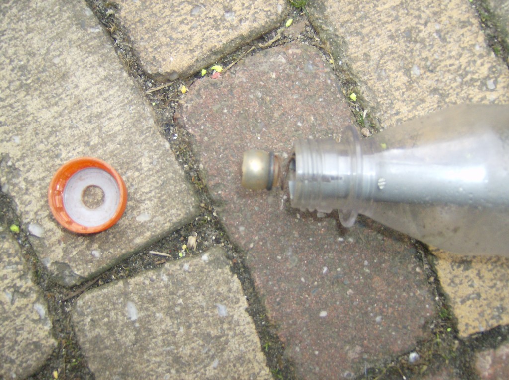

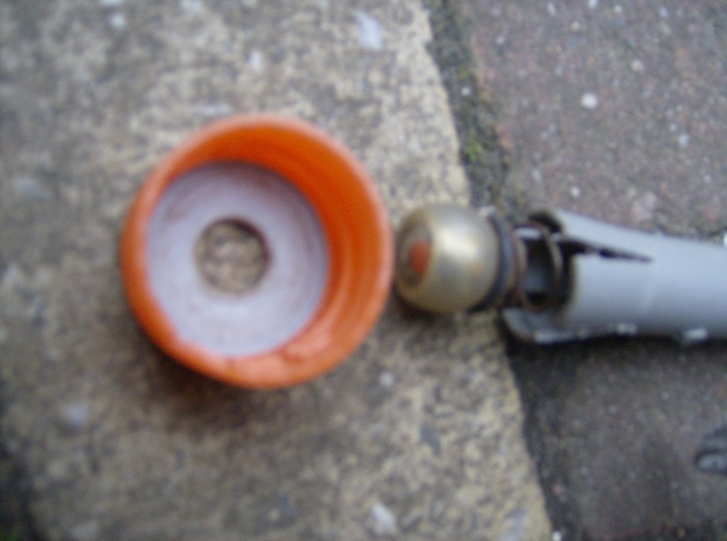

This valve is one of the most simple ones I made.

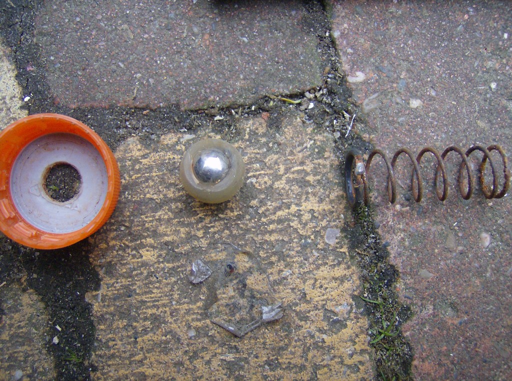

You need:
5cm long spring
pcv pipe the lenght of your pressure bottle (where the spring fits in)
a steel bearing as valve
a small silicon tube to put over the bearing
a barrel pipe
a pipe that fits over the barrel
some wood

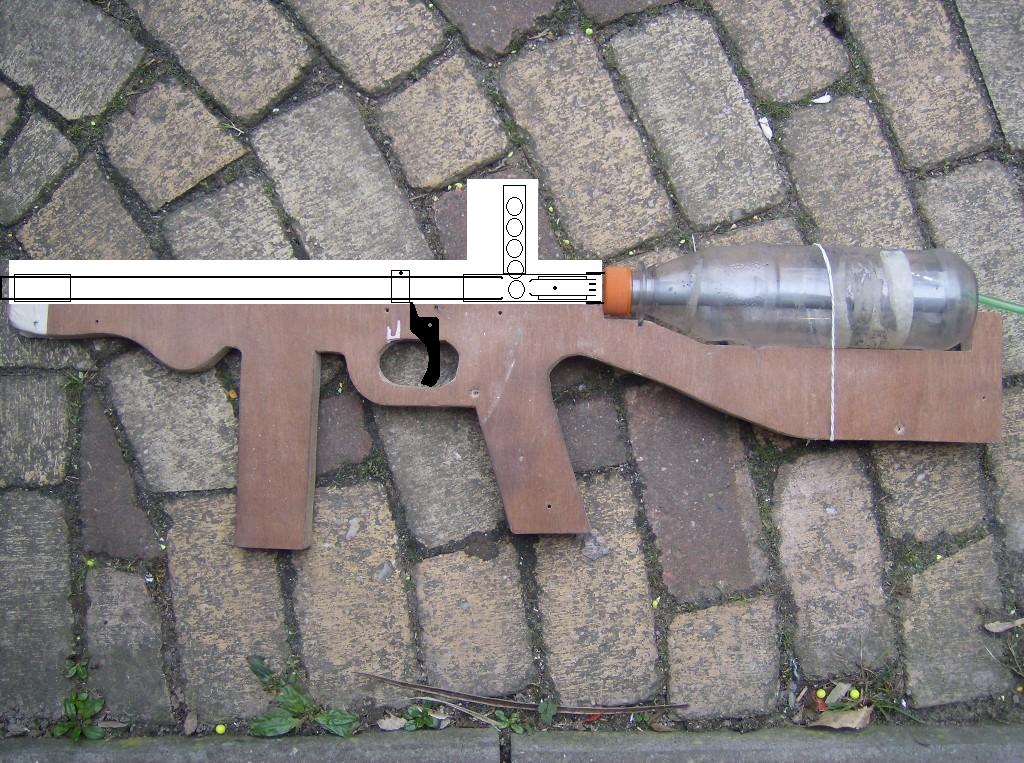

In this gun the bottle and the valve are inline with the barrel. This makes it hard to aim, but gives you a very simpel and working airgun. It shoots around 250-300ft/s. In this case the barrel is the hammer again (like in my other project, but in this case the valve is inside the pressure bottle which makes an easy seal.
In the pictures I havent shown the barrel and its pipping as I used it for other guns. But its really startforward; the barrel is cocked forward a ball falls in the barrel, when the trigger is pulled the loading port closes as the barrel slides backwards as it hits the valve.

Sketch with barrel and trigger as it used to be

Btw I have a airgun I am working on now and its auto but its cycle rate is way too high to reload. It consists of my hammer/barrel airgun with two pipes above each other. One is closes and used for recocking and the other one(top) is used as barrel. This thus consists of two valves. Its funny I found this out when my airgun jammed in a bb fight and it started cycling automatic.

I made a valve in the cap of a two-liter PET-bottle. I was wondering how dit you make the connection from the cap from the bottle to the barrel/ feed system? Also quite impressive work!

Tom wrote:@Ant
GR.from the Dutch, Tom
There isnt really a connection between the bottle and the outerbarrel pipe. I just put a rubber tube over that tube and thus it made it seal of; nothing fancy. This outerbarrelpipe is used as slide for the barrel as I did so in my other designs

Can you make a little picrure of the cap and barrel slider? I stil don't get it :D Don't you have any problems with the piston?

Tom wrote:Can you make a little picrure of the cap and barrel slider? I stil don't get it :D Don't you have any problems with the piston?
Greeetings from the Dutch, Tom
Check my P. 4 the barrel system works the same way. As I said I took the gun apart so I can make more pictures. Btw this gun doesnt have a piston, I am not sure what u mean by that. The valve(ball) is hit opened by the barrel and is closed again by the airpressure and the spring behind it.
I made a diagram on the original picture. Just check that out, hope it works out.
