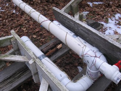

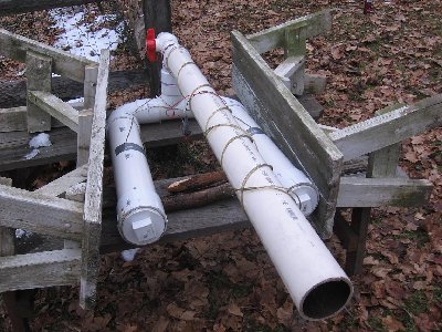

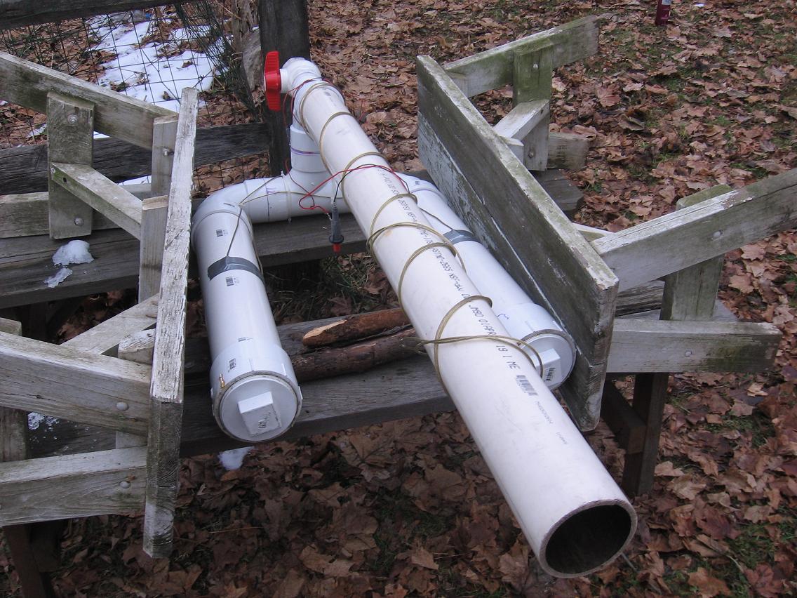

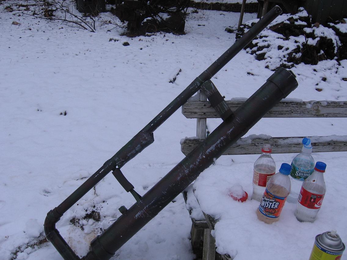

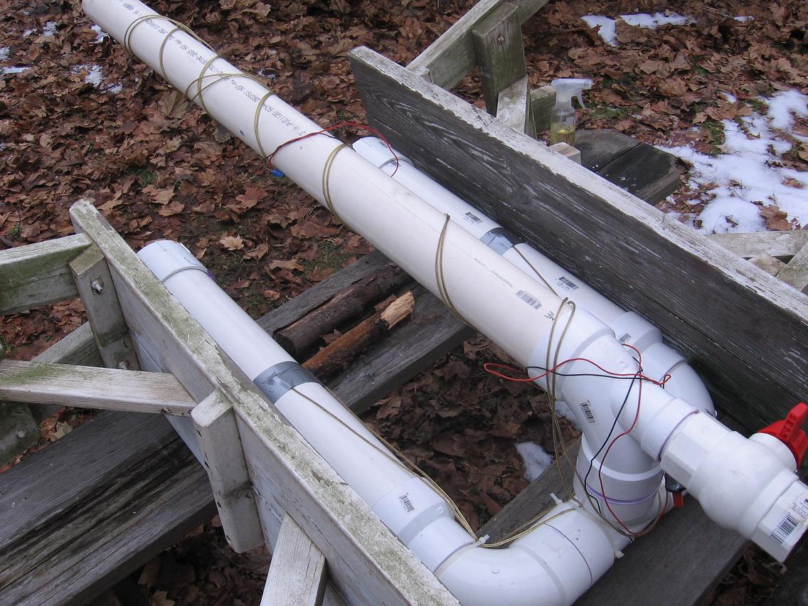

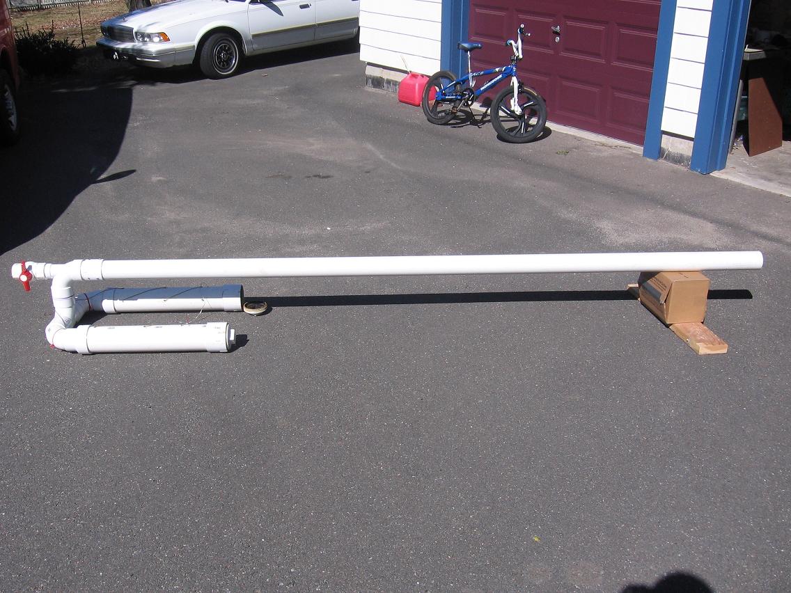

Hehe I'm a new member but would it be too much too ask for some feedback on my cannons? There kind big. "Go big or go home" as they say.
STATISTICS
THE "SARGE"
The barrel on the "Sarge" is 1.5 in. in diameter and the length is 5 ft. The chamber on the "Sarge" is 4 in. in diameter and about 4 in. short of 5 ft. in length. I'm thinking about using a dual gap on it in the near future.
THE OLD "GENERAL"

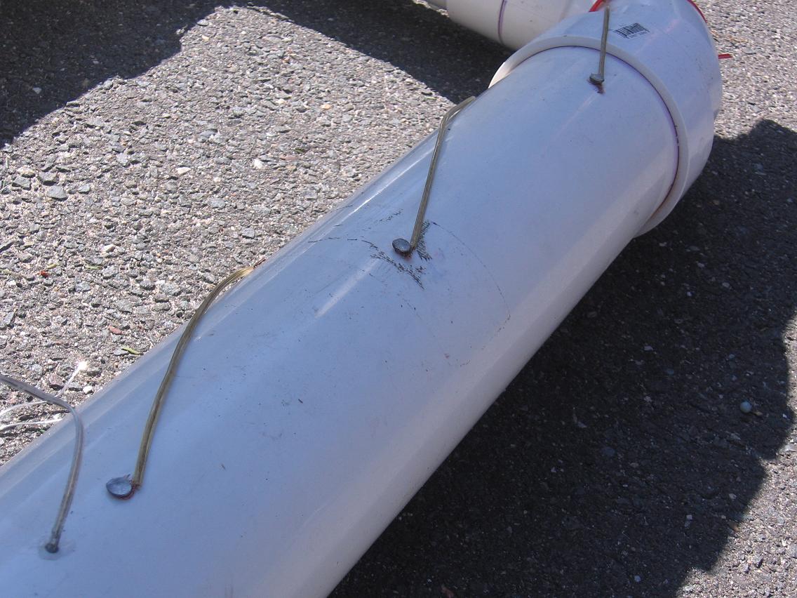

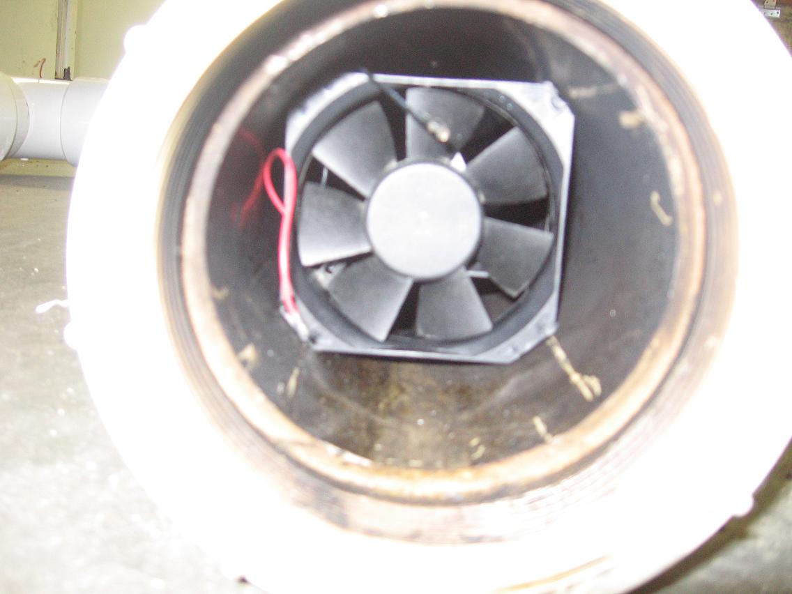

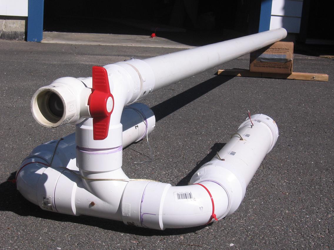

The "General" is a monster with two 4in. chambers at 3 ft in length with a spark gap in each chamber. The barrel on the "General" is a whopping 3 in. in diameter and about 5 ft. in length. The "General" is a variant of the cannon designed for the U.S. Department of Agriculture on Spudtech.com. It Uses a power limiter valve (that i don't often use). There is a 7-8ft distance between the sparker and the cannon itself when firing.
THE NEW "GENERAL"
The monster of Connecticut has grown even more! In it's development it has grown a 10ft barrel, 4 new spark gaps for a total of 6, 2 new chamber fans, and an ignition coil firing system.
STATISTICS
THE "SARGE"
THE OLD "GENERAL"
THE NEW "GENERAL"

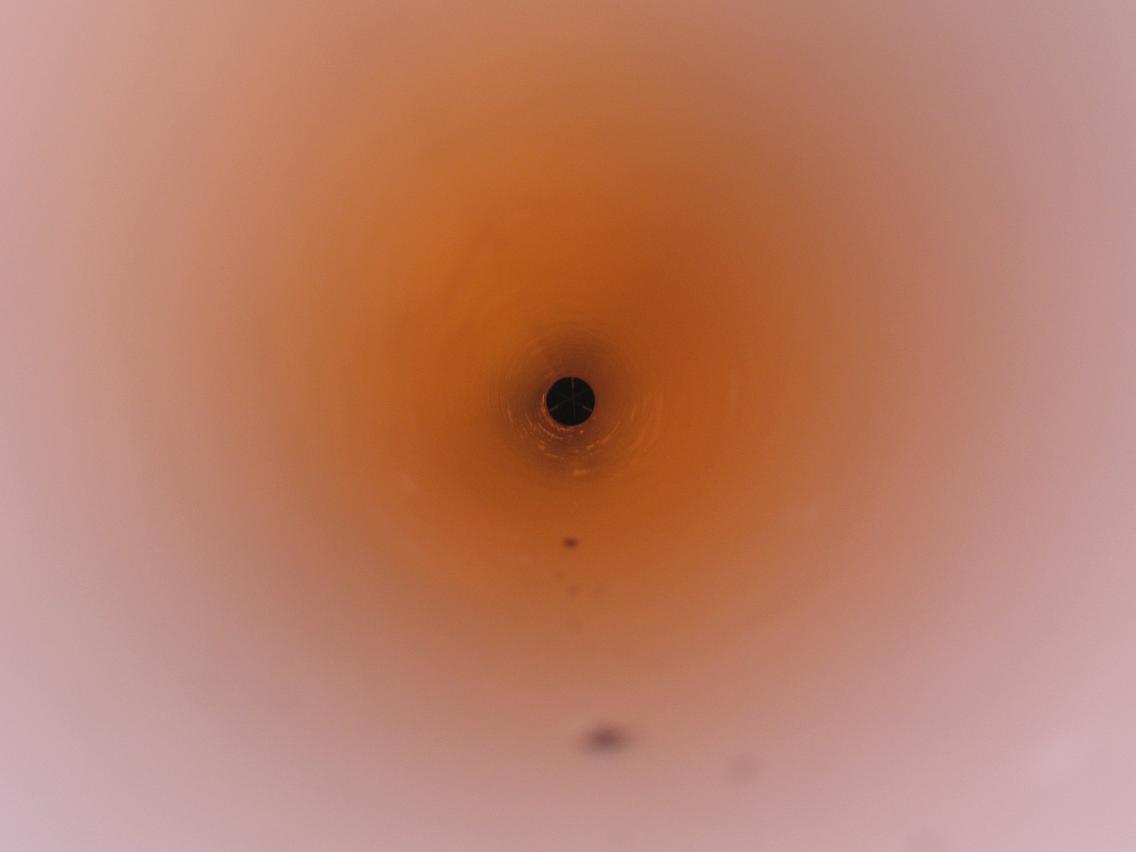

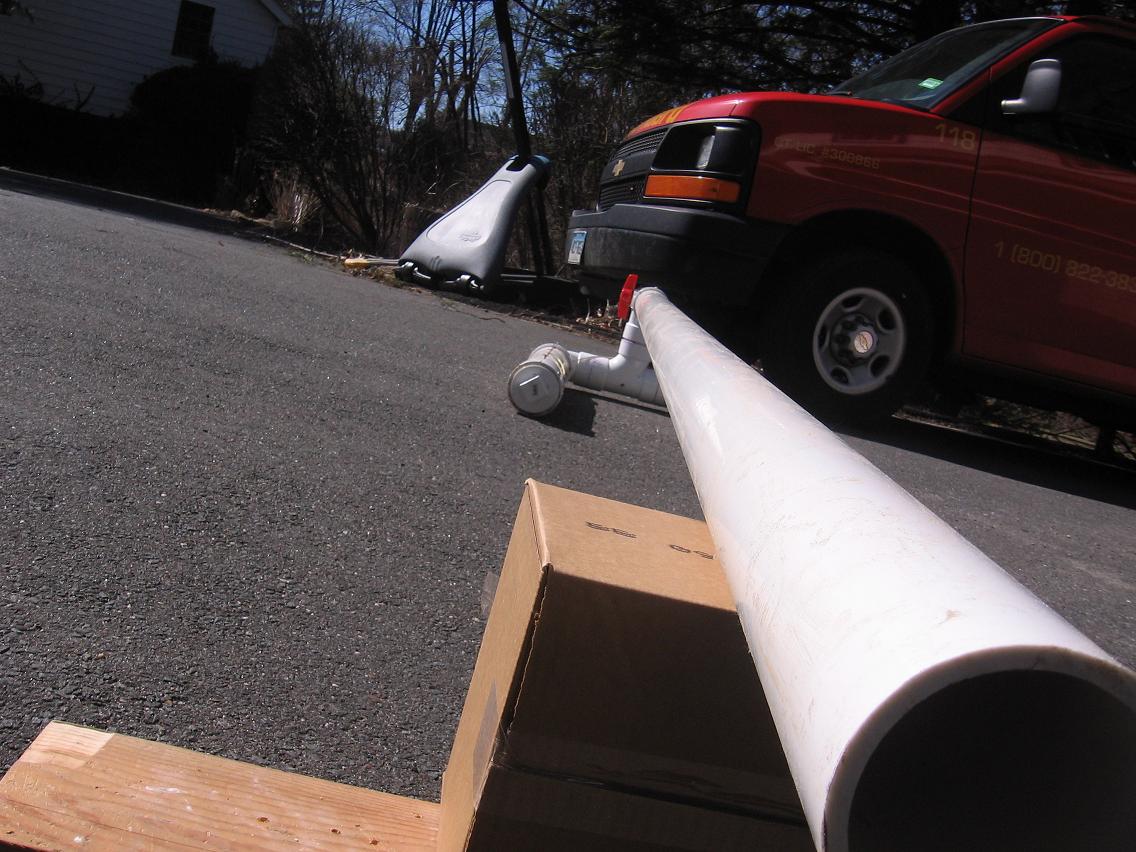

- Looking down the barrel
- Muzzle.jpg (31.65 KiB) Viewed 7513 times

What do you use for fuel in this monster?

wow 5 minutes after i post. Anyway, i use injected gasoline. It always seems to work the best. Even better than hairspray. Get a two dollar spray bottle and fill it with gas. It works the best if the walls are sprayed with gas and then let to run down the sides of the chamber. This increases the surface area in which the fuel has to evaporate. This loading technique doesn't only apply with gas though.

Interesting fuel choice. You don't have to worry about overfueling with gasoline, as it doesn't contain its own oxidiser and is thus limited by the levels of oxidiser available in the chamber. The "Sarge" would be more effective with a smaller chamber, and both could benefit from an inline design. However, the most effective (and cost effective) method of increasing a basic combustion's performance is to add a chamber fan, creating turbulence and enhancing burn rate.
And what's the ball valve on the back of the General for? I wouldn't call these things monsters, as they could easily be handheld. The 3" barrel is a rather uncommon feature on combustions, as it makes finding ammunition a bit more difficult. If you can put enough power behind it however, 3" is actually a very good barrel size.
