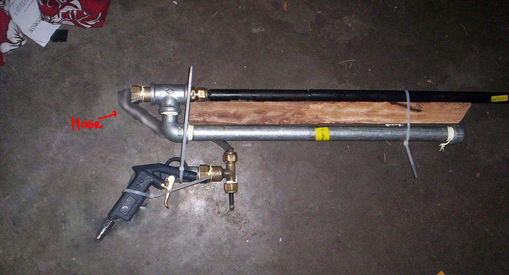

Here are the pics of my rifle. I still dont fully understand how to make a piston inside of it, i used a small piece of pipe with rubber either end, but it didnt seal the barrel? i used an o ring on it also. What did i do incorrect?
Necrosis
Posts: 239
Joined: Tue Jul 03, 2007 10:03 am
Fri Jan 25, 2008 8:07 am
I think it will be safe to say that the pilot volume is a little to much (from what I can see it's bigger than the actual chamber, lol).

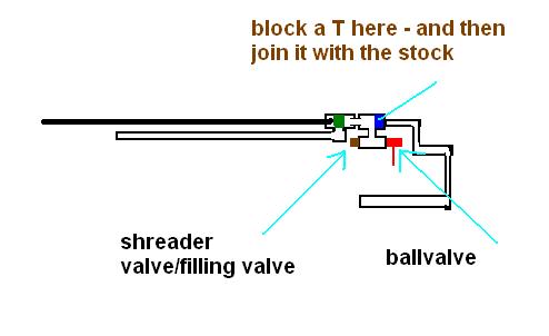

first of all i don't know much about piston valves - I've never build one.... but there are some things obviouse here:
1. your pilot volume is enourmous - you have to make it as small as possible... acctually you should put/thread/join that brass filling/piloting T directly to the piston T.....
2. a blowgun has very limited flow - use ballvalve or something else
3. keep your stock as it is - but don't use it as pilot volume or chamber... it should be just a thing build out of pipes and fittings - not holding any pressure inside....
anyway it is good to know that there are more people out there who build full metal spudguns
here a pic with my suggestions - sometimes it is better to show something using a picture

Fri Jan 25, 2008 5:08 pm
Yeah i gatherd the pilot volume was just a *Little* to big :P
Loke the photo shop work also:P
And yeah i was thinking last night if getting a plug so i can still use the stock, on the other hand i might just make it out of wood or something because this thing is damn heavy :P

Fri Jan 25, 2008 6:01 pm
You had better get rid of those pictures quickly. If JSR sees them, his brain will explode.
Everyone else has given you the right answer, just decrease the pilot volume by about 100x, and it should work better. I really have never seen a pilot volume anywhere near that size before.

Fri Jan 25, 2008 6:37 pm
you could cut that pipe between the filling/piloting T and the piston T to make it better... idealy that pipe should be as short as possible...

Fri Jan 25, 2008 7:04 pm
Yeah i could cut the pipe but its all threaded fittings, and that was the smalles threded pipe i could get. If i cut it i couldent re-thread it.
