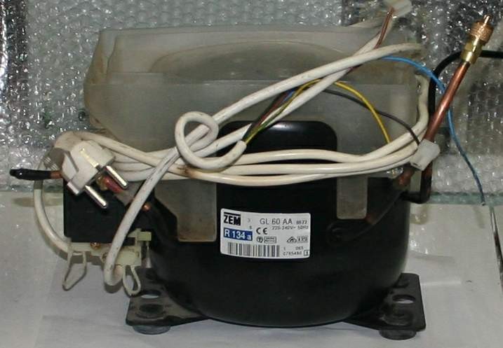

My compressor, 300 psi and more (..... much more :-D )

so sorry to bump, but you said the thing weighed 7kg... Were you being serious or jesting? Would it theoretically be usable in a backpack setup with a storage tank and battery on my back, or is it just too heavy?

hmm a 240v battery...Lentamentalisk wrote:so sorry to bump, but you said the thing weighed 7kg... Were you being serious or jesting? Would it theoretically be usable in a backpack setup with a storage tank and battery on my back, or is it just too heavy?

yeah you need a 220V or 110V battery (depending where you live)
There are different types of these compressors becasue they are used for many appliances.. As a result their dimmensions, weight and flow might vary... you can expect that most fridge/refrigerator compressor have specs more less the same as mine.
there are more powerful compressors as well, for example those used for air conditioning or in shops/stores
I've just read that their air inlet can be used as a suction pump, so it is quite versatile (esspecially usefull for these people --> http://www.spudfiles.com/forums/wrong-s ... 12563.html
some pics showing more of these pumps + one full equiped compressor with a tank, regulator, pressure switch etc. (not mine)...

I got an old fridge today and have succesfully built a 35 bar compressor from it!!I used a 1/4" 3 way bv to fill and bleed.It has a nut on it so it can be mounted on a board.
Conveniently, the compressor has a plate into wich it fits perfectly.All ad-ons are securely mounted.fortunately I had all fittings needed and some hydraulic hoses too.
It looks like hell though, cause of all the rust.
I'll build a box around it, for both protection and looks, tomorrow.I'll post some pics too.
Connecting to the pump was a bit hard, but I solved it by using a piece of rubber hose in an 8mm compression fitting.It holds 35 bar and then I still can't pull it off.
No more ( stirrup) pumping for me!!( although I had just finished one..)
It's even easier to build a compressor like this than it is building a stirrup pump!
Nice and quiet, as he suggested.I totally love this thing!
And yes, the( slow, but sure) 35 bar is now official!I just need to get a switch, so I don't have to unplug it each time.
It will be great for filling my PB tank to 35 bar, to use on the MMG.
Thanks a lot!!

I knew it was capable of 35 Bar but I didn't even have a gauge for pressures above 25 BAR
since you are already building a box for the compressor you might consider cutting a small hole in it for a computer fan - for cooling.
don't forget to add several cubic cm of oil every week or so (if you use it a lot )

an oil mist is slowly being released with compressed air... so it has to be replaced... you just have to add several cubic cm of oil is to the air intake - use small syringe to do it...
you can use mineral oil, engine oil but there is also a special oil for compressors...
you may add an oil filter to the air output (either buy one or make one yourself) - it is up to you... I don't have an oil filter and I haven't noticed any problems with my gun...
you can stop some of the oil in a quite simple way - make sure that at least 15 cm of the air hose that is connected to the compressor is vertical...

normaly it doesn't have to be oiled becasue in fridges freon and a little of oil circulates throught those small pipes.... (oil that escapes the pump through air exhaust returns through the air input)

In the fridge, the oil is contained, any that gets into the freon just recirculates back. It's a closed system.
When using it for an air compressor, a small amount of oil vapour goes out with the air.
Like a car using oil, if you don't add oil from time to time, bad things can, and will happen.
