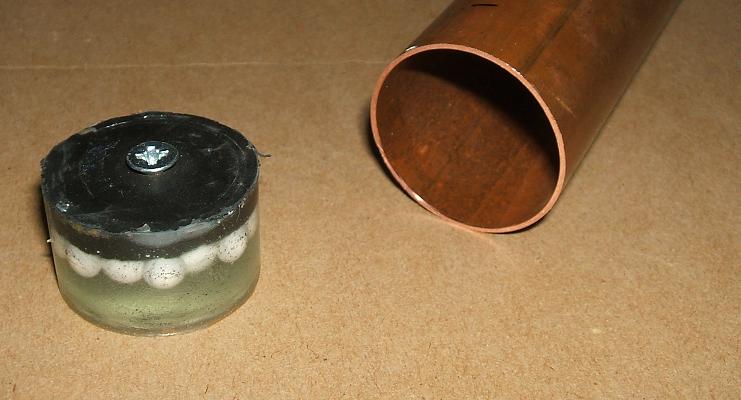

Here's the latest piston I cast for a 3/4" high pressure pneumatic I'm making, inside the copper pipe I'm using as a chamber.
I got a bit creative with the filling, I popped a few airsoft BBs in. It didn't do much for the the weight as they sank in the epoxy so are more dense, maybe 0.12 grams next time ;)
smoothed down and ready to be sealed inside
freshly popped out of the mould, needs some finishing

inonickname wrote:Though I'll admit I was worried for a second that you were considering using PVC in it..good to see you're using something which can take it.
After a certain amount of prototypes blow up one you, one does tend to become a bit careful :P The barrel is PVC but it's 3.5mm wall thickness so no worries there.
Will it be serviceable?
The piston won't be removable, but the pilot will be a 1/2" ball valve and I'll cast it around the thread so that will come off with some effort without destroying it.
