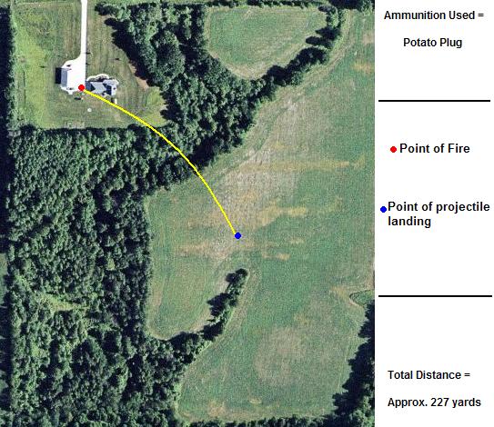

This is the exact shot described/showed in the picture at the bottom of the page. And after seeing the recoil this thing puts off, there's no way I'm shooting it off my shoulder at anything past 25psi (in the video, it was set at 30 psi cause the propane tank was almost empty). You should see it at 60 psi, it flies back probably a foot, even with sand bags
sorry about the poor quality of the video. Last time i use youtube...

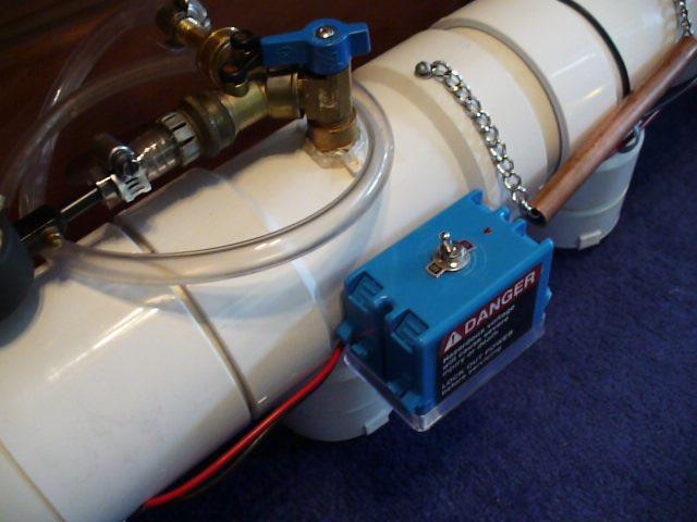

fan power box
fan power box
ignition spark gap (not bad for a piezo)
custom piezo ignition handle (excuse the duct tape, i plan on covering it with shrink wrap, and making a custom handle to encase it all to make it less noticeable).
propane injection system and fan box
homemade propane meter (sorta ghetto).  The calculator said to use 15&amp;quot; long piece of 1/2&amp;quot; pipe at 60 psi, but i used 30&amp;quot; of 1/4&amp;quot; tubing instead and usually keep it at around 45 psi.
homemade propane meter (sorta ghetto). The calculator said to use 15&quot; long piece of 1/2&quot; pipe at 60 psi, but i used 30&quot; of 1/4&quot; tubing instead and usually keep it at around 45 psi.
This was a shot fired on a day with 4mph winds and it was about 38 degrees F.  The video is currently being uploaded.

thanks lol. i got the map from http://www.maps.live.com.

The calculator said to use 15" long piece of 1/2" pipe at 60 psi, but i used 30" of 1/4" tubing instead and usually keep it at around 45 psi.
Those are totally different volumes of propane. The calculator gives a volume of 193 cc, the volume you have is around 72cc.
The different pressures you're throwing around, aren't going to get the best results. There is a perfect fuel ratio of 4.19% propane by volume, and surely you're not actually hitting it.
I'd like to say it's a nice launcher, but I have a gripe with it - I know people will disagree with me on whether this is acceptable - it uses unrated parts.
Combustion or not, unrated parts are not completely safe. You just need to search youtube to see dozens of cannons (combustion, mostly spray n' pray - for which many people will tell you that unrated parts are acceptable for) that have shattered or ruptured from pressure. I'm not saying that it's guaranteed to explode, but I personally wouldn't really want to use it.
The design itself is fine, if with rather interesting proportions and ratios, but I can't give it a real thumbs up because of my safety concerns.
I'm going to sound like an old grump by the time I'm done, but I'm also a little wary of your range measurements. Particularly with a tree line in the way, it would be very hard to actually find where a round actually landed. Would you care to elucidate on the matter?
However, if you're happy with it, that's the main thing, and don't let my ramblings affect how you feel about it.
At the very least, it shouldn't be too hard for you to find that perfect propane mix and get the real power out of it. Just don't stand too close.

sthorne wrote:In the original post, i said
I wrote:I bought all the pvc brand new (yes, it's dwv, i know)
and i know the.."risk" I'm taking using dwv parts but since I'm keeping it at relatively low pressures, I'm not concerned. Most of the people on youtube are idiots and either use way too much, or don't properly prime/cement there fittings.
You seem a little confused. More fuel doesn't equal more power. In fact, too much usually means no power at all. I would assume you knew that, but from your posts, it doesn't quite seem that way.
Your propane cannon is easily capable of more pressure than the cannons people use on Youtube. Often the failures I see on Youtube are not joints blowing apart, but the launcher actually doing an impression of an M67 grenade.
That's no mark of poorly made joints, but of the pipe being over loaded.
