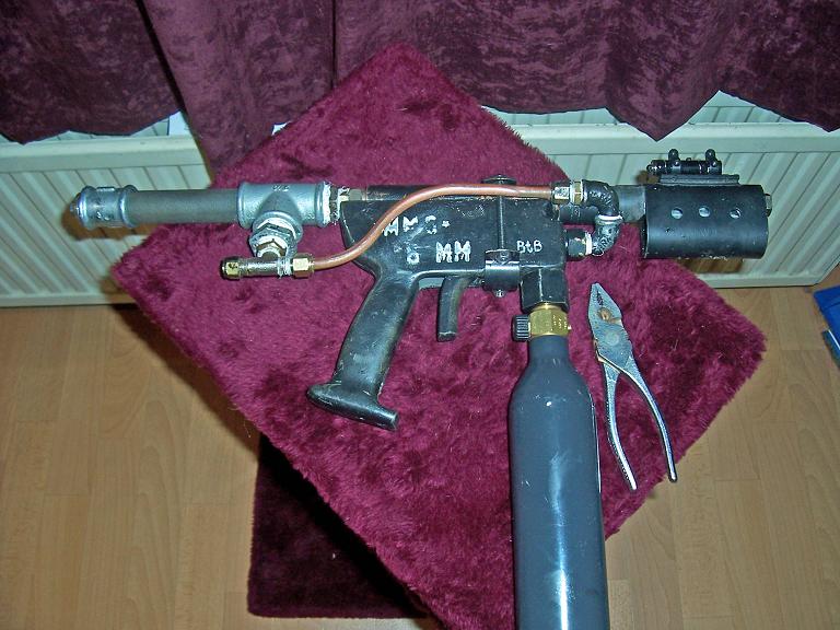

Name: Deathray Machine Pistol, by BTB
Caliber: 6mm
Type: BBMG, ultimate inline
Constr. material: all metal
Max pressure: 900 psi :D Edit: Now it runs off of a 12 gram with the help of a jet adapter!!!
Main valve: pressure washer handle
BB capacity: as of yet unknown..
ROF : extreme, as far as I can tell
Well...after all the failures, trying to create an autovalved machinegun, I decided to build something that would work... :D
This short machine pistol uses the Ultimate Inline principle.
I've shot it at 35 bar and my heart is still pounding like crazy.
EDIT: unregged CO2 is even worse!!
The short design doesn't mean it's weak at all!
It cut up a can in a split scond and all I found was split bb's as if they were peas! :shock: :shock:
This thing could cut your hand off!!
So much for air-soft.
I used the pressure from my fridge compressor, but it would work just as well off of unregged CO2...Wish I had a suited barrel in .177....muhahaha

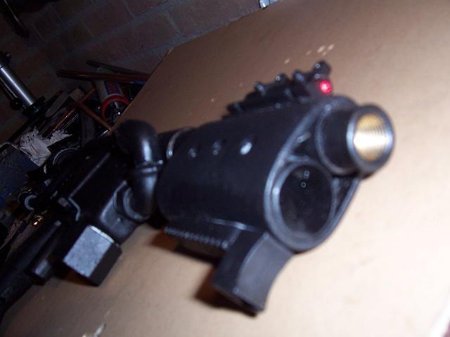

Nasty little bugger....The Tee is where the action is.Vortex block consists of a reshaped 12 mm elbow, tapped to 1/4&amp;quot;to accept the treaded barrel. Barrel is smoothbore, but an absolute PERFECT fit for 6mm bb's.<br />This thing runs on pure aggression!!
Nasty little bugger....The Tee is where the action is.Vortex block consists of a reshaped 12 mm elbow, tapped to 1/4&quot;to accept the treaded barrel. Barrel is smoothbore, but an absolute PERFECT fit for 6mm bb's.

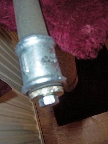

Fill-plug wich can be unscrewed by hand.Works perfectly!

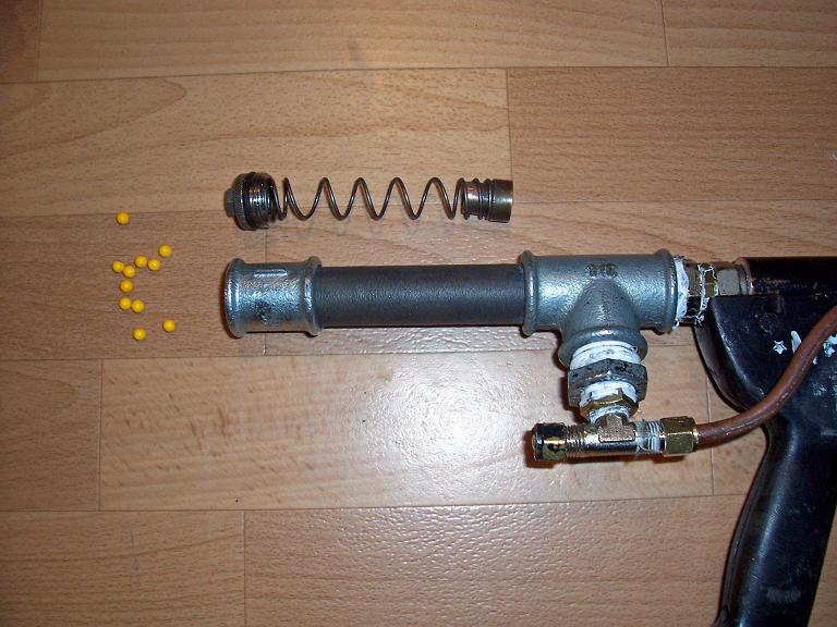

Ultimate inline, as you can see.Piston is a perfect fit, though not sealing.
Look from the front.Notice the lasersight..hehehe.<br />The nozzle is threaded to 3/8 to later attach a silencer.<br />I love the &amp;quot;SWAT&amp;quot; look...
I love the &quot;SWAT&quot; look...

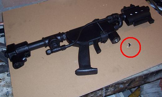

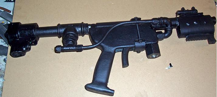

Now with flat black paintjob and buttplate added.I also reglued a decorative piece back on at the frontgrip.It should keep my hand from ever slipping in front of the nozzle
It pierced thin MDF board even after I had lost a lot of pressure to a JAM...Grrrr!! One bb was somehow bigger than all the others, as it was perfectly round, but still jammed.I had to take the gun apart to fix it.While doing so I also filled up the bottom of the Tee to get better action.The bb's dropped to far before.

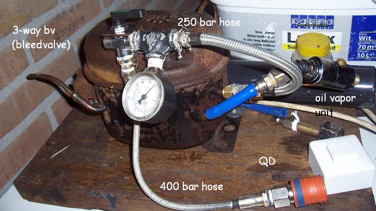

Here is my compressor I made (thanks to POLANDSPUD)

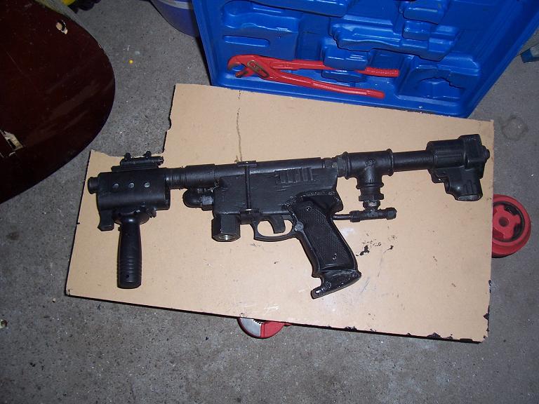

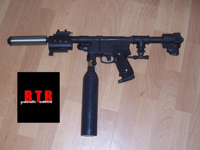

Finished look.<br />I might add a silencer later.<br />The laser sight helps a lot.Without it I could not hit a thing with the short design and all...
Finished look.

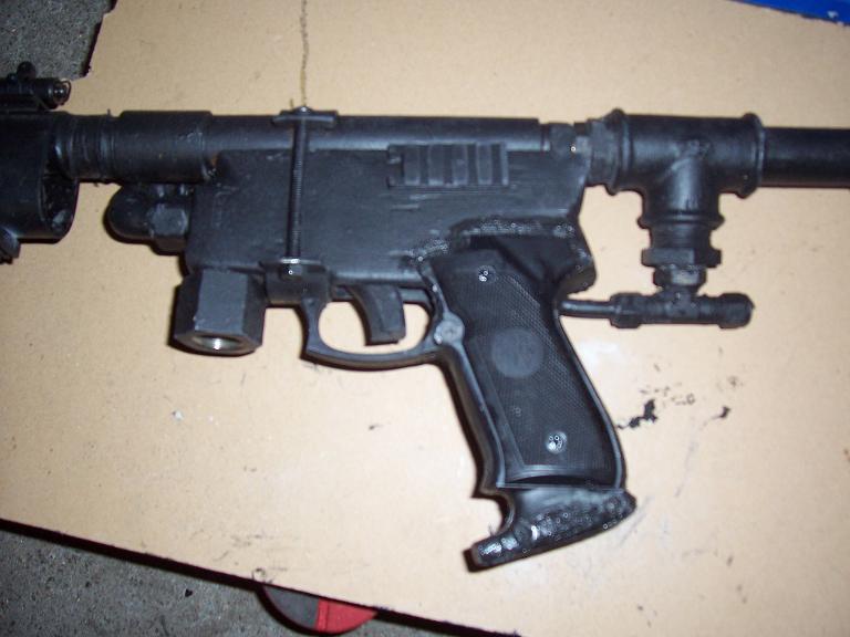

beretta airsoft pistol grip, filed to fit and filled with solid epoxy putty.<br />It's a completely solid grip now.

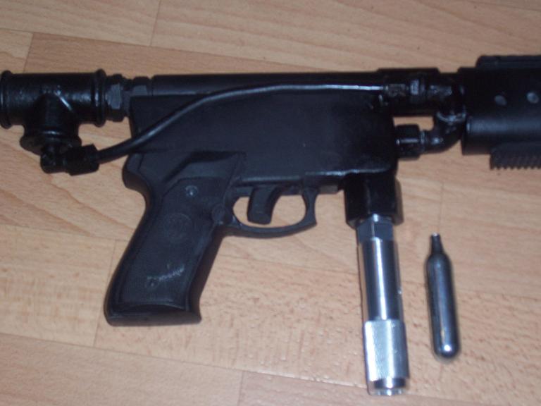

With stainless steel funcional suppressor.Threads right in by hand.

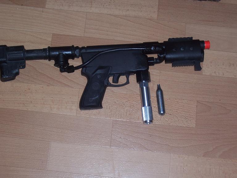

Yup...A 12 gram jet adapter.Even though the  flow is really small, it fires like CRAZY!<br />This is because the pressure washer is spewing out LIQUID CO2!!<br /><br />It fires for about 3-4 seconds off of a 12 gram.That is a lot of bb's and a lot of power.Whatever it hits gets pounded to submission.
Close up.I cleaned it up a bit.The part where the pressure line enters the T has been cut down to the minimum.
