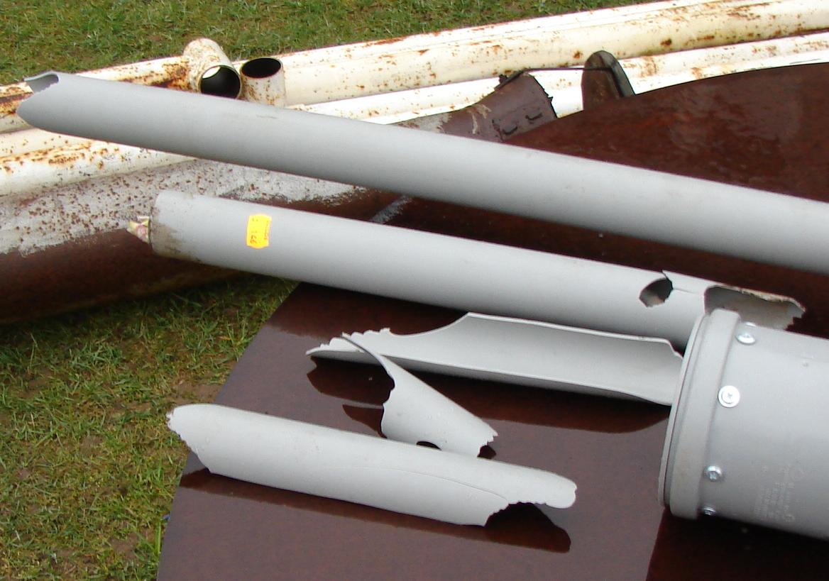

I know ! In a moment it was like - sh*t what just happen? I am lucky .... My good friend was there too and he start laughing ....

it's just a suggestion but you should consider switching to pneuamtics and metal - much easier to get in europe than PVC and much better than PVC as far as safty, pressures and coolness is concerned
try using steel pipes and steel fittings (they are often called malleable iron fittings here on spudfiles but I suppose they are simply called galvanised steel fittings in latvia)

yeah I think switching to steel is the best thing you can do grizzli - steel pipes and fittings are much easier to get and cheaper than PVC... acctually when I wrote my first post I didn't notice your post about your cannon failure... you had your first lesson
try building a basic steel pneumatic. you can use a ball valve for your first gun because it easier to build.

I'm ignorant of PVC in that part of the world, but that barrel doesn't look anything like the pressure rated sched 40 stuff we use routinely in the US, particularly in wall thickness...way thin. Cold weather didn't help you any either.
I agree with Poland, if you can't get better quailty PVC, build out of metal.

2. The metal fittings are cheaper than PVC ? - I dont thin so ! however I have lot of them in workshop but cheaper - no way !
3. i think the PVC definitely is not pressure rated because we use them for sewerage net !
4. I have some ideas about pneumatic but this is my combustion gun... i want to upgrade it not throw away...
5. can someone PM some good ideas about pneumatic guns from those metal fittings....

2. & 3. metal is cheaper than pressure rated PVC. I think you already know that using non pressure rated PVC is asking for troubles despite the fact that some people say its ok for combustion launchers...
steel pipes and fittings are really cheap becasue you can use the same parts to build several guns or to upgrade them
4 & 5 the simplest design can be build using two pipes, one ball valve and a quick connect fitting (male and female) or a car tire valve. obviously you need some pump or compressor but for the very begining a foot pump would suffice
