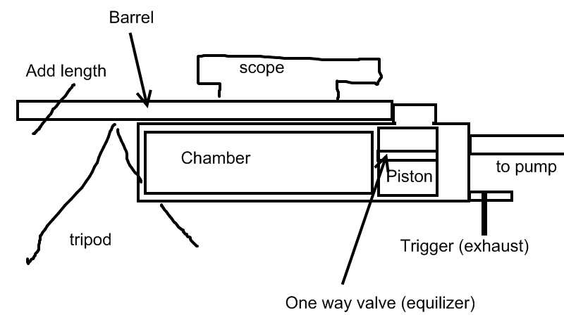

I have a feeling I won't be satisfied if I don't make a piston, even if my first try isn't up to par.
EDIT: I added a pic of a simple design of a piston, which I don't see too much difficulty in making.
My design
My design

That is known as a chamber sealing valve. It will require an o-ring on the piston to seal properly. Otherwise air will leak from the exhaust area (pilot) into the barrel.
Barrel sealing valves don't require o-rings so they are typically preferred by new builders.
This may help if you haven't seen it yet
http://www.spudfiles.com/forums/piston- ... t8157.html
