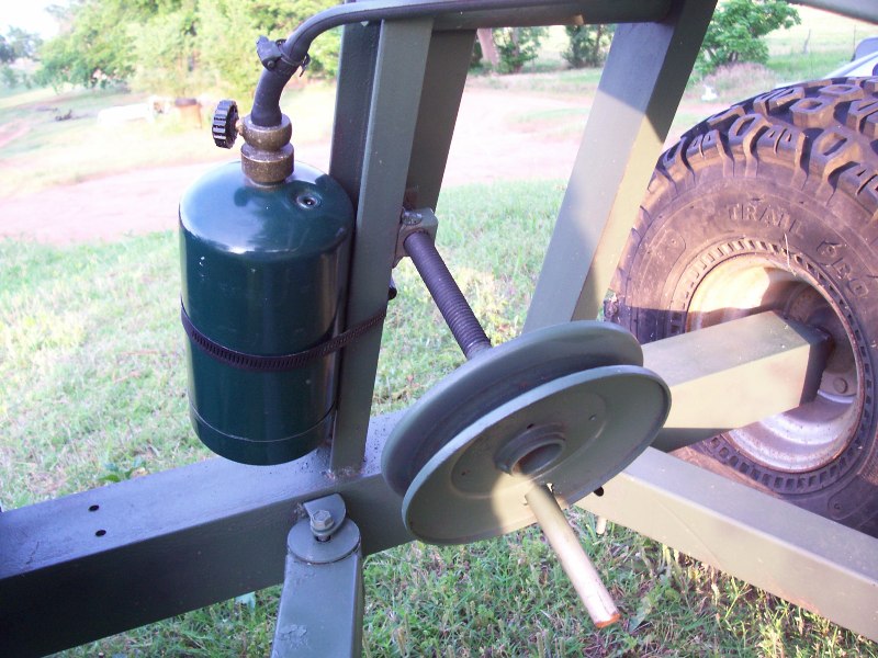

Bigfoot Howitzer
4 inch chamber - 20 inches long
3 inch barrel - 5 foot long
"phat" propane meter - 1.5 " caps
pc fan
3 wheeler tires
welded carriage
I have found a fuel mix that is very powerful. a couple squirts of starting fluid and a few squirts of hairspray really makes for a powerful bang.
UPDATE #2: i added the electric bbq ignitor and a spark strip with double sparks using small bolts. this and the fan really improves the power. added a battle shield and camo paint.
UPDATE: propane sucks with this canon for some reason, i found out that solarcaine first aid spray works best , then disinfectant spray works real good so i dont use propane anymore on this gun. it shot a baseball 660 feet with solarcaine. in the vid u will see a baseball go through 1/4" plywood then travel another 159 feet at its lowest elevation setting.
Also the C:B ratio is less than 1 to 1 so to get the pressure up in the chamber and to simulate a 2" barrel i added a plywood baffle inside the chamber up against the barrel, the baffle has a 2" hole and this greatly improved the power.

now... that's great I really like the way it looks... well maybe its not a real howitzer but it looks as if it was.. that green military paint suits it
the recoil rocks it a little but i built it mostly for style.

I like the fat tires and the attitude of the whole thing...great paint job! The elevation control is awesome...(I think that's what that pulley and handle is anyway)
