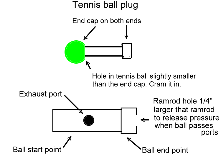

Independence Day is coming soon so I made a barrel attachment that uses a tennis ball as a burst disk without actually shooting the tennis ball. I have too many houses around me to actually fire anything in my neighborhood.
Once the tennis ball passes the two exhaust ports, it is stopped with an end cap. a ramrod is permanently attached to the tennis ball and is guided out of a hole in the end of the cap.
This should make for rapid reloading and firing. The pressure created by the tennis ball should make a nice loud BANG! Hmm...wonder what my C:B ratio is on this thing. :D
After I fire it tonight, I'll assess whether the exhaust ports need deflecting.

UPDATE: Two more exhaust ports were added for a total of 4. Much louder now. :lol:

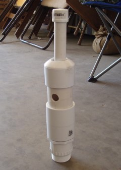

plunger up
plunger up
noise maker2.jpg (31.18 KiB) Viewed 4478 times

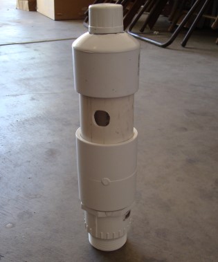

plunger down
plunger down
noise maker1.jpg (33.71 KiB) Viewed 4478 times

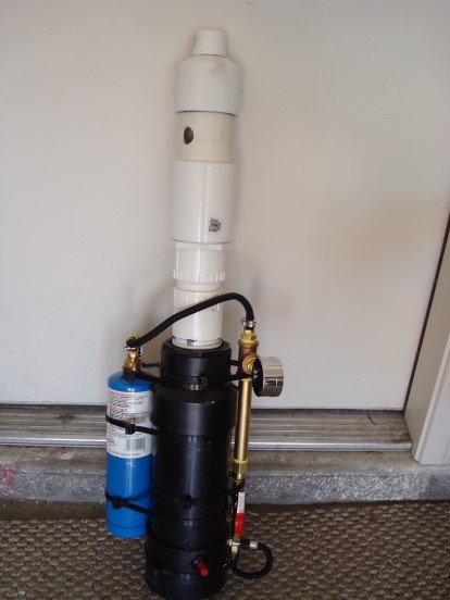

Here is is attached to the chamber
plug is permanently attached so measure many times before gluing it together. An end cap is on both ends of the ramrod.

I just fired it. DAMN, this thing is much louder that the 1.5" potato barrel!
I made the port area equal to about the area of a 1.5" barrel. I love it! The tennis ball capture was perfect, also.
The rod doesn't hit the end cap. The tennis ball takes the blow. Since the tennis ball has only 1" to gain speed, it barely reaches the end cap.

wow! very good thinking. You're using ammo, without actually using it...I LOVE IT!!!
For those who don't understand, could you post a diagram showing the internals?
Again, very nice work.

I added 2 more ports for about 4" square area of holes. I'll do a bang comparison later tonight. I decided not to to with the tee for asthetic reasons.
I'll try for a good video at night of it.
Jeff
EDIT: Those extra ports were exactly what it needed. The tennis ball clears the ports and hasn't even hit the end cap. The "boom" is obviously louder. It's a different sound but its very loud. This works great, now.
