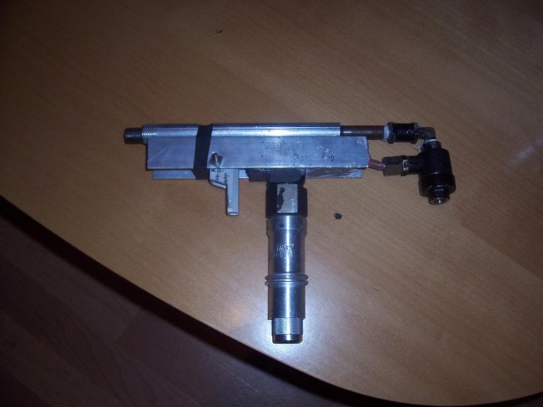

Jep...I did it again!
Still needs to be refined lookswise, but I managed to pull it off.
An unregged mini-UZI running on a 12 gram.
For this I had to hack up "Deathray"and use just the pressure washer valve.
I reversed the trigger so the 12 gram can act like the handle.
Put a cover over that, while the 12 gram can still be changed out, leaving just the cover in place.( get that?)
I used a 1/4"QEv body, without the piston that is, as the vortex chamber.
I guess Takerlabs would call it a sweepchamber.
The intake is NOT coming in from the bottom, but the vortex chamber works better than anything I've tried before!
And it was ready made, just had to plug the bottom with a disc.
It has an actual airgun -rifled- .177 barrel, wich I, against my habit, sawed-off.. :D
I fired it once and was pretty impressed ( out of 12 grams a.t.m.)
Eventhough it is close to freezing temperatures outside ( making the CO2 lose a lot of power) it managed to just about split a lead .177 bb when it hit a solid piece of brass. :shock:
It penetrates wood..hmm..
Not bad considering it is about the size of a real "Ingram"mini UZI.
Trust me...I know first hand. 8)
The QEV body holds a little more bb's than the 12 gram could spit out.
THe temperature could be a factor there.'
You guys should have quite a few questions so , just ask and you shall recieve...( no, you can't ask for the gun!)
On with the pics: Remember, this is just a prototype thing and I'll make it look like candy with some epoxy and a nice flat black paintjob later. :wink:
Edit:Finished picture below: ( still want to change the trigger guard, paint is still drying in the picture)
A bit unclear, but you can just make out its a split lead .177 bb.<br />That means it's powerfull folks!
And this is the little bugger.Performance is better than my Anics CO2 storebought pistol.Lot faster too!
I used some old paint, so it needs to be redone, but you get the picture.<br />That thing took a lot of epoxy and a lot of sanding!

Well it is not exactly a beatuy, but looks like it has some promise. Could you take another pic of it with something for size reference? Maybe somewhere on your to-do list could be to make clips for it, consisting of a little pipe, with some sort of punctureable disk that just screws into the QEV or something like that.
I am rather confused as to how you used a QEV for a vortex chamber. Mind explaining that in more detail? Maybe a drawing or two?
edit: I forgot to say, FORKING AWESOME!
Netherlands
Posts: 3497
Wed Jan 14, 2009 5:34 pm
It's the size of an actual pistol, with some sticking out the back end.
I won;t be making clips.I could just wrap the required amount of bb's in paper and tear that open when I fill.Just like they did muzzle loading buckshot.
The bb's roll onto the bottom ( pilot port side) of the QEV.
The outport is right above the center.The bbs get sucked up and out the elbow above.'
It is something I found out over 5 years ago.
In a ballvalve cannon, I used a tee with a smaller diameter barrel on one side, almost the entire way in.This way I could load from the oposite side and close up that side with a cap.My first attempt at breech loading.
THe pressure came in from the bottom of that Tee.
One day I threw a couple of bb;s into the Tee and fired.They all came out.
They just followed the airstream.
For the Pnuzi I just turned the principle up 90 degrees.

Netherlands
Posts: 3497
Wed Jan 14, 2009 5:48 pm
I'm Dutch. Over here .177 ( or 4.5 mm) lead bb's are common.
It's actually harder for me to get the steel ones.
plenty of power...
I think you and I have a difference of opinion on what that actually means..
You try and split a bb like that at 100 psi, with just over half a foot of barrel. :D
I see no reason to reg it, it would just mean more parts.
About it not being a beauty: I decided to post it right after testing it.
It's nowhere near finished.

Yessir! With a little more body work, this could be mistaken for an UZI. Very nice (again). BTW, is this using your new valve, or is it just a vortex design like you had on the Deathray? I was a bit confused with reading the first post.
